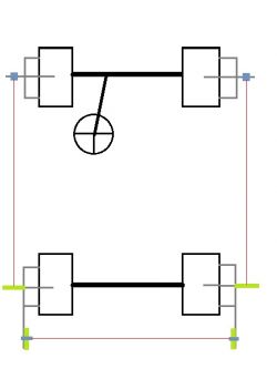

    And here is a makeshift device design modeled on existing ones.
    Blue and red are lasers, and green are appropriate screens with graduations in mm
    Added after 3 [minutes]:
    Parallel wheels of e.g. the left front wheel and the rear left wheel?

    How do you mount the lasers so that they are so accurate that you can set the convergence in tolerance?
    This is almost impossible. At home.
