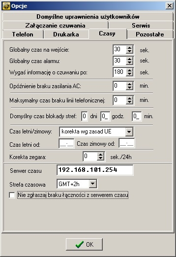

    In the time options I entered the address of the local NTP server from which I use on other computers.
    INTEGRA 128 Time Server Sync Issue: Local NTP Server Address, Livebox DHCP & Troubleshooting
    Unfortunately, the control panel does not synchronize.
    In the log, he gets this message:
    I will add that the time server is an ordinary livebox from which the control panel takes the address from DHCP without any problems.
    Does anyone have any idea what this could be?
    best regards

    Did you just try to enter a time server as the GUM IP address? So e.g. 194,146,251,100.

    yes this server is working i don't know why lifebox doesn't work with ethm-1 ...
    can you tell me what time zone settings do you have? I'm in an hour's hurry ... I'll have to give a gmt-1

    Why -1? After all, in Poland the time zone is GMT + 1. Livebox is blocking something along the way?

    a replacement but equally effective solution was to change the NTP server address and change the time modification settings to gmt + 1
    Thank you for your help :)
