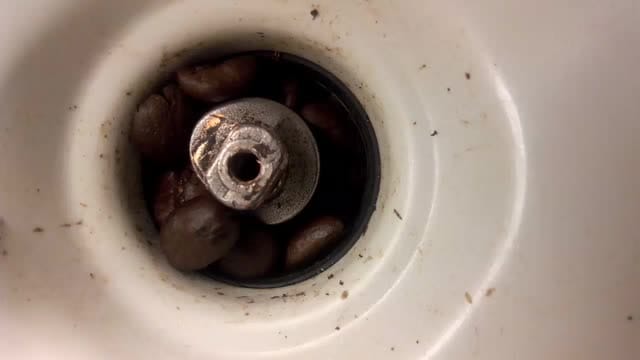

    Hello, I have a Saeco Minuto HD8763 coffee machine from which instead of coffee water is pouring...????
    The beans are in the container, but instead of the traditional grinding sound, there is a sort of squeaking sound...there is not that specific sound of coffee being ground. I unscrewed the "cap/grinder" that is screwed onto the grinder and I can see that it physically spins but does not push the coffee into the coffee brewing block as the grounds container is empty after the whole process. I can see that the coffee brewing block is working.
    I am uploading a video.

  • #9 17188025
    patrykkkkp
    Posts: 29
    Rate: 42
    Hello, it's dry. A little moisture / drops under the lid of the coffee machine which I remove to reach the grinder.
    What grinds the grinder, and there is very little of it, will not even be stuffed into the brewing block.
    I am sending photos.

  • #11 17201813
    leotdipl
    Posts: 499
    Help: 51
    Rate: 153
    patrykkkkp wrote:
    nioop wrote:
    What about a dry grinder inside? Ceramic at an inch?
    Yes, all inside, I send pics ...
    Since all the heat, I did not notice the water in the grinder ... where else to look for the reason that ground coffee does not appear in the coffee brewing block and the grounds do not fall into the grounds container ??? ...
    my friend,
    I'm there in the 2nd picture I see " folded flap " ground coffee outlet! Why
    is it bent? => Outlet blocked !? RATE yourself - you see best because On-Line.
    The grinder is as simple as a hammer. If this clue is false, then you have to
    undress everything. Before that, you need to clean everything from coffee. Use a vacuum cleaner
    a thin screwdriver. You must also disassemble the bottom burner.
