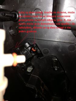

    Hello dear users, I have a Saeco minuto HD8763 machine prod. Romania, used for about 3-4 years from new. The machine has never made coffee on tap water or mineral water, ALWAYS on demineralized water from the RO filter. Coffee from it on such water has a unique taste and aroma without foreign smells. The water in the electric kettle after six months of use will not leave even a minimal scale of limescale. Descaling machine cyclically according to of the included factory program (reminder).
    Problem: a few weeks ago, coffee stopped flowing in the proper stream for this device.
    1. At the beginning it flew similarly to the news, but the stream from one outlet was smaller, then it dripped, it did not fly.
    2. Two weeks later, coffee began to run late after water was fed into the pressurized tank. There was more water in the tray, liquid with coffee, and after making coffee, which no longer flowed into the fixed 3/4 cup but halfway, the liquid dripped from the nozzles for about 1 minute.
    3. Not much thought, having some manual skills, I started the coffee machine and the brewing cartridge, after descaling it, I cleaned everything very well and thoroughly.
    4. Re-attempt and unfortunately the same (maybe it flew a little better). I noticed later that the coffee was not so much flowing from the two-way spout as it was still flowing in front of the spout (it was interesting).
    5. Having a similar coffee machine at home with the same brewing group, I put it into the faulty Saeco minuto and started the coffee. It also flew poorly, so I ruled out a failure related to the cartridge, i.e. the brewing block.
    6. I thought hmm, as if the cause was at the nozzle, maybe clogged? I opened it, cleaned it, it was clean and free, so unfortunately that's not it.
    Insights

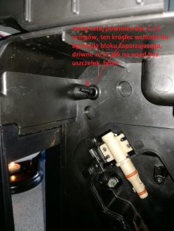

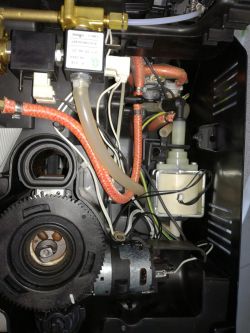

    I took some photos and I am attaching. I marked the important points with red points, and my doubts and observations after analyzing the device from the inside are as follows:
    The 1st espresso machine seems unobstructed, it would be rather impossible to scale the device with the water that I use, even if I did not stone the coffee maker.
    2. I get the impression that the coffee is starting to fly as if it is falling somewhere underneath into the trays in the front by the nozzles behind the front wall, or something with a seal? but not on the block because I was checking another block that works fine. Water in a separate tea nozzle or milk frothing and steam fly very well.
    I am asking for advice as to what the problem may be because maybe one of you had the same problem. Classically, it looks like clogging, limescale, but it seems that there is a failure of a different nature. The pump works as it should, the hoses are all in place.
    If I fail to diagnose the problem, unfortunately, the service remains. The warranty has already expired.

    Start with the simplest - descaling maker. The water from the filters is not perfectly clean, (ie it is not completely devoid of minerals), because if you drink it like that, you would not be alive for a long time.
    In addition, disassemble the spout and clean it, as the coffee flies sideways.

    I do not insist but it may be a microcrack in a block, usually in the area of a scoop of hot coffee, I had it, I can not see it with my naked eye, but with the high pressure, most of the coffee escapes to the stand.

    arekb81 read and understand before giving your answer. I wrote that the machine was decalcified and it certainly is not a matter of stone, not only due to the repeated process of descaling but also water, which almost does not have minerals. In addition, I also wrote that I cleaned everything from A to Z. The spout was also cleaned. Advice for advice alone is not worth much.
    kotuniunia, thanks for the answer, in fact it is a possibility, and I thought about it yesterday. Only my question is how to check it while working on the open flap? the program will not automatically turn on if the cover is open. I greet you

    I check this by pressing the brewing mechanism in the right position under high pressure from a small syringe. All the outlets must be plugged. There is a water leak in the gap, and the brewing valve is really open at high pressure. The other thing is to choose the right hoses and reduce.

    The espresso machine is dirty not only with a stone from the water (by the way, RO itself does not belong to healthy ones - only drinking and only after mineralization) but also with coffee sediments, even despite the rinsing program.
    The first thing to check and replace - all seals. All. The second - maybe just the pump is dying?

    Here, where you marked the leak, I suggested that the coffee spout should be dirty.
    And as for pressure - But when rinsing the machine with water alone, is the pressure correct?
    Maybe it's a matter of the coffee itself, some are so soaked in chemistry that the coffee machine clogs ...

    I've diagnosed the problem, microcracks at the brew inlet connector, new original cost PLN 16 on north.pl, best regards
  • #9 17138117
    lukib84
    Rate: 12
    microcracking, effect? coffee was flying from a certain moment of work of the pump, a glass full to half, from one hole a lot of fluid was flying because the pressure or stream at the exit was weak and poured through one opening of the spout, greetings

    So, I bet that the Inspection was not done as recommended
    so please check - Clean - Replace the Screen Saver in the Saver
    like a sieve OK, he poured water into the brewing unit (what the colleague gave me - lukib84)
    NR This part is 20000440 or 996530009825 (we have the local number Saeco and No. Philips)
    For this I recommend replacing the gasket (Doza Pomaranczowa)
    In addition, I embrace the scheme of the machine
