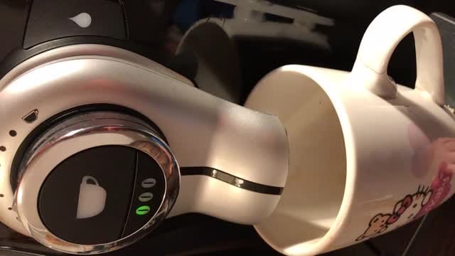

    The strange behavior of the coffee machine - the coffee flies not evenly and literally spits coffee, as if it had no pressure at times. I attach a video. Additionally, the grounds are wet and I have the impression that there is too much water in the condensate container. The distributor is new. I am asking for advice, what can I do?

    From the video it does not look like it is in the description. Check what discs are at the power of coffee for 3 beans. Set the grinding thickness to a minimum and you will see if
    discs are less humid. By distributor you mean brewing unit no
    manufacturer 996530003229?

    Yes, the brewer / distributor is new, in fact the discs are drier, but the water still spits coffee a lot further.

    As for the water in the tray, replace the O-rings on the finger that you see as you remove the brewing unit.
    It should be much better and the cost is small.

    The film squeaks and shoots a ball in the brewer's valve (probably dirty), unscrew the two screws on the top of the brew unit (torxy 10), there should be a spring and a glass ball. Clean the ball and the ball seat inside, also use some cleaning chemicals.
