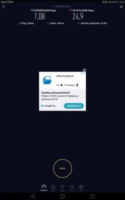

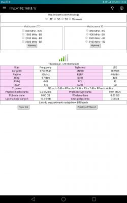

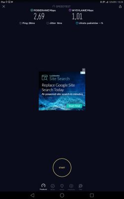

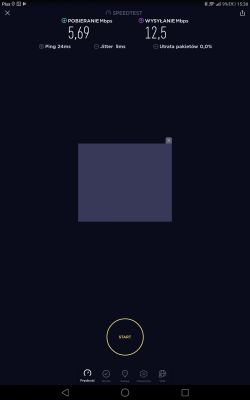

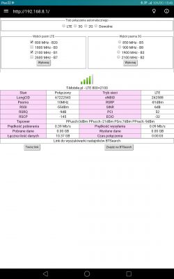

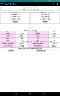

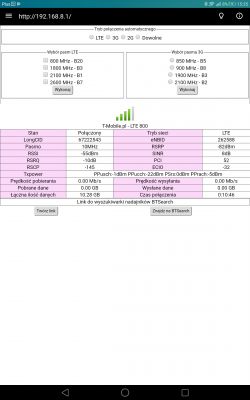

    Hello, yesterday I bought home internet in T-mobile with a speed of 60MB / s, I live in Międzyrzecz (52.449748, 15.587320) and what kind of internet I get: Huawei B528: Improve T-mobile 60MB/s Home Internet Coverage in Międzyrzecz - Tips & Tricks Huawei B528: Improve T-mobile 60MB/s Home Internet Coverage in Międzyrzecz - Tips & Tricks Huawei B528: Improve T-mobile 60MB/s Home Internet Coverage in Międzyrzecz - Tips & Tricks Huawei B528: Improve T-mobile 60MB/s Home Internet Coverage in Międzyrzecz - Tips & Tricks Huawei B528: Improve T-mobile 60MB/s Home Internet Coverage in Międzyrzecz - Tips & Tricks Huawei B528: Improve T-mobile 60MB/s Home Internet Coverage in Międzyrzecz - Tips & Tricks Huawei B528: Improve T-mobile 60MB/s Home Internet Coverage in Międzyrzecz - Tips & Tricks
    I am sorry that it was not arranged like this, but the worst speed test is 800 + 2600, the average speed test is 800 + 2100 and the best one is 800 + 1800. I will add that I keep Router (?) By the window, do you have any idea how to improve this result? on my phone that I have in play, my speed reaches 80 mb / s so I have access to LTE Advanced for sure, thank you very much for the quick answer. [/ img]

    All this is a connection with LTE800 T-mobile on ul. Konstytucji 3 Maja 18. As a baseband in LTE800 + 1800 aggregation. There is rather no T-Mobile LTE2600 on it. make tests of LTE800, LTE1800 and LTE2600 alone and show the screenshots. It's not fun, UL> DL is proof that the BTS is overloaded. There are 2 more NetWorks LTE1800 BTSs in Międzyrzecze.
