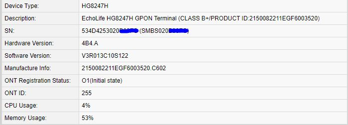

    Hello Dear Forumers,
    I want to connect my own ONT to Orange FTTH network.
    The question is why OLT authorizes ONT? MAC and password or is there also a certificate?
    Apparently someone managed to fire it on some Chinese insert ... but did not write what he set ...
    MAC on Funboxie3 is worse with a password ...
    PS. I know what the danger of connecting the trash to the FTTH network is. I connect the equipment that orange still has on offer but mine.
    Additional question - is provisiong in orange based on TR-069? Anyone know the parameters for the server? Login pass?
    best regards,
    Piotr

    The first part is fine - he is identified, but the second is not - MAC has nothing to do with it, it is called PON SN (PON serial number) and has a strictly defined format - four ASCII characters (vendor-id) followed by eight digits hexadecimal (device-id). In some, ONU can change the reported SN, but not in all (depends on the manufacturer).
    And it is not the rule that this is how Olciak authorizes "his" - sometimes an alphanumeric password is involved, sometimes a logical ID (everything can be set), the mechanism with SN is, however, the easiest and most common, because even after resetting the ONU factory settings "gets along" with OLT and can download the configuration via OMCI.
    TR069 is just one of the options - OMCI is the standard in GPON, but many * PONs just can't use it, which is a pity - having well-configured OMCI you can easily leave the default password of the ONU administrator - even a customer can even change it and give him full access to the device panel - in case of problems, it is enough to reset it to factory settings and virtually "from place" has a working network again. (Through OMCI, OLT can upload any WAN configuration profile to ONU, including PPPoE or other key variables, and even firewall or natu rules.)
    As for the title question - if you find a way to "clone" SN ONU, the device will work without problems in the orange network. At the same time, as a man who has already installed a little different * PONs, please - we experiment only with functional devices that do not have damaged lasers and the ability to glow in fiber with something that clogs all communication in one of the directions.

    You will not hook up to one olciak two ends with the same SN - at best one tip will throw the other, in the worst it may cause OLT suspension due to an emergency.
    The linked manual refers to OLT and tip management using OMCI - it's quite different. If you have a working transparent ONU, then you do not need to replace it - you connect your router directly to it.
    Another thing, if you got FB3 or other router with built-in non-replaceable ONU - then in fact its "cloning" would give you some benefits, of course assuming you would not want to use FB3 at all.

    You must clone in the ONU Huaweia serial number of the PON module from FB3 (this is the one that begins with the letters SMBS on the rating plate). Orange has olciaki mostly Huaweia (and several dozen pieces of Alcatel-Lucent), which, in any case, manage OMCI with those of him.

    How to make a clone on it without putting it on the programmer ?.
    Is the option of an external program to change SN ?.
    Tomorrow they are to be with me on FB2 for a replacement, but if I can't manage my HG8010H, I have to pay them PLN 129.
    Today there were my technical friends and they connected the GPON to me, but they did not connect because of this serial number (no authorization). So I'm on my own, actually on You ;) .
  • #18 17999459
    DJTrueBeliever
    Posts: 222
    Help: 15
    Rate: 20
    And after telnet / ssh with data telecomadmin / admintelecom can't do it?
  • #19 17999579
    Dulan
    Level 26  
    Posts: 1212
    Help: 26
    Rate: 246
    Pewnie tak, ale potrzebuję poprowadzenia za rączkę.
    Czyli np. Putty, sesje na SHH ustawiam, adres ip Gpon (192.168.100.1) i co dalej
    W sumie to lepszy Tera Term.

  • HG8247H SN format and GPON password mismatch
    #20 18183177
    bigospoznan
    Orange FTTH: ONT Authorization by OLT (MAC, Password, Certificates) & TR-069 Provisioning Info
    in the HG8247H router I can edit the SN and GPON pass.
    A rather simple matter with the slogan in the Orange network.
    However, I don't know if I'm doing well with SN. As it was written on the sticker under FB3 and starts with SMBS is the vendor ID and the rest the correct number.
    in Huwei pastes the whole number of 12 characters and I take it as ASCII probably.
    And Huawei replaces it with HEX.
    But despite this, I do not grab the internet.
    What am I doing wrong?
  • Enter the full 12-character serial number in SN field
    #21 18184947
    Dulan
    Level 26  
    Posts: 1212
    Help: 26
    Rate: 246
    If you can change SN, enter as many characters as in the original.
    From what I remember, I only entered characters in what's in brackets.
