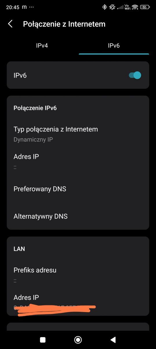

    Added after 2 [hours] 14 [minutes]:
    Of other interesting things we get ICMP type 11 on this homebox router, it has some weird port open quite high and best of all it has tcpdump installed on it....

  • IPv6 setup questions for Deco X20 PPPoE network
    #30 21387534
    soulafein83
    Posts: 24
    I decided to link to the topic because it seems to apply to my problem as well.
    In the last solved post I set up my fibre network from T-Mobile via 3 x Deco X20 via PPPoE. This works, it seems, more efficiently than before.
    On the other hand, I need to set up IPv6 at my place (for Matter devices etc). And this is where the stumbling block begins as I don't know exactly how to do it correctly. In the Deco options there is an option to enable IPv6, but I don't know whether I should set the connection as "Dynamic IP" or as PPPoE or as PPPoE with the same settings as IPv4. Does anyone have experience with these settings?
    Regardless of what I set up to test some IPv6 address is only visible on the main X20 router, while on the satellites connected by cable via switch (with Ethernet Backhaul) it is not visible - I assumed that since they each have a separate IPv4 address it must be the same with IPv6, but maybe I am wrong?
    Also, is there any site that checks if I have IPv6?
    IPv6 settings screen in the mobile app for the Deco X20 router. .
T-Mobile FTTH connections on Orange infrastructure typically provide IPv4 addresses behind CG-NAT, similar to LTE networks, with public IPv4 addresses available optionally, sometimes for a fee or upon request. Customers receive PPPoE credentials (username and password) at contract signing, enabling configuration of sessions for IPv4 and IPv6. The ONT device is generally provided by T-Mobile technicians if requested in advance; refusal to install without ONT is possible, but may depend on region and technician discretion. Orange does not officially provide ONTs to individual customers unless specifically arranged. IPv6 is native and public on these networks, with no NAT applied to IPv6 addresses, though firewall rules may restrict inbound traffic. Orange uses NAT64 and CLAT for IPv6 on LTE/5G mobile networks. Dual PPPoE sessions can be configured to obtain separate public IPv4 and IPv6 addresses, but hardware acceleration for PPPoE/NAT may be lacking on some routers, impacting throughput. Public IPv4 addresses are scarce and often come with static assignment. Operators pre-configure ONT/router devices, limiting local technician configuration. Geolocation of IP addresses depends on geoIP databases but generally aligns with Orange Polska or TP-Net ASNs. Some users report vulnerabilities in operator-supplied devices and prefer to use their own ONT and routers. IPv6 support is important for modern protocols like Matter, with local IPv6 sufficient for LAN communication but global IPv6 needed for external access. Alternative providers like INEA may offer ONT and public IP configurations differing from T-Mobile and Orange. Overall, the network setup involves CG-NAT for IPv4 by default, native public IPv6, PPPoE authentication, and operator-controlled ONT provisioning with regional variability.
