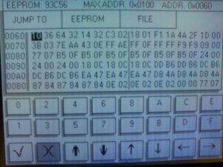

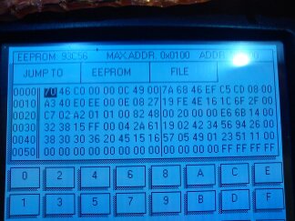

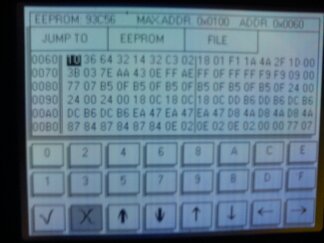

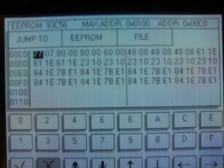

    Hello again, somebody can read the pin from the ecu reading or only from the photos from the eeprom count

  • #27 12719340
