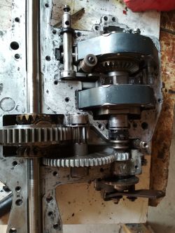

    Hello, I wanted to ask if anyone vented the hydrostatic box? I have tecumseh 205-025B peerless boxes, the box was unscrewed, washed, flooded with oils where 10w40 satellites. And where hydro 80w90 and now after mounting the crate does not work. Earlier, it operated only after a long drive, it did not manage, even the molehills stopped it. ?????? Bleeding Tecumseh 205-025B Peerless Hydrostatic Box: Troubleshooting & Tips for 10w40 & 80w90 Oils
    This is a box for which the manufacturer does not provide for repair, the question of whether "earlier" someone flooded there some oil not needed (too rare, especially after warming up) or it was factory condition. In any case, I'm afraid that ripping wasn't a good idea, I would start by changing the oil after unscrewing the diaphragm: https://youtu.be/CLQF22FVxms?t=4m21s

    This box requires no bleeding. Pour original oil, it's important. :|

    Dextron 3.
    Added after 55 [seconds]:
    In older versions, dekstron 2.

    Someone was spinning there was visible and the oil was generally flooded. That it would not turn out that scrap metal is suitable ehh. Something else to think about is flooding oil in 80w90 original class and council lime. And do you know how much exactly you can pour this oil there? maybe I'm wrong because that oil was red it could have been the dextron and I flooded others and it's lime. I will try thanks to everyone.

    Okay, I did, but now with this oil, what 20w50 or this dextron at last?
    In the sense Tap water do you mean rare oil?
    Dexron would pour and see the effect. But if the problem is the use of sealants, it won't change much ...

    Something else to think about is flooding oil in 80w90 original class and council lime. This oil is not suitable for this type. After all, it is a typical gearbox. :|

    And I flooded the lawn mower with cool drexton for about an hour and then suddenly stopped. Does anyone know if it is possible to repair such a crate or can you buy some parts for it?
    Since you once dug in this box, check if it is not a simple problem, such as falling out of the groove fixing one of the wheels.
    You will not buy original parts because the manufacturer's case is not repairable. However, in the thread referred to in post # 5 you can read that there are in the .pl a tray that even oversized pistons make extra money ...

    I am converting to a manual gearbox I have one for a few zlotys this will probably be the fastest solution.

    Converted to manual, it's nice. Works half a day, small modification of the handles on the crates, cutting out the hole for the gear stick.
