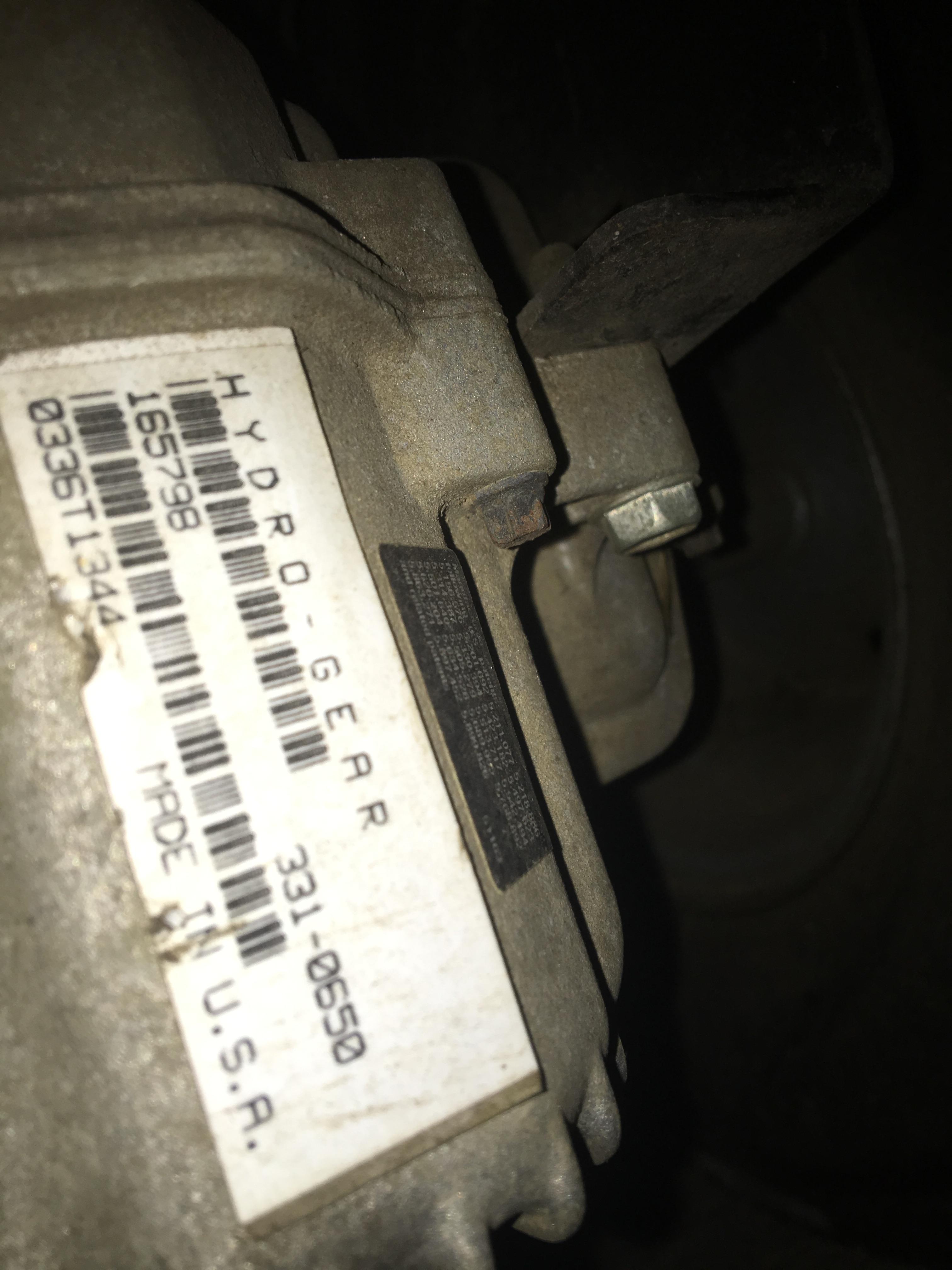

  • #13 16258322
    helena33
    Posts: 762
    Help: 94
    Rate: 730
    White stickers on the casing of the crate
  • #14 16258400

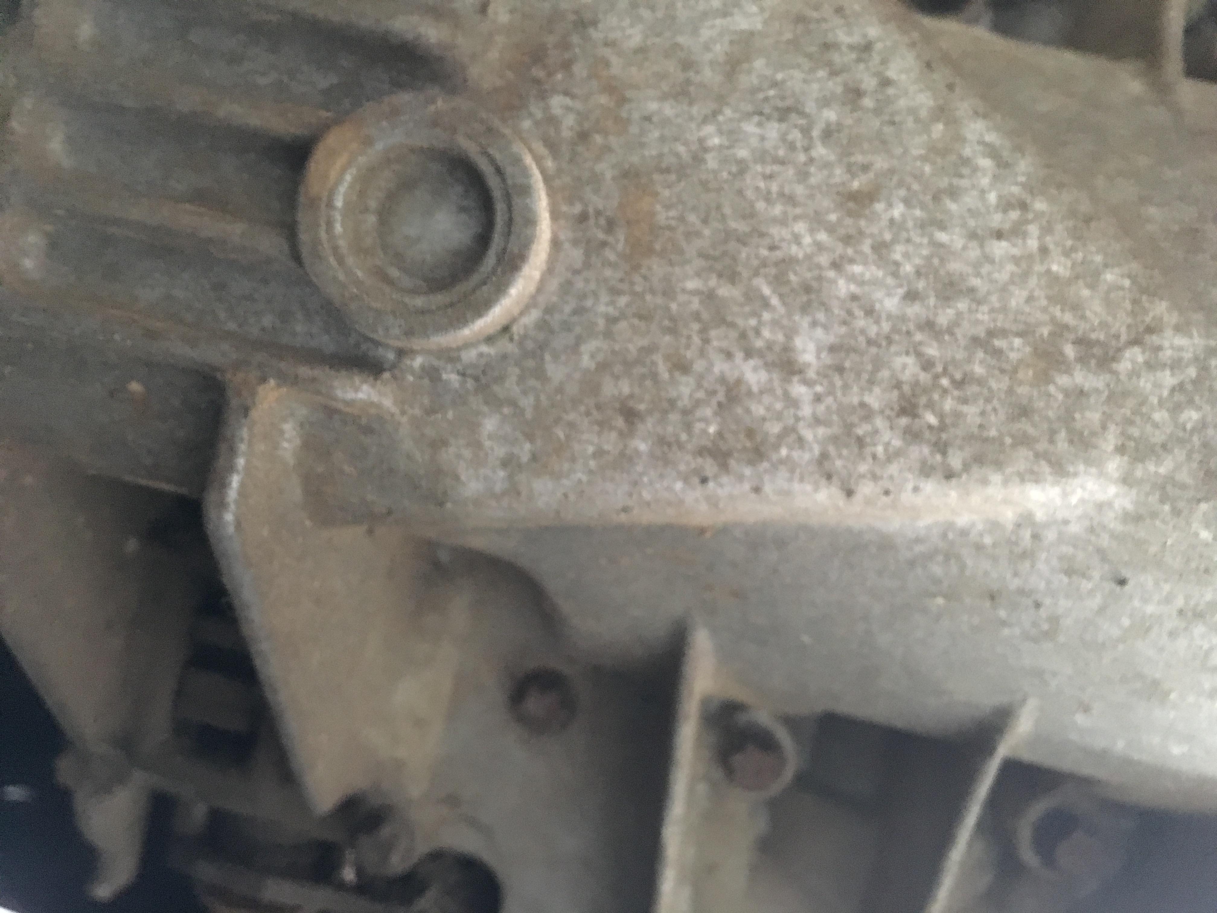

    I have one more question because I checked the oil in the box and there is still a few centimeters under the plug, how can I add oil to this box
  • #16 16318418
  • #18 16320596
    75max
    Posts: 13
    Rate: 9
    I have a plate, I already know that it is HYDRO GEAR, i.e. 20W50 oil, only if it can be the same as in the link below or it must be dedicated to this box
    Husqvarna CTH 130 Hydrostatic Tractor - Gearbox Creeping at -3 Temperature: Oil Thickness Impact
    How to change the oil, I took a picture, there is a plug from the bottom of the box, but the plug is missing, so you need to remove the box to change the oil or somehow remove this plug
