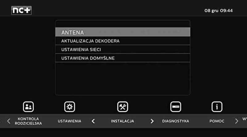

    I had another move and reinstalled the antenna again. (I have a sat finder). Unfortunately, the decoder never showed me even 1% quality with a signal strength of up to 80%. I did a reset. Now it displays Signal strength 75%, quality 65%, satellite hot Bird but does not download channels.
    Please help.

    #7 17194553
    olador
    Level 37  
    Posts: 2766
    Help: 429
    Rate: 1450
    I went to the nc+ website for instructions, I don't see any problems with the installation.
    If you reset the tuner, you need to reprogram it.
    You go to the menu, select - settings - installation - antenna ...

    Master1975
    Posts: 13
    Ok but the antenna is positioned correctly.
    That's what I did and it didn't find channels

    andpol 33
    Posts: 4157
    Help: 513
    Rate: 1146
    Well, he will roll like this ... If you claim that the antenna is set correctly ON THE RIGHT SATELLITE, then you have a damaged decoder.

  • #18 17847741
    Master1975
    Posts: 13
    Thanks for the advice, indeed I had the wrong antenna set up..
