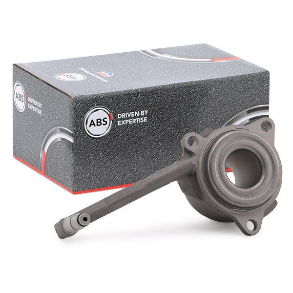

    I drive for a few years and the clutch catches nicely from the bottom, there are no problems, it works perfectly - except for one.
    It has always been necessary to use a lot of force to depress the pedal.
    How to diagnose where the problem is?

    If it was a clutch or a pump, you would not have a clutch and the clutch would fall into the floor. Pressure or ... It depends on what car it is, if it has a cable, then the cable is old

    Specify which car, if Peugeot or Citroen from 2000-2010, a lot will be explained.
    Several factors can affect a "heavy" clutch; cable - if present, pedal spring. Rather, you need to exclude the pump or clutch actuator you provided.

    The release bearing is there such
    If I detached the hydraulic hose, the pedal should go light dry, and how hard will it be, is the spring in the pedal?
