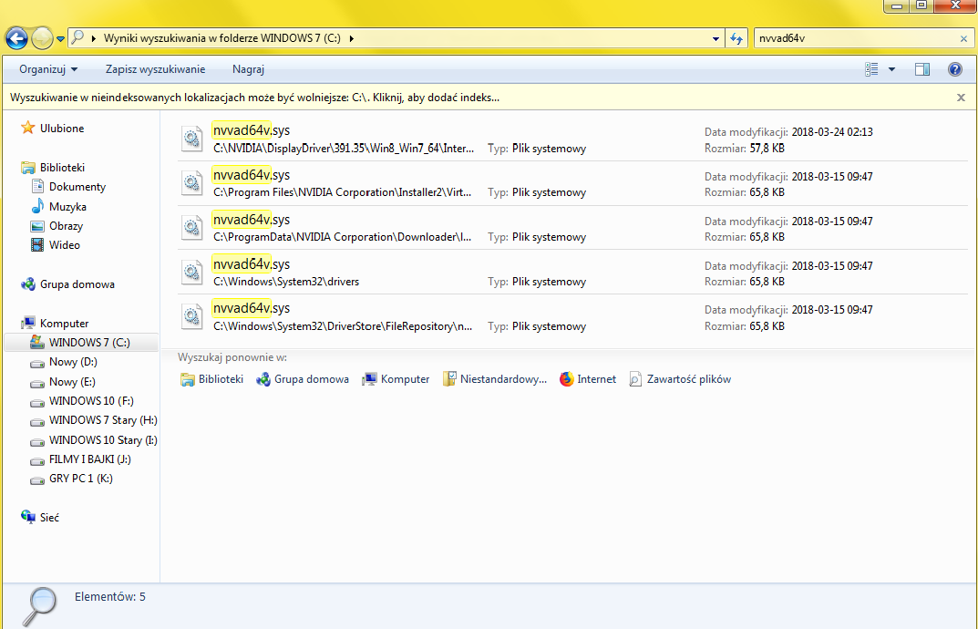

  • #32 17311980
    SLU06
    Posts: 52
    hold, I see that there is a problem again with another driver, I checked it and it is also duplicated.
    • Bluescreen "Page fault in nonpaged area" i "Bad pool caller" Bez tytułu.png (95.8 KB) You must be logged in to download this attachment.
    • 070418-16161-01.rar (35.01 KB) You must be logged in to download this attachment.
  • #33 17312011
    Robert B
    Posts: 22594
    Help: 2027
    Rate: 1412
    The first three are irrelevant because Windows doesn't use them. The last one, if it is in the same version, shouldn't cause any problems. Reinstall the drivers for the graphics card.
  • #34 17312065
    SLU06
    Posts: 52
    I was just reinstalling it about a week and a half ago.
  • #35 17312850
    310artur
    Posts: 9002
    Help: 980
    Rate: 670
    So use DDU - clean your graphics drivers and install fresh.
