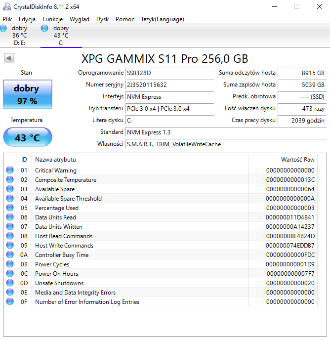

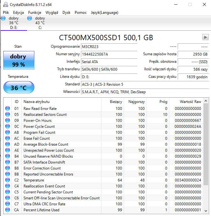

    #12 19286520
    Michu734
    Posts: 19
    Hello, I will post the data from the programs and check how to do this test because I am completely green in this topic.
    I also noticed that after yesterday's incident, my fps in games dropped significantly - about 50 fps drop in battlefield 1.
    Thank you very much in advance for your help ;)

  • #24 19290816
    Michu734
    Posts: 19
    Thanks for all your help and I wish you all the best ;)
    Added after 13 [minutes]:
    I have one more question, because I had game boost turned on and it's probably automatic overclocking... I read that it can set too much voltage, so it would be correct that bluescreens never appeared in games with high power consumption, only when browsing the internet :) I don't know that's my theory
  • #26 19522792
    Michu734
    Posts: 19
    Updating the BIOS helped :) , and only automatic boost to the processor in the MSI board - most likely it was overclocked at low load - bluescreens appeared on YT and Google but never in games.
    Best regards and I think this will help :)
