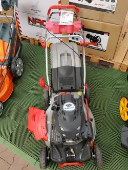

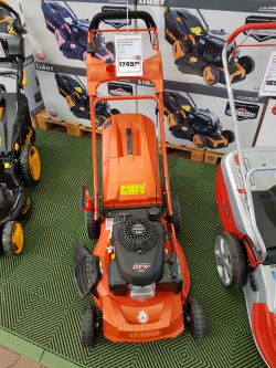

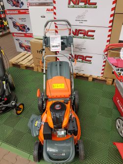

    Due to the fact that all mowers shown by you have a central mowing height adjustment, I suggest that you look very closely at the attachment of the front axle to the tow truck. The method of fixing it is usually the technically weakest solution in such equipment. In the past, all mowers had a separate adjustment of each wheel, which was associated with a more solid attachment to the housing. Convenience and economy have led to a central adjustment and introduction of the front axle. If you think that one of these mowers is more solidly resolved, I suggest you think about it. If all have a similarly delicate solution, choose the cheapest or search for others.
    I will not help choosing a brand or model because I do not follow the market of market mowers. To express these opinions, I am prompted by my previous experience with similar equipment.
