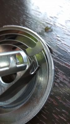

    Hello, the girl blew the roller shutter, the whole tape fell out, etc. I took it on this retractor however the problem is that when I roll the blinds when I want to pull it, the retractor does not pull the belt, I have to push it in, can be somehow repaired? Unless I do something wrong, the circle on which I wind up the belt has no resistance and should probably have one.

    I saw these films, but they put on the roll on them, then I curl up on it and I do not want to.

    Have you made the spring?

    We do not like much :( there are some manuals for this or something, for me it is just a spinning circle xD I would like to try to shoot this spring, I have no patience and probably will not succeed, but you can see ;)

    Do not turn this disc in the opposite direction to the belt winding. You will feel that the spring is stretching. I do not know how high this roller blind, but do it with 10-15 turns. Then hold the puck (you can use this tin burr on the side) and hook the strap. The task is child's play.

    hmm .. I'll tell you that the idea is interesting, I already thought it would work, but no, I'm shooting and nothing, probably a hundred times, however, it did not bring any effect, the spinning still takes place with the same force and the wheel is still standing there without pulling the belt, so probably this mechanism had to be damaged inside, strange because the girl only broke the casing somehow, so I don't know how the mechanism broke, I'm curious if something can be done about it, because the roller itself is brown, it matches the color of the blinds and the window frame, additionally when replacing the whole thing, I would have to screw it to the wall again, which in a rented apartment is not too cool, but it seems to me that you buy it all rather than the internal mechanism itself.

    Spring may have broken. You can buy a new one and post the disc itself. Look at whether the central part of the disc does not rotate around the plastic spindle. Maybe it worked out there.

    Unfortunately, the piece of spring is broken, the one that hooks on the stem.

    Why buy? Harden the spring tip and drill a hole of this diameter to hook on the spindle.
