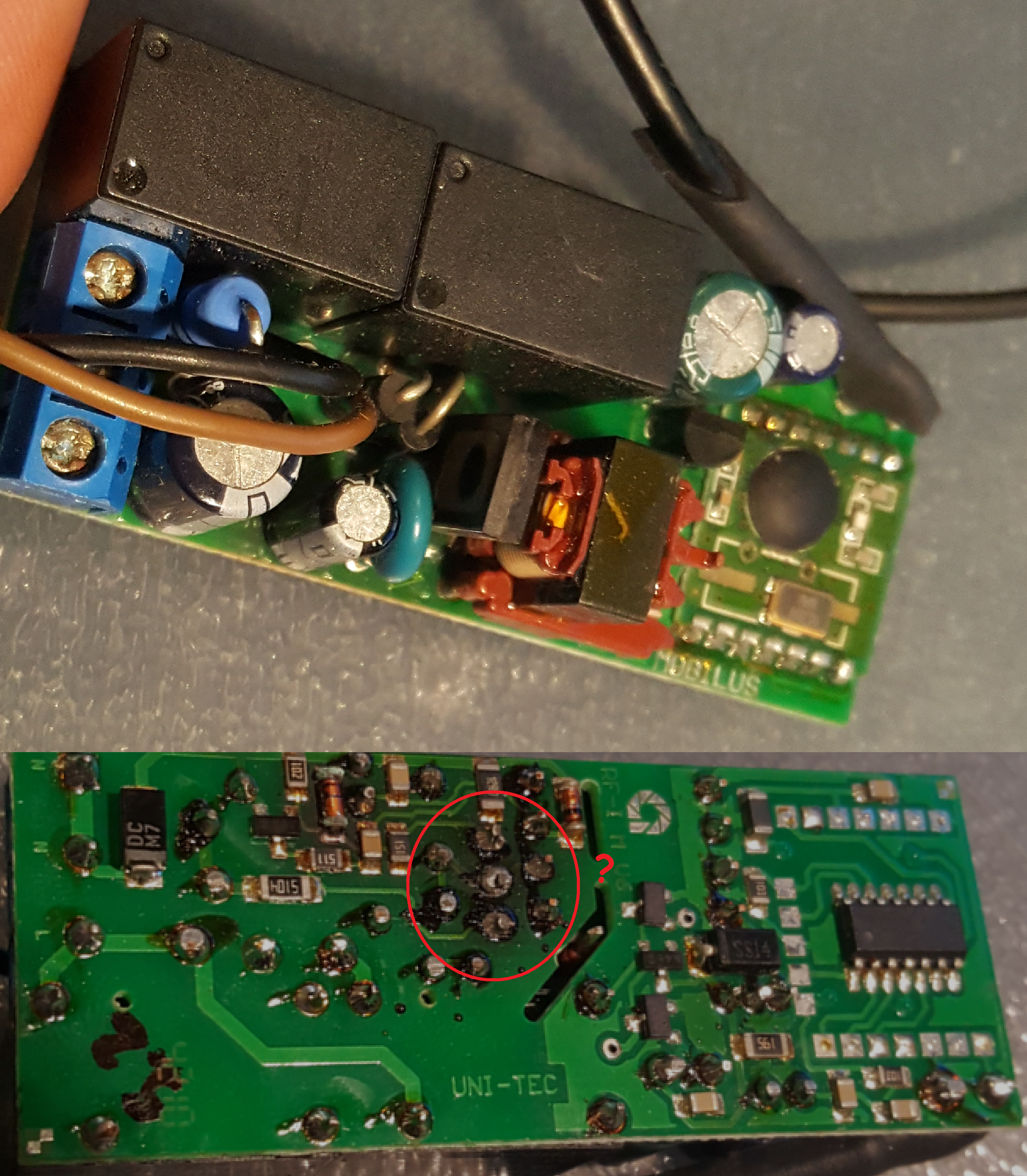

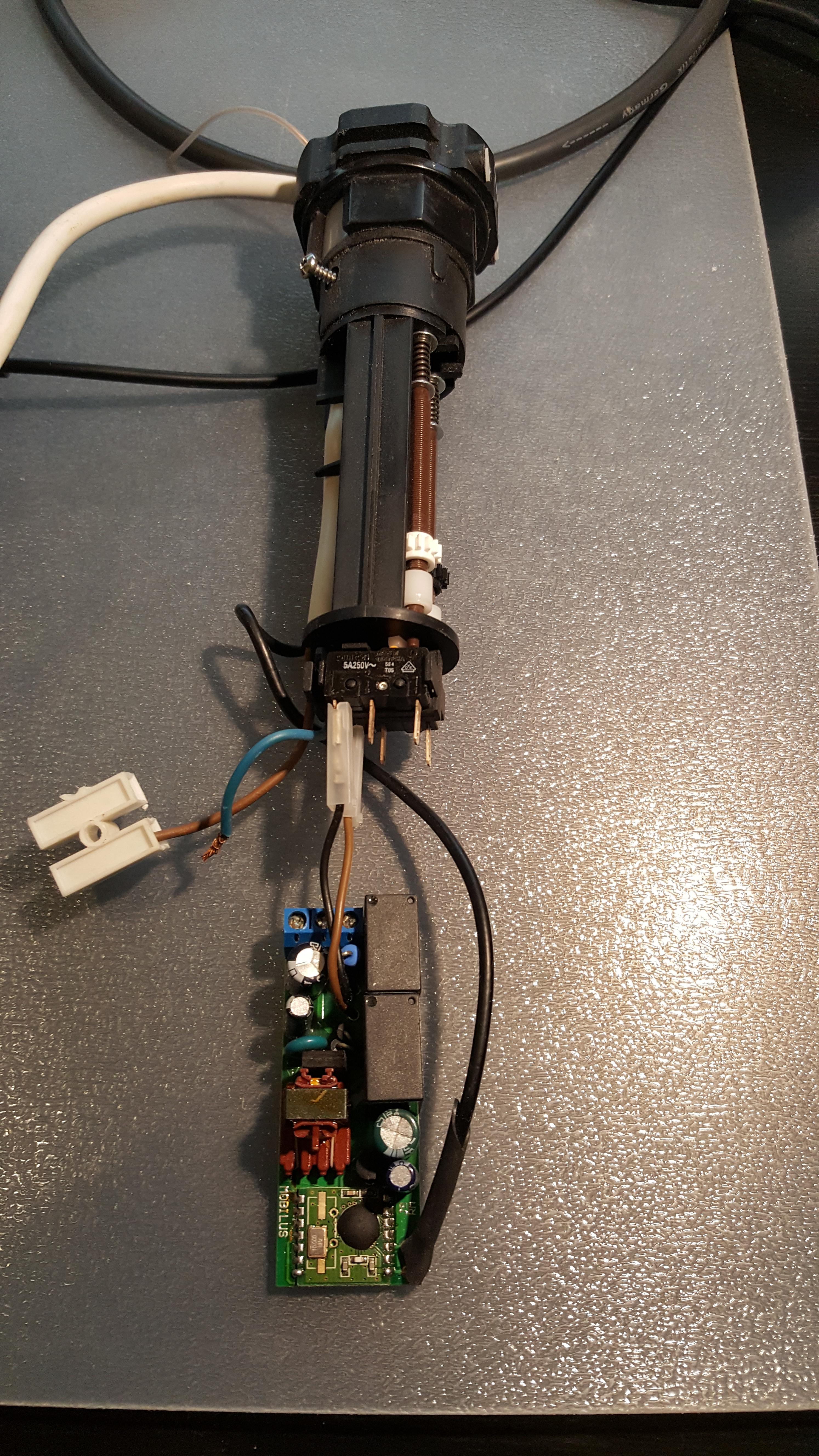

    I have a question about how to carry out diagnostics on a faulty roller shutter motor, where to start?
    Background: motivation + electrical meter - in a word not much.
    New 300 pln. I have two damaged ones. 600 pln makes a difference. So I decided to ask for help.....
    Pictures attached.
    Thank you in advance for your reply.

    There are two relays on the board presumably to control the direction.You need to power it bypassing the control board. Maybe the relays have died and the motor is not getting voltage.

    On the board (circled), You have cold solders clean them and correct them.
