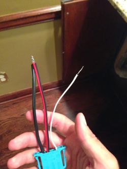

    Good day. The problem concerns the car BMW E90. After a long stop in the car, the airflow stopped working. Just a moment after starting, it spun for several seconds, stopped and switched on again. After several such cycles, it "fell silent" completely.
    I started to dismantle the cabin filter, hoping that the blower motor just rusted (there was a red coating on the mandrel) and it is enough to manually start and grease it. Unfortunately, these actions did not bring the expected result. I just checked the technical condition of this engine and after connecting it to the car battery it works normally ...
    The second circuit in this circuit is a resistor commonly called a hedgehog.
    Not having much scope to show off (the resistor in this car, unlike the previous generation e46, unfortunately is not repairable) I ordered used on a well-known auction site.
    Unfortunately, the purchase turned out to be a box and the blower on the second resistor still does not work.
    With a multimeter, I checked that the "hedgehog" still has 12V. Does anyone have any knowledge what values should be on this thin control cable? Below is a preview photo.
    Bmw E90 - Searching for the reasons for the insufficient ventilation
    How to determine that this resistor is damaged, not the car's electrical system?
    best regards

    asdros wrote:
    How to determine that this resistor has been damaged
    Your deduction is destructive, since you bought a new hedgehog and it still doesn't work, it means it's not a hedgehog.
    On a thin wire, the voltage is to change with the speed control on the panel.
    Thirdly, it is not e36 that you can play pifko and kebabs during breaks in the car.

    So I tried to collect some measurements and it turned out that the blower motor has 0.7 ?.
    Then I checked the incoming voltage in the plug reaching the resistor, which was disconnected from the rest ... And so I obtained the following results:
    1) voltage in the red cable 11.94 V
    2) voltage in the control cable with 0.09 mV airflow adjustment panel turned off
    3) voltage in the control cable at a maximum airflow setting of 0.12 mV
    Then I made the same measurements with a resistance connected:
    1) 11.89 V
    2) 11.86 V
    3) 11.83 V
    There should be a PWM signal in the control cable, why is it different for me?
    How to take further diagnostics?

    I diagnosed the problem when I dismantled the climatronic panel and looked at it closely. On the path, in the place of defect, a patina raid occurred and the electronics settled the matter. Both resistors and blower are functional.
