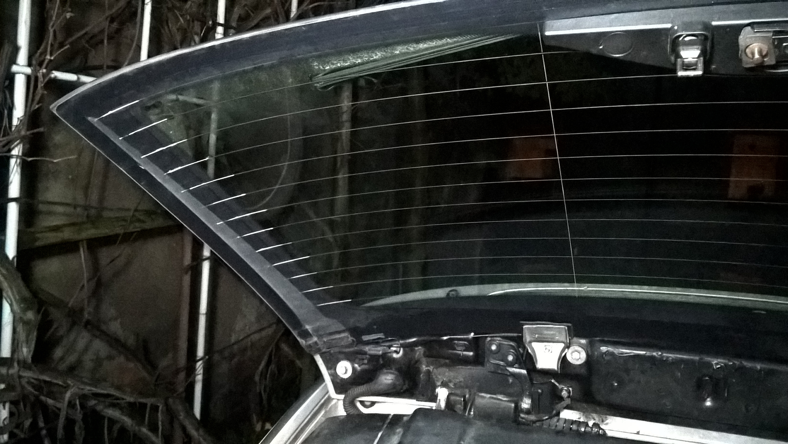

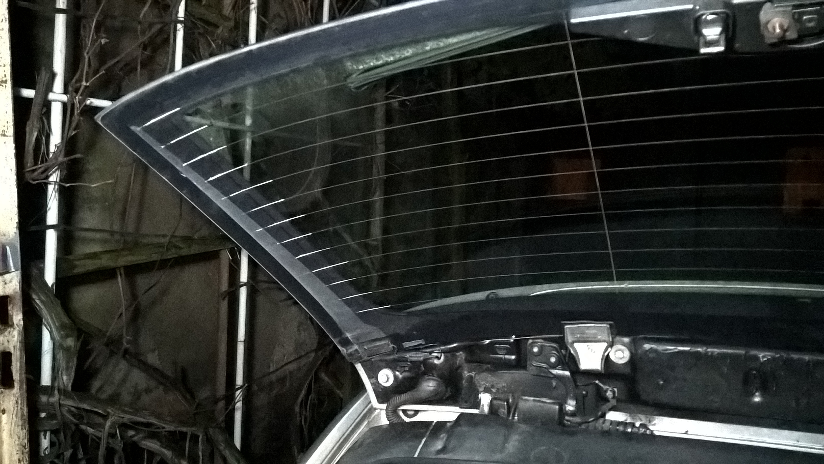

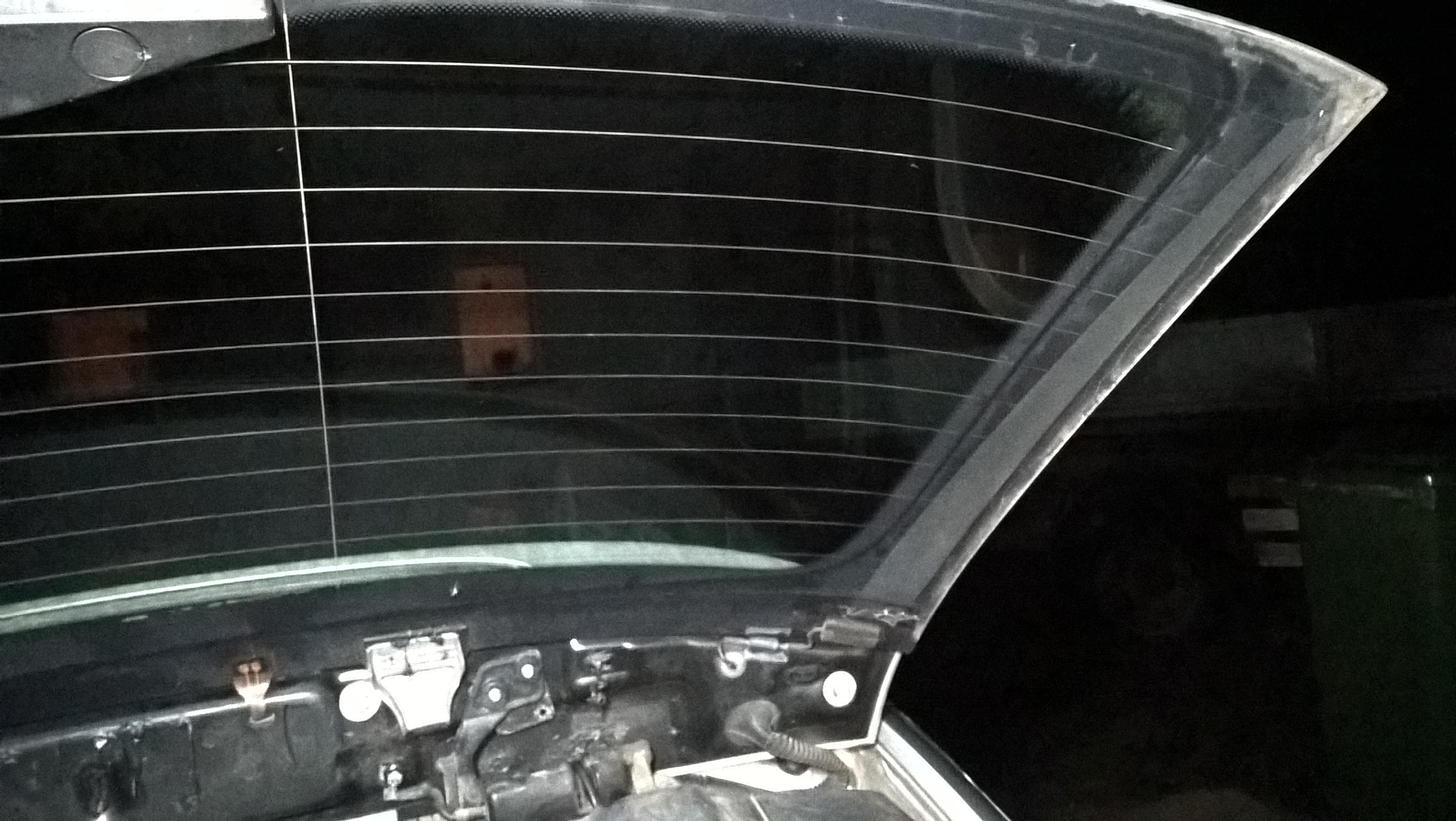

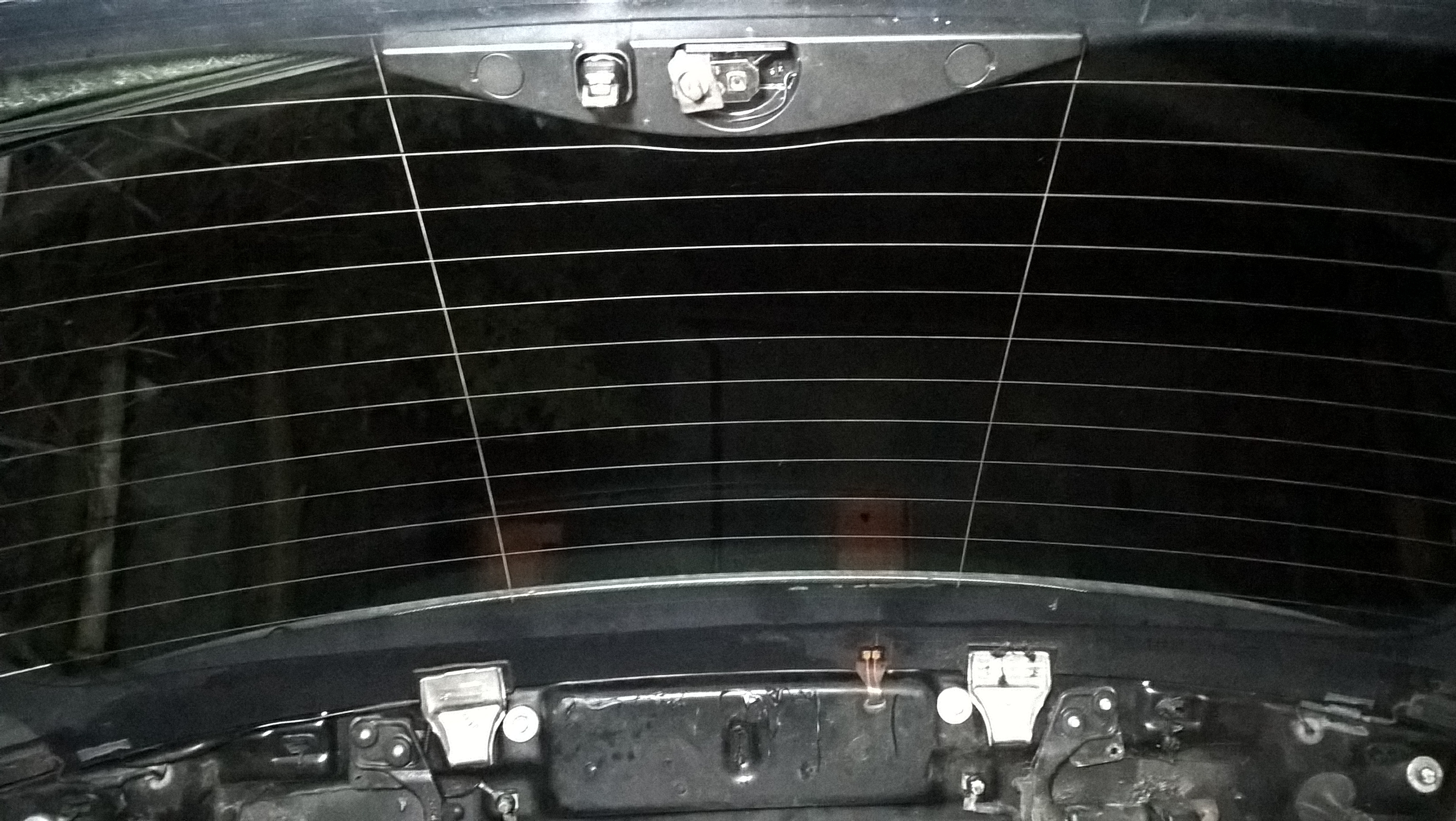

    Hello. It's about heating the rear window in touring. The point is that all the strips do not heat well, or in some places as if the vogels did not heat. In one place, in the middle of the glass, there is more or less a place the size of a matchbox that if I touch it, after some time it becomes so hot that you can burn yourself. I corrected the left extreme with thermal varnish where these lines go to such a black strip and in my opinion it did not work. I bought a multimeter and I saw somewhere that you can check the current through these lines and it will come out where it is interrupted, etc. But I do not know how to go about it. I am asking someone involved in the subject for help. When turning on the heating, you can hear a tick in the trunk as it comes on.
    I fixed it the second time and wiped off the black edges under them there is probably a wire and it goes to the strip that distributes the electricity to all the threads, I also corrected there with a conductive varnish and now only one strip heats up and not even all the way to a certain place, in the attachment there is a photo of the same windows and the place where it heats.

    You have measured the voltage on the power supply of those, if it is 12v above on the working engine, then the glass needs to be replaced, what if the belts are not fixed.
    These stripes are the main points where the cable connections are.

    I failed. The gasket rubbed off the varnish immediately, electric arcs can be seen in the darkness in the places of painting, in some places the glass started to melt. I am trying to replace the glass, but I wonder if it makes sense - the glass is not stiff when opened, it will wipe again in some time. But according to for me it is the only effective solution in this car - it is not a sedan with a stiff glass.

    What are electric arcs? How is it noticed?
    I do not believe that the glass needs to be replaced because there are burned stripes or something like that, since this is someone who did it and if he did it, he goes to fix it, then it is not a space shuttle, in my opinion. I don't think there's an America there, maybe I'm wrong because I'm not an electronics engineer. From what I read, it works on the principle of a short circuit, that current flows through these strips and thus they start to heat up. I am asking someone to explain to me what in such a simple system can also break apart from the stripes. Now one strip is warming me, but it is going to burn myself.
    Sparks, blue flashes in the places of varnish.
    eclipse10 wrote:
    How is it noticed?
    Paint it, turn it on and observe the repaired places after dark. When you look closely, you can see it in the day.
    eclipse10 wrote:
    I do not believe that the glass needs to be replaced because there are burned stripes or something like that, since this is someone who did it and if he did it, he is going to fix it, it is not a space shuttle, in my opinion.
    You write that you have a station wagon, in the station wagon the glass is opened and all the time it gently rubs against the seal, if you have breaks there, the paint will wipe off quickly. If you find a durable and hard varnish, if there is one, it will work. I tried and the effect as described.
    The beams and relays are still breaking down, but you have it working, because nothing would work.
    Because not all of them work and those who work overheat.
    You can still try to smear it with a soft pencil (graphite conducts electricity) but it will not work for a long time (I tested).
