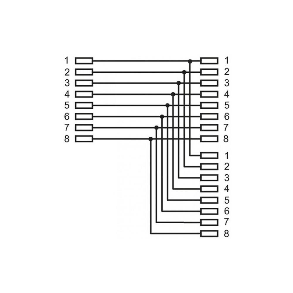

    All in all, this can be slightly reduced. Use a LAN tee like this one:
    Passive tap (tap) of fast ethernet - IP "listening in"
    And build a cable

    Gruby__ wrote:
    And build a cable
    It's not really about that. Because it's not about splitting, but joining parallel to the line. But your suggestion of using such a tee is not bad.
    Because by properly preparing two such tees, one can make a tap with a transition to two strands of one cable, and from the other, a splitter for these two strands for two cables for two network cards. And it will be very elegant. Admittedly, not in terms of compliance with standards, etc. But what is not done for science.
    And it's important that it works, as shown by the author of this thread.
  • #8 17220084
    Gruby__
    Posts: 356
    Rate: 37
    But that's what a tee does. Splits the signal into two of the same. So you can connect the source on one side, the receiver on the other and pull the tx and rx out of the third socket using the cable shown in the diagram (for two network card connectors). And then you don't need two tees ;)
    EDIT :O of course I mean a RJ45 tee, not a splitter
  • #9 17220112
    rb401
    Posts: 3002
    Help: 750
    Rate: 984
    Your diagram suggests something else. But you are right here that such a tee can be used as a tap without any modification, and from it a standard 1: 1 cable can go towards the eavesdropping computer. However, from the computer side, a second tee is necessary to switch from one cable to two and it is necessary to modify it to cut off the transmission direction from the eavesdropping network cards (because it will get chaos) and to enter one of the cards with the RX receiver pins on the second twisted pair than the second card has RX connected.
    So the second "tee" should have a diagram as you originally drew here. A tap is a tee without modification.
    So what you have in the first drawing is ok. And the diagram would apply to the second "tee" (in appearance, because it would not be a tee).
