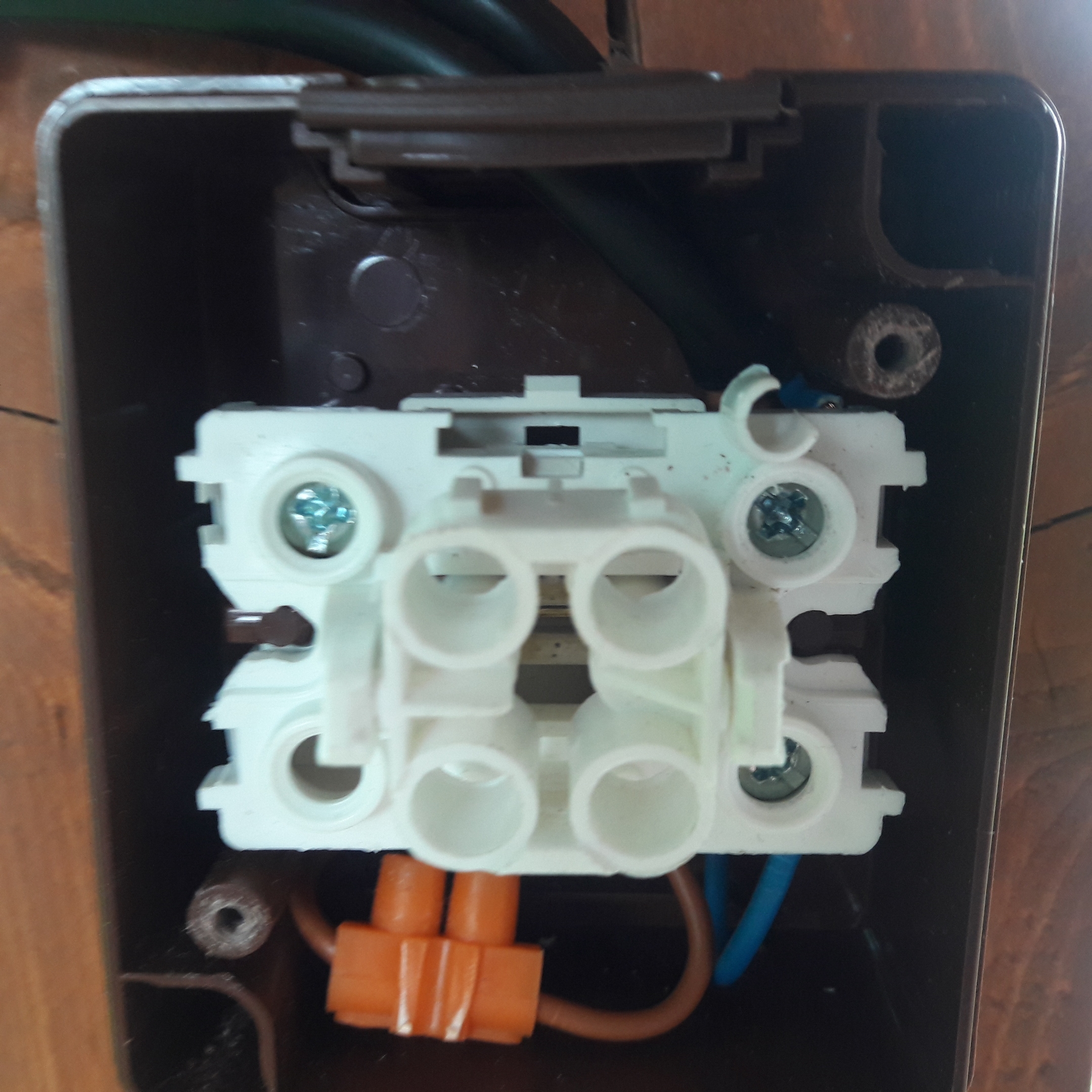

    Yesterday and today there was an electrician for me to make arbors.
    Yesterday he led the cable from the house to the gazebo.
    Today he tried to make installations in the gazebo, he did it like this:
    The cable from the house goes into the can in the gazebo in which it is extended because it cut too much ...
    one cable goes out of the box and goes to the socket, then the cable goes out to the single-pole switch (the brown one is separated at the top and the other at the bottom and the blue one goes all the way) and then from the switch the cable goes to the place where it is to be power supply to which LED lighting will be connected
    My problem looks like this:
    After my return from work, I found the installation as I described it, a few beers and an electrician sleeping in the gazebo ... so I chased him because after waking up he could barely stand.
    I wanted to see if what he did was working so I connected the plug to the cable that was supposed to be plugged into the house (unfortunately he didn't make it before he got tired) and plugged into the socket but unfortunately "knocks out the plugs"
    I had contact with the installation for the last time in primary school, so please help, Connecting Cable from House to Gazebo: Socket to Switch to LED Lighting InstallationBez nazw..4.jpg (80.95 kB)You must be logged in to download this attachment.

    It could be (socket, switch, lamp output) distributed from the box, but the sense of connections is identical. If it is connected this way, then there is no right to "blow traffic" as you called it.

    And the protective conductor is where it is?
    And what does it mean to break the traffic jams? Is the circuit breaker or residual current device working?

    Is the power supply and lighting or just the end of the cable?

    Protective conductor probably sold for scrap, judging by its retention. While writing the traffic jams I meant that the fuse lever s301 falls
    Adds photos of connections Connecting Cable from House to Gazebo: Socket to Switch to LED Lighting Installation Connecting Cable from House to Gazebo: Socket to Switch to LED Lighting Installation

    And I see a blue plug in the switch - and it was just going through ;)

    And in addition, it is not known where the brown is connected.

    In fact my error is sorry, brown is flying past.
    Brown is connected below in this orange connector
    there is only the end of the cable.

    This installation cannot be put into service because of
    No protective conductor
    Incorrectly selected wire cross sections
    Connecting socket circuits and lighting.

    This would have to be replaced: brown should be routed through the switch and blue connected at the cube. You should also make sure that the brown wire is a phase and the blue wire is zero (neutral). For testing, the cable going to the lamp should have separated and insulated ends.

    Gentlemen, be serious, the color change on the switch will not improve anything here, this pseudo installation is broken !!! don't even suggest to the author about it thing framed he tinkered because if he actually started it he would kill someone or a gazebo in the end.
    The installation should be carried out from the beginning using the cables intended for this purpose with the appropriate number of wires and not the extension from the night lamp.

    of course I will exchange. can this cause a short circuit?
    stanislaw1954 wrote:
    You should also make sure that the brown wire is phase and the blue wire is neutral (neutral)
    It is not yet permanently connected so I will definitely connect brown as a phase.
    he left such an orange in the connector and I insulated it.

    I hope not connected both together (blue with brown).

    I checked, they are separately.

    Well, either you have drawn the diagram incorrectly or show the connection in the can.

    the box is just to extend the cables and hide it somewhere.
    in the orange connector
    brown with brown
    blue with blue.

    A short circuit must be somewhere, since it turns off the circuit breaker.

    So I have to understand that everything is connected well only short circuit must do somewhere on the cable? Tomorrow I will trace the whole cable or somewhere it is sometimes damaged.
    Also, I will probably list everything as mawerix123 wrote
    If you can, please help how it all looks to be safe and working.
    What cables, what connection diagram.
    thank you in advance.

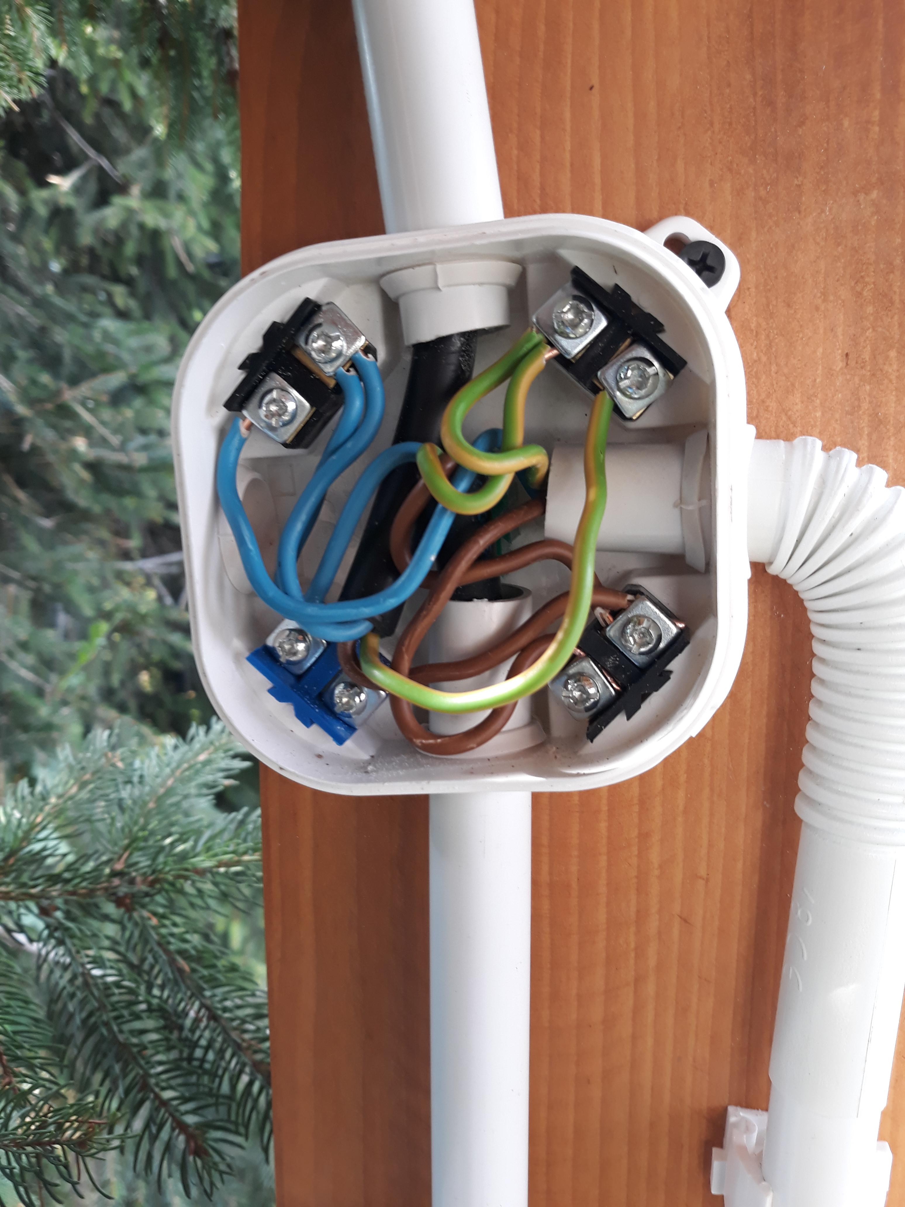

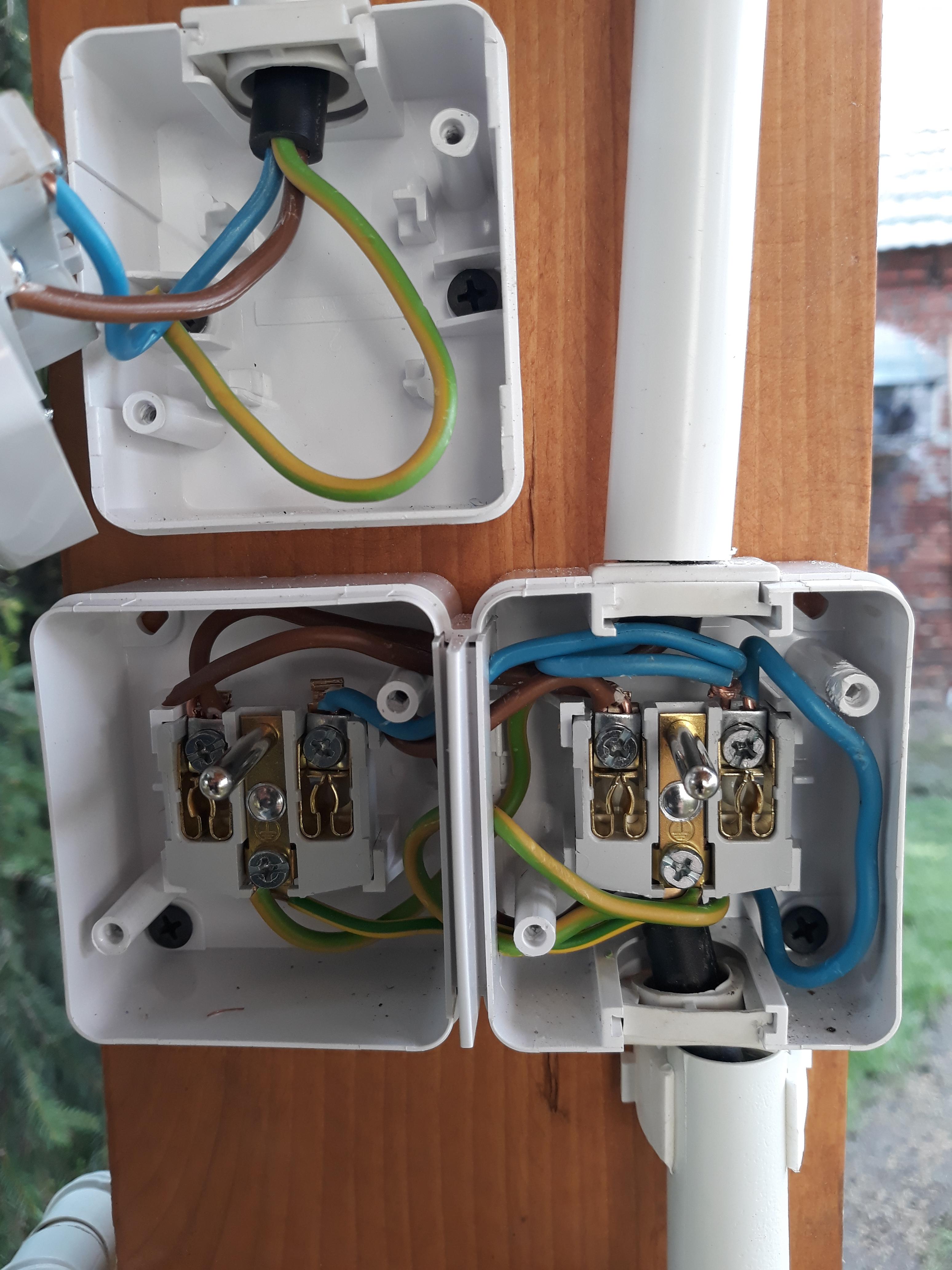

    Hello, I have a similar problem, you could click what it looks like, after connecting the power supply a fuse popped out

    Correct the neutral (blue) in the right nest - currently one is wrapped around the other (inept turn?) It will certainly cause problems in the future. To throw away the protection, I do not know what to do - disconnect the receivers (LED power supply) and then check.

    And isn't it by chance brown merging with blue in one clamp in the left nest?

    Everything is already clear, by trial and error I connected a blue lighting box with a brown switch and the bulb lit, but another problem came out, on all yellow wires the test tube shows voltage, in the sockets on the pins also, I disconnected all yellow wires and what turns out is still electricity, the electrician came to me with the meter, the meter did not show voltage, WHY WHY THE YELLOW CABLES WHEN I CHECK A PROBE CANDLE - the strange thing is that these yellow wires are completely disconnected, nothing supplies them

    THIS WHY THE YELLOW CABLES WHEN I CHECK A PROBLEM CANDLE - the strangest thing is that these yellow wires are completely disconnected, nothing supplies them
    Voltage is induced in these wires because they are not connected anywhere but are near live wires. Protective conductors should be connected, but where it depends on the type of network and should be done by an electrician, and not just check the presence of voltage with a voltmeter.

    When connected they also shone on the tube

    They were connected, but to the grounding pins, and where is the other end?
