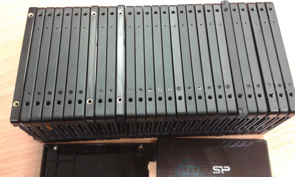

    xntxnt
    Posts: 373
    Rate: 82
    The ones I have - the stickers are identical except for the s / n :) . But the firmware is numbered completely differently. There are at least 3 types of housing (one plastic and two metal). Understands also different. The photo he posted Fox is the content of one of these metal varieties.
    Without breaking down into versions, they break down in about 3 ways:
    - SATAFIRM S11 in BIOS and no data access
    - "bad sectors" -> unstable work
    - disappearing from the system after some time - even via the SATA-USB bridge
    In addition, some have a reduced SMART. Some are even cheated - for example, they show that they have a constant temperature of 30 * C.
    The second metal version looks like this:
    Silicon Power S55 240GB SSD Issue - Visible as SATAFIRM S11, BIOS Detection, & Data Recovery Silicon Power S55 240GB SSD Issue - Visible as SATAFIRM S11, BIOS Detection, & Data Recovery Silicon Power S55 240GB SSD Issue - Visible as SATAFIRM S11, BIOS Detection, & Data Recovery
    The one in plastic is different:
    Perhaps there are others, but apparently I only have them, or they just don't break.
    And what? Various controllers. Someone will surely fire some soft and surprise :) .
    There is really no point in saving these disks. It's junk. Pity the nerves. If something needs to be recovered - ok, they are from this company. But keep on using after a crash ??? Throw them away and you will do a good deed for yourself. Seriously.
    In less than 4 years, 50 out of 200 were lost. I suspect that many more, if not all, are damaged. Some equipment is simply rarely used.

    I do not have all the disks that have fallen, but of the 32 that are waiting to be destroyed - 27 is the version in a metal housing with Silicon Motion SM2258XT. So what's yours.
    Does that mean the SM2258XT sucks? I do not know. Probably a lot depends on the memory and firmware used.
    Anyway, I don't think you should look for bargains at the lowest price, because then you don't know the day or the hour. I already know that I will only bet on companies with a 5-year warranty, even if it is apparently more expensive. Seemingly, because data recovery and system rebooting costs money and time.
    Although, unfortunately, Silicon Power also has a 5-year series.
