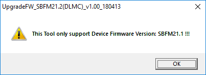

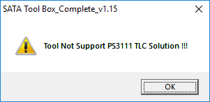

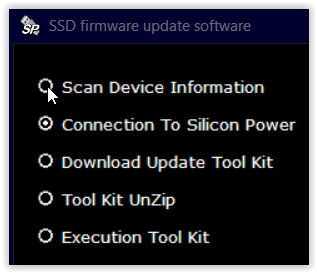

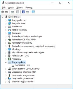

    SSD of the company Silicon Power , model S55 240GB . It stopped booting overnight and is visible in the BIOS as SATAFIRM S11. When inserted into another computer as a second, in "Disk Management" it is uninitialized, but the capacity is surprisingly correct. It can not be initiated. In this state, data recovery programs hang when you try to scan it.
    I do not have a lot of pressure to recover my data, but if I could, I would get a few days.
    The disk is not detected by the manufacturer's programs, it is: SP ToolBox and SSD Firmware Update Software . I understand that the controller firmware has been lost. Is it possible to put it on my feet with some other soft?

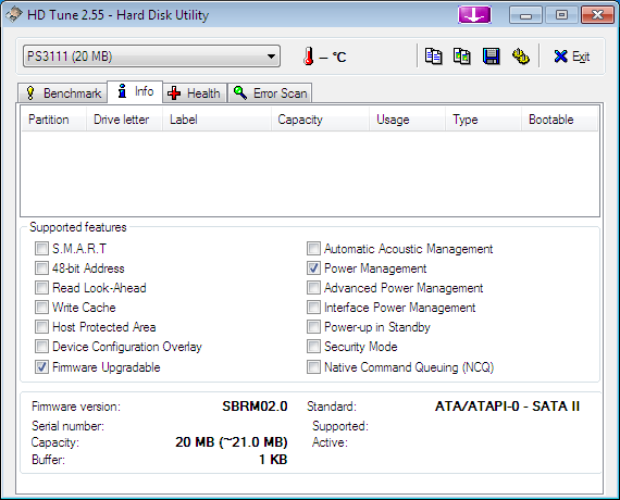

    Below photos of SSD-Z and HD Tune, and for comparison of the same photos on a good disk (unfortunately, I have them a few):
    Silicon Power S55 240GB SSD Issue - Visible as SATAFIRM S11, BIOS Detection, & Data Recovery Silicon Power S55 240GB SSD Issue - Visible as SATAFIRM S11, BIOS Detection, & Data Recovery Silicon Power S55 240GB SSD Issue - Visible as SATAFIRM S11, BIOS Detection, & Data Recovery Silicon Power S55 240GB SSD Issue - Visible as SATAFIRM S11, BIOS Detection, & Data Recovery
    Good drive:

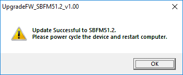

    Interesting fact: I have reviewed configuration files from SSD Firmware Update Software and two have quite interesting content:

    ... that is, the program draws something from the network (at least it is possible). Only from where and if something from this set can resurrect this disk?

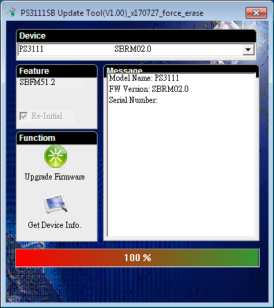

    Check the detection of efficient and damaged in PhisonToolBoxCompletev1.05.exe . :idea:
  • #3 17232646
    xntxnt
    Posts: 373
    Rate: 82
    Ooo, Russian sites are amazing :) . By: http://www.usbdev.ru/files/phison/phisontoolbox/
    ... program version 1.05 (Complete) does not yet support the S11 controller, which is probably a disk, so I started from 1.15, running with two S55 disks connected (good and damaged):
    He detected both, although at first the clicking between the disks did not change (SMART readings as well), and after running the program, SSD2 disappears (although, for example, in Disk Management - he was still there). Computer restart and returned to normal. Good and damaged:

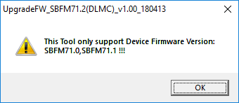

    An attempt to upgrade from the program, regardless of the disk, shows:

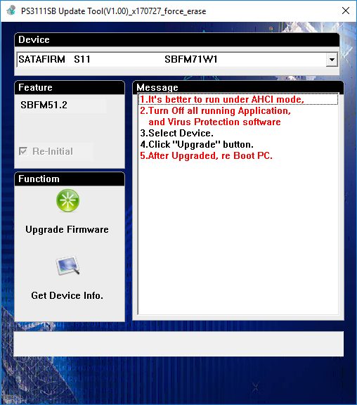

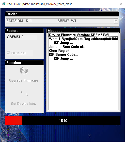

    I also launched 1.05 (Complete). Both disks are connected.
    The result is this:
    I guess something does not play, because there is nothing active to click on, not counting "X" to close.

    I thought Win10 might spoil something, but under Win7 the same, also when there is only one disk.
    In the meantime, the manufacturer sent me a new firmware (I attach the file UpgradeFW_SBFM21.2 (DLMC) _v1.00_180413.exe - all in all I do not know exactly what it suits):
    However, this error crashes:
    Also for the time being lime.
    • UpgradeFW_SBFM21.2(DLMC)_v1.00_180413.exe (4.28 MB) You must be logged in to download this attachment.

    The program you have given is not detecting either a damaged or a working disk (whether Win10x64 or Win7x86):
    A newer version (103), downloaded for free from the manufacturer's website ( http://www.silicon-power.com/web/pl/firmware ) responds to a working drive with the following message: "this firmware is the latest version."
    ... and damaged: "No new firmware is available or drive is not recognized."
    That is the same as if I launched the program without any disk of this company.

    Well, unfortunately, I've lost my grandfather :) . And it was like this:
    I admit that without knowing what to do, I let go again (without rebooting). Maybe it was a mistake:
    And after a reboot, the disk was already like this (the system detected the disk as "SATA BURN"):
    And another attempt gave such an effect:
    And now the best part of the program :) . After I finished the drive, I got an e-mail to support Silicon Power with the following content:
    I'm sorry for the wrong firmware tool. You could refer to the attached file to update it again. Thanks!
    And that's one of the grandfathers! :D
    As you can guess, it was a bit too late and the bottle delivered by them came out on me:
    I wonder if the program has a "-force" switch to force flush? Or is there a rescue way to get out of this version in which I am. Probably yes, but does anyone know?
    Well, nothing. I still have a lot of this stuff, so it's just a matter of time until another one falls. Maybe this program will be useful for him. I am enclosing him for free ... I am so extravagant ... I have the 6.97 point in the end :D . Electrode spot beggars, unite! ;)
    And seriously, I am for free and unheeded knowledge. I have enough profits from those who do not want to use what is at their fingertips out of laziness.
    • UpgradeFW_SBFM71.2(DLMC)_v1.00_180413.exe (4.28 MB) You must be logged in to download this attachment.

    Interesting fact: HD Tune was able to scan the surface without problems (the disk had 20MB). I regret that I did not suspect DMDE what was in these sectors.

    Another second, identical disc fell on me. That's what I tried to treat with what the producer finally sent me (as a reminder: they did not immediately send the right FW). Unfortunately, it crashes:
    ... or not so FW. I have no ideas what to do with these crap.
    been added:
    The above image was from a program that will not fix THIS specific disk - not the firmware, hence the error.
    The second one had firmware: SBFM71W0, so it's no wonder that what they sent to the previous disk, did not want to fire. The program did not find anything to update. To make it more fun, this second drive is practically a new drive without a waveform. As I was able to advertise it, it went to the complaint.

    In the post # 7 it looks like you uploaded the SBFM firmware 51.2 on SBFM firmware 71W1 what you caused him to perish. Probably, UpgradeFW_SBFM should be uploaded to it 71.2 (DLMC) _v1.00_180413.exe
    The second disk that you lost, what are the firmware versions now?
    I came across this topic because I have a similar problem, only that I have the SBFM50W8 firmware
    Device Model:     SATAFIRM   S11
    Serial Number:    8E31076B0508061*****
    LU WWN Device Id: 5 000000 000000000
    Firmware Version: SBFM50W8
    The program from the link https://www.silicon-power.com//web/pl/firmware in my case detects everything and recommends uploading SBFM51.2 with the fact that the title of the window has the word "force_erase" which would suggest that the update erases the data. Is this really the case, and the data is already unrecoverable?

    And now one more curiosity. The third S55 240GB drive :D . Firmware, just like you: SBFM50W8.
    This time the user reported a reluctant system start and restarts. I regret that I did not take pictures with my phone, but sometimes it was a funny effect on the Win10 login screen - instead of letters, there were rectangles.
    I entered the Device Manager and there ... SATAFIRM S11. And the system as-tako competed:
    As you can see, only one disk, which is the system I am running from. As there was no pressure on the data, I downloaded what I could to a USB drive under the system.
    Just like you, the program has found a file that updates it to SBFM51.2 without any problems - it went well:
    I attach a program. You've got one, but maybe someone will need it:
    UpgradeFW_..._v1.00.exe (4.14 MB)You must be logged in to download this attachment.

What does “SATAFIRM S11” in BIOS actually mean?
The SSD’s Phison S11 controller could not load its working firmware, so it exposes a minimal safe-mode device ID (“SATAFIRM S11”) instead of the normal model name [Elektroda, xntxnt, post #17227003]

Will flashing mismatched firmware kill the drive?
Yes. Uploading SBFM51.2 onto a drive that shipped with SBFM71W1 bricked it instantly [Elektroda, xntxnt, post #17239991] Always match the exact firmware branch and capacity.
Why do S55 units fail more than premium SSDs?
They pair entry-level controllers with budget 15 nm 3D TLC NAND. Wear causes firmware tables in NAND to corrupt, triggering safe-mode [Elektroda, kaleron, post #18162471]
Is Secure Erase from Linux a viable fix?
It occasionally restores write access if the disk is read-only, but it cannot repair firmware tables; success rate is “below 25 %” per user reports [Elektroda, lisek, post #18161075]
Will Silicon Power’s official Toolbox flash firmware automatically?
Often it says “No new firmware is available” even when newer builds exist, and it ignores drives in safe-mode [Elektroda, xntxnt, post #17234438]
