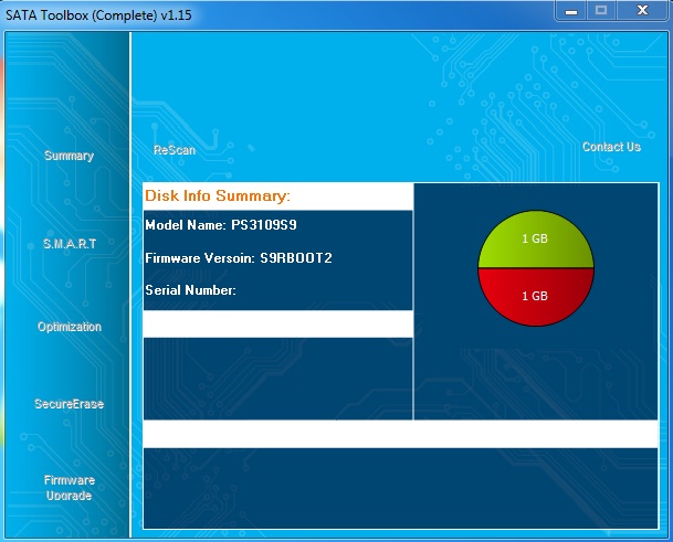

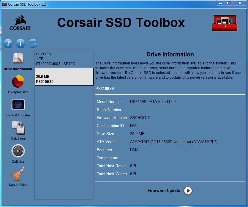

    Since yesterday I have a problem with Goodram 120 SSD c40 gb GB. Everything was ok, I turned off the computer and restarted after a while and a message popped up BIOS BIOS that I do not have the disk system installed. I booted the system from a second HDD to see what happened to the SSD. In the device manager it is visible as PS3109S9 ATA Device. In disk management, it cannot be initialized and shows 20 mb MB. It doesn't read health values from SMART. I tried recovering partitions with TestDisk but sees 20 mb MB only.

    Let's try it.
    "Collect" (dumps) info from Phison SATA Toolbox . :idea:

    The program did not detect anything until I launched it in Windows XP compatibility mode. All bookmarks are inactive.
    • Goodram 120GB SSD C40 - BIOS Message, 20MB Visibility, PS3109S9 ATA Device, Initialization Issue 3.jpg (122.06 KB) You must be logged in to download this attachment.
    • Goodram 120GB SSD C40 - BIOS Message, 20MB Visibility, PS3109S9 ATA Device, Initialization Issue 2.jpg (75.27 KB) You must be logged in to download this attachment.
