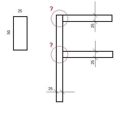

    Do you allow any connecting elements to be welded to the profiles?

    Ie. - mounting on the inside, what dimensions of the structure?

    Maybe yes :
    Dismountable Connections for 50x25x2 Closed Steel Profiles: Hidden, Secure & Easy to Assemble
    You cover the fronts of the profiles with threaded plates or weld nuts to the plates and screw them with screws, preferably allen screws.

    There will be no welding without welding, a very good solution. You insert the screws through the holes in the outer wall, which hide inside after tightening ...

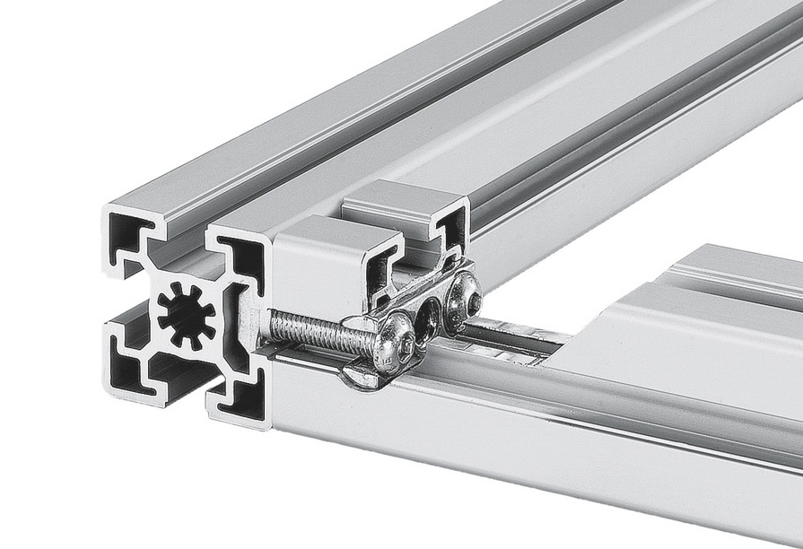

    Yes, from a different barrel, have you not thought about building your structure from ready-made aluminum profiles?
    There are some ready-made systems in which, apart from the aforementioned profiles, there are a lot of accessories: fasteners, screws, covers, plugs and what else.

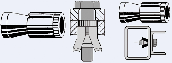

    Blind assembly insert.

    I gave 2 solutions, one with welding, the other without, the choice depends on what you have at your disposal.
    In the version with pins, if we use better steel, e.g. 45 improved or 18G2A, a 12 mm rod is enough. The thread does not have to be on the entire thickness, because you can drill the holes halfway so that there is about 6 mm of thread left. In order to prevent it from slipping, the pin must be turned at the ends to a diameter approx. 0.5 mm smaller and along the length equal to the thickness of the profile wall. This is how it is in the picture attached by me, how to take a good look ...
    In the welded version, 3 mm thick plates and welded nuts on the inside are sufficient.
    For aesthetic reasons, the welded version is better because you can't see anything, and the mounting holes can be closed with plastic plugs.
