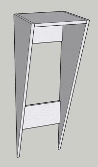

    Hi, I am planning to build a 5x7m garage with something like a mezzanine, with the rest I am enclosing a sketch:
    Garage made of steel profiles and sandwich panels - calculations.garaz.jpg (327.89 kB)You must be logged in to download this attachment. Garage made of steel profiles and sandwich panels - calculations.garaz1.jpg (260.11 kB)You must be logged in to download this attachment.
    And I wonder if I should go for a sandwich panel instead of classic blocks, bricks, etc. I want, among other things, that there are no hornets or other locusts anywhere, and it seems to me that in the case of sandwich panels, joints, etc., are so tight that it should be successful, and with boards or blocks it can be different. Well, the time to erect something from the boards is a few days, not counting the foundation, and bricklaying, insulation, plastering of classic buildings six months in my edition :D
    The problem, however, is that all ready-made projects on the net are made in 90% on porotherm - you know, the architect does not have to make any effort because a skyscraper can be placed on such a 25 cm wall. I even asked in 3 places how much to do the project, but they wrote to me that they didn't, so I assume that if I went to a specialist with it, he would cut me like a lock of Steven Segal's hair.
    So the question is, is anyone able to tell me what profiles to make such a garage from? :)
    The weight of a square meter of the sandwich panel is about 10-15 kg and on this mezzanine in gusts I would like to load, say, 2 tons. And on the purple beam, I would like to have an I-section for extracting the engine, e.g.
    Anyone can help or should I fall on a tree? :P

    I don't plan to hang anything on the walls. In fact, I was thinking that the purple beam would be just an I-section in its entirety? In my company, I have seen winches on such frames that are about 10 meters long and cranes with a load of 500 kg - how would I install a 180mm I-section in this place, for example, it would not be able to withstand?
    I have steel for about PLN 3.5 gross per kilogram. Bending? Where would it be bent?
    And when it comes to strengthening the sides, it can extend the orange beam to the very top and make such reinforcements for the purple and yellow ones?

    The plate is self-supporting. Depending on the type, there are different sizes of "buildings" that can be erected without construction.

    The board of appropriate thickness is self-supporting. Depending on the type, there are different sizes of "buildings" that can be erected without construction.
    I agree in 100%. In the case of a garage, with a single-pitched roof, the structure will be completely self-supporting, with a gable roof, you only need to tension the walls at the top with anything, even with 10mm rods, so that it does not push them apart. Folding the boards on the foam and donit or bolt the sheet metal workings. In the cold stores there are self-supporting chambers made of sandwich panels without a skeleton, over 12m high, where a flat roof with a span of several meters is suspended on 10-12mm threaded rods to the hall roof structure. It's just fun walking in the attic of the hall, bending under your feet.
    In my life I have never seen a hall made of a sandwich panel without a structure and I would not want to enter such a hall in my life :D After all, the plate is not connected with the plate, but it is screwed to the structure. How would you like to join the two tiles in the corner of the building? And how to anchor them?
    Let's not produce legends.
    The building must have a steel or wooden structure and the boards are screwed to it, there is no other option. And if I am wrong, I am asking for a specific example of such a building, then I will go and see - although I will not enter it :D

    It turned out that a self-supporting structure could be erected 6x6m.

    And I called today a company that builds such constructions and sells CDs and the guy said that he would not have built something like this without a skeleton. So I come back to the main thread, will someone tell me with a clear conscience what profiles to make the structure from? :)

    I would have made of steel. For the main structure, I would use an I-section 80 or 100. I-section also for the roof spans and you do not want to make a truss, because with this span it will be unnecessary. For the battens, a 40x60 profile with a 2mm wall is more than enough, and you can even think of a smaller one.
    This information can be found in the technical documentation that is available free of charge by most manufacturers. Because self-supporting cooling cabins made of sandwich panels can be built under a roof in an existing hall, but never as stand-alone facilities. They must have the roof structure calculated for the snow load, and the wall surfaces with the wind load.
    All data for these calculations are provided by manufacturers, usually the spacing between wall or roof profiles, the type of these profiles, their lengths, etc., etc. There is one condition, you have to buy sandwich panels from them, cut to size. :D
    In the past, all data was given in advertising materials, but I had the last contact with this industry several years ago. Perhaps, however, it is worth visiting the website of a manufacturer of sandwich panels?
