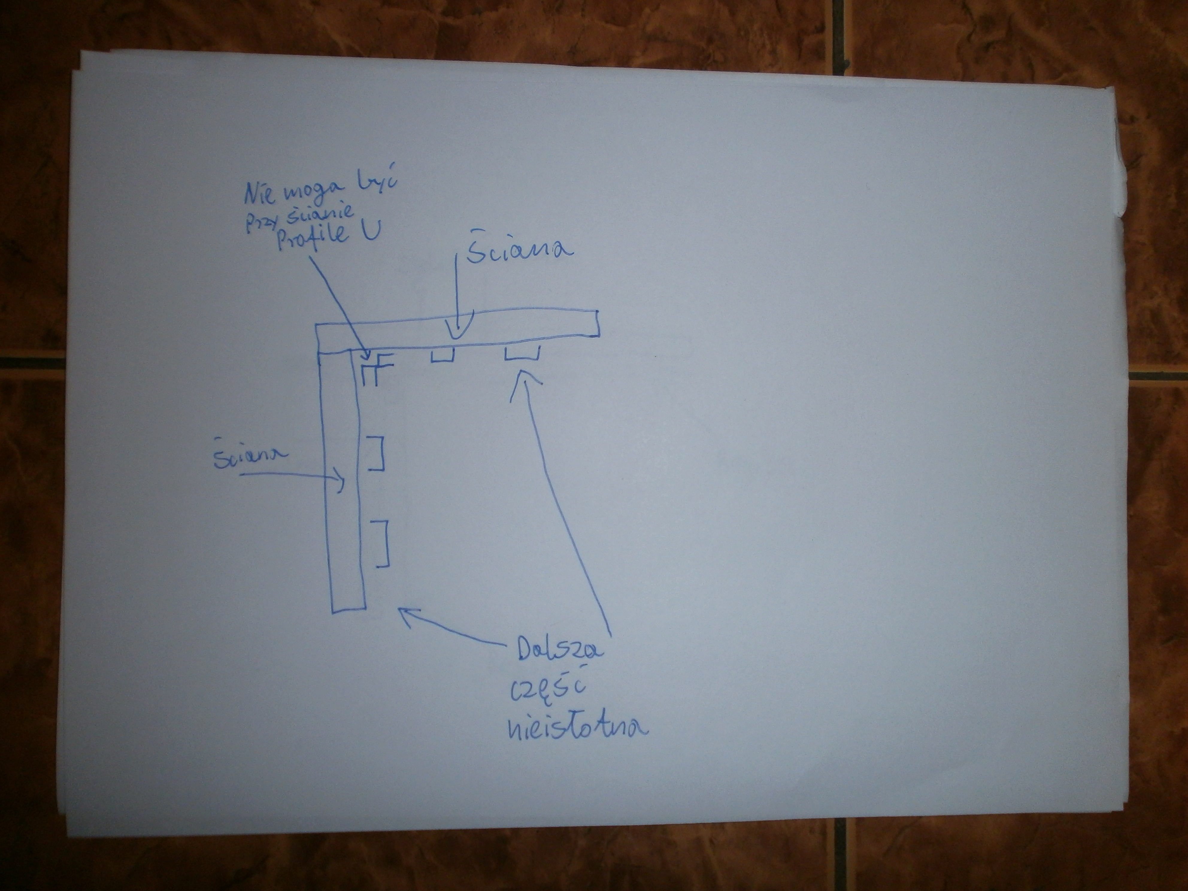

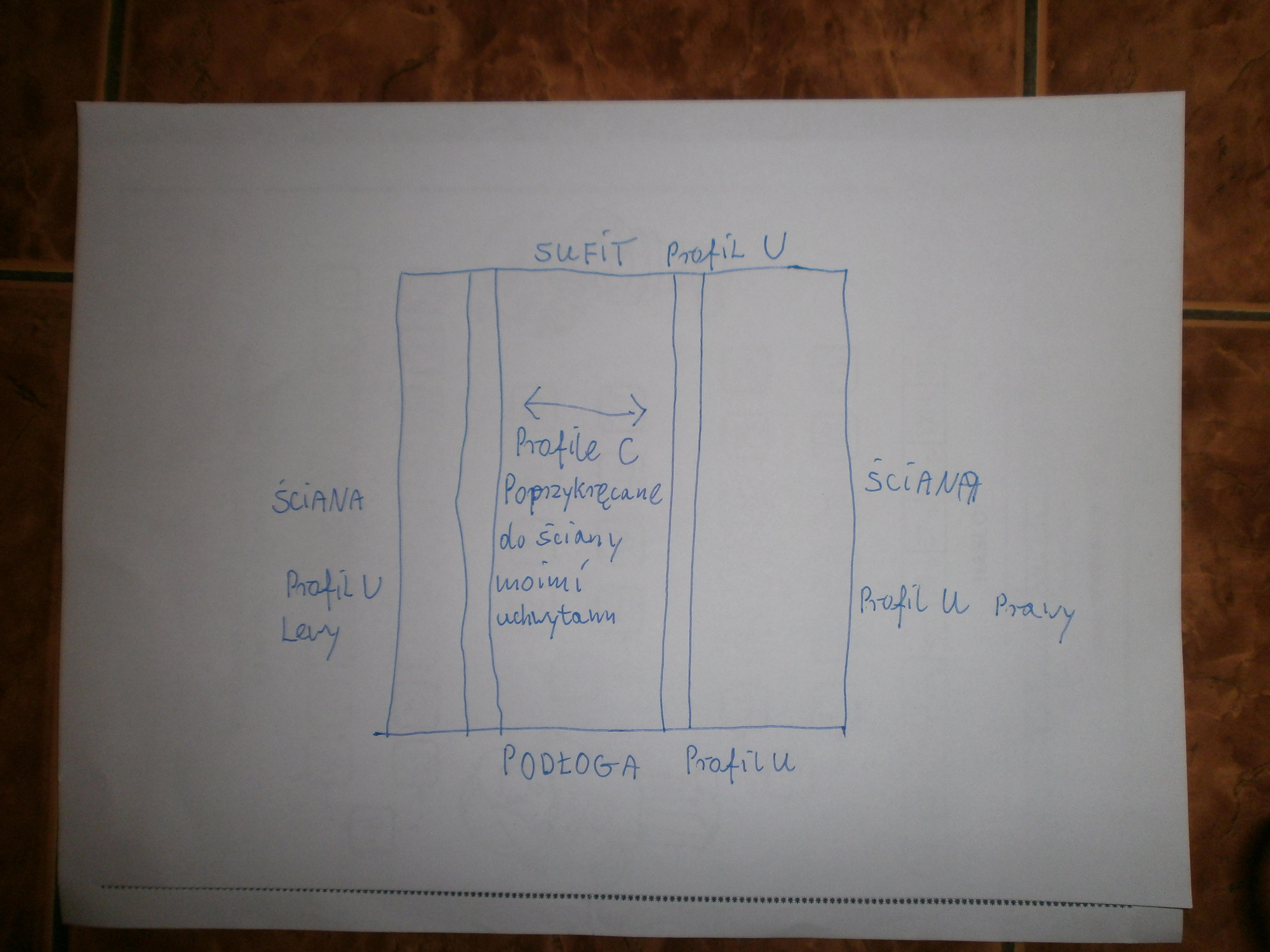

How do I attach plasterboard frame profiles at a 90° wall corner when there is no room to screw one side of the corner profile?
At the corner, mount two profiles as close together as possible—one for each wall—and screw them together so the corner joint is reinforced [#16737563] If there isn’t room to fasten a C profile to an ES hanger in the corner, use a U profile fixed to the wall and turn the plasterboard to it, or close one wall first and then start the next wall from the previous board/profile [#16738520][#16738403] This is exactly to avoid trying to drive screws into the awkward side of the 90° corner [#16738520] If you do use C profiles on ES hangers near the walls, the profile may bend while you screw the board, so fasten the boards densely, about every 10–15 cm, until the next profile is in place [#16738520]

    At the corners, give two profiles, one for the wall, as close to each other as possible.
    It is good to screw them together, because when the walls will work, the joint between the panels in the corner may crack.

    Welcome.
    I deal with this professionally and I would like to help you, but I don't really understand what you want to do.
    Why do you put a C profile on the handles (so called ES) in the corner?
    Ceiling C profiles are mounted as if in the middle of the structure, U profiles are mounted at the floor, ceiling and walls.
    The C profile is inserted into the center of the U-profiles on the floor and ceiling, and the C-profile can be fixed to the wall with ES grips.
    Have you viewed the YT tutorial videos?

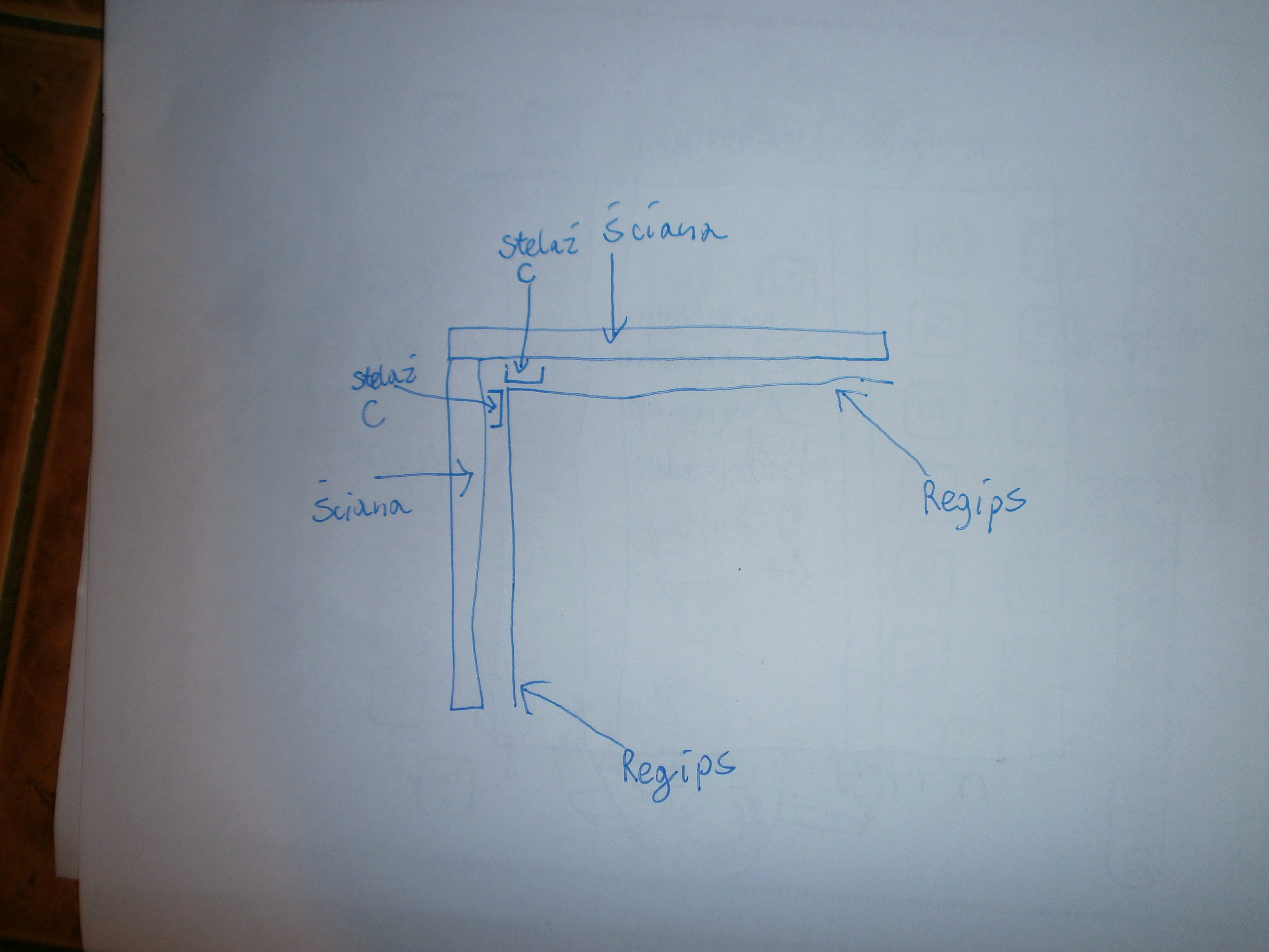

    You mount the U-profile on the ceiling. From this you "lead out" the riser and install two U-profiles on the walls plus the floor. You install C-profiles in the middle. You can also put one C-profile at the same U-profiles on the walls. Then, after screwing the KG, you will have something to screw the next U-profiles to. It is difficult to explain to someone who has not done it.

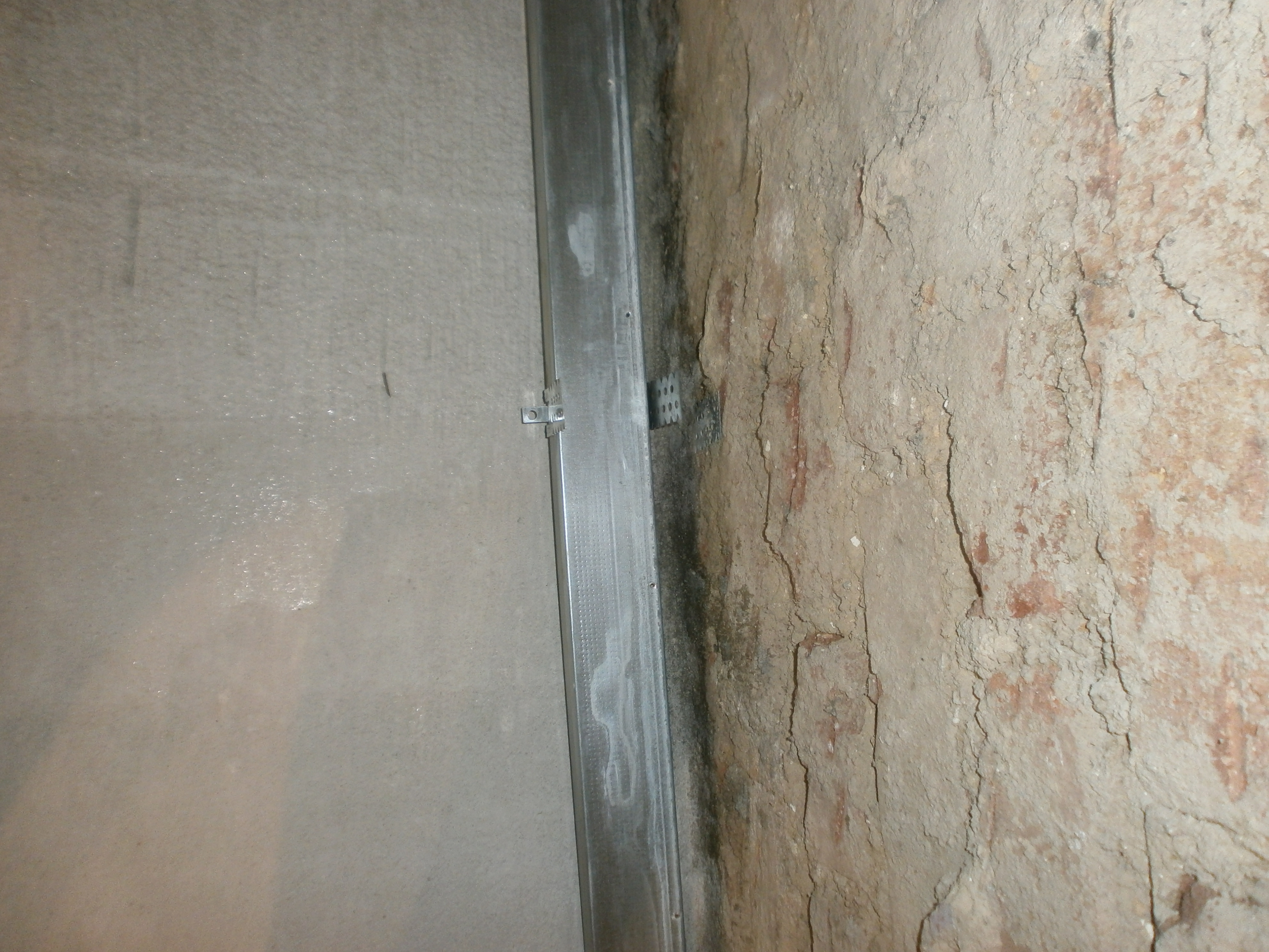

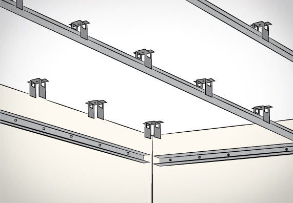

    Kurtka na wacia wrote:
    It will not be a ceiling, but a wall ...
    I figured it out, but you have ceiling profiles, if I'm not mistaken - CD60 is the main ceiling profile that matches the width of the escutcheons.
    Theoretically, the wall can be placed on the ceiling profiles, but you need to give more grooves and possibly cover it twice with the board.
    In your case you are making the ceiling on the wall, the main CD60 profiles should be every 40 cm, on each main profile also every 40 cm.

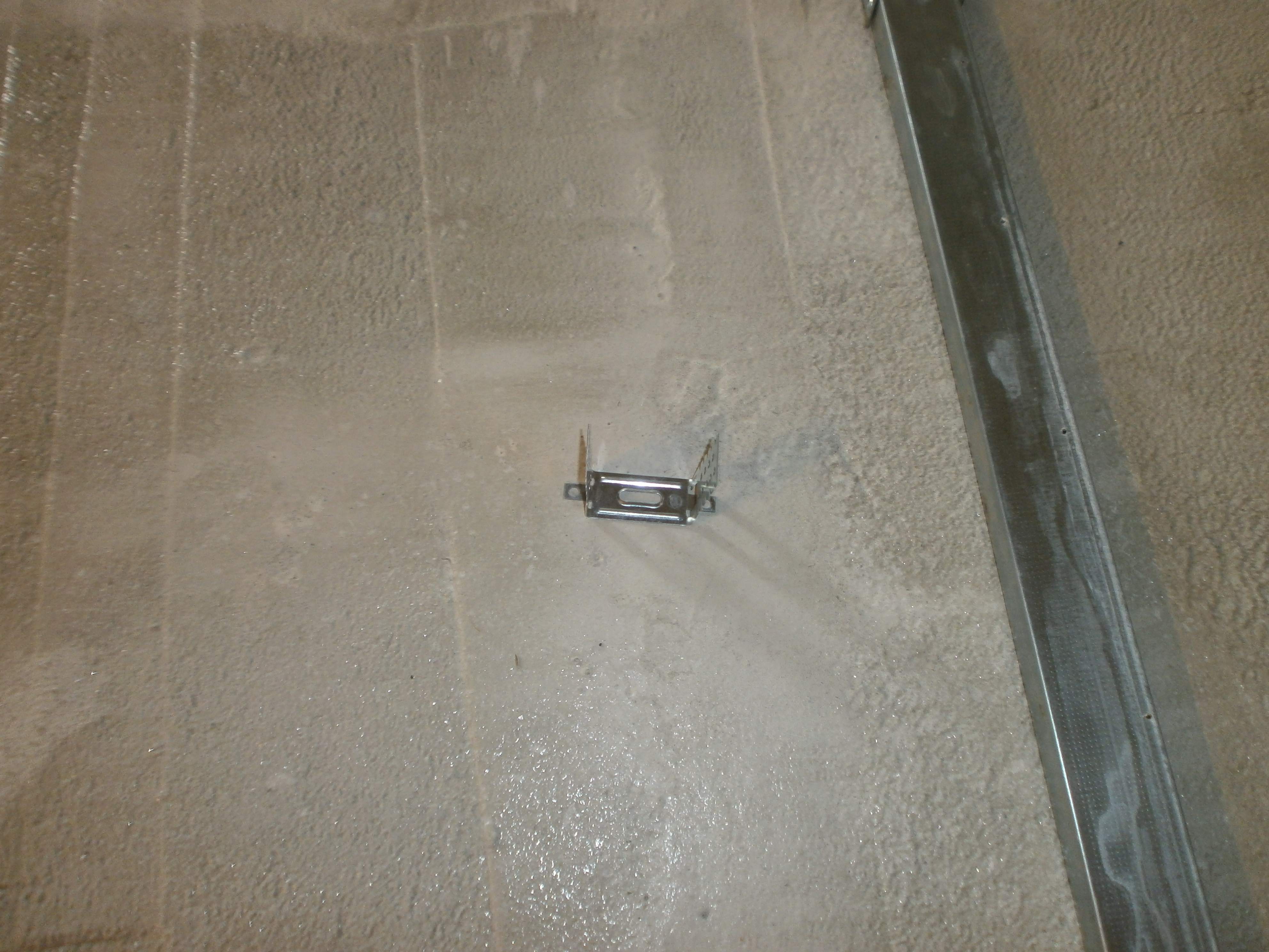

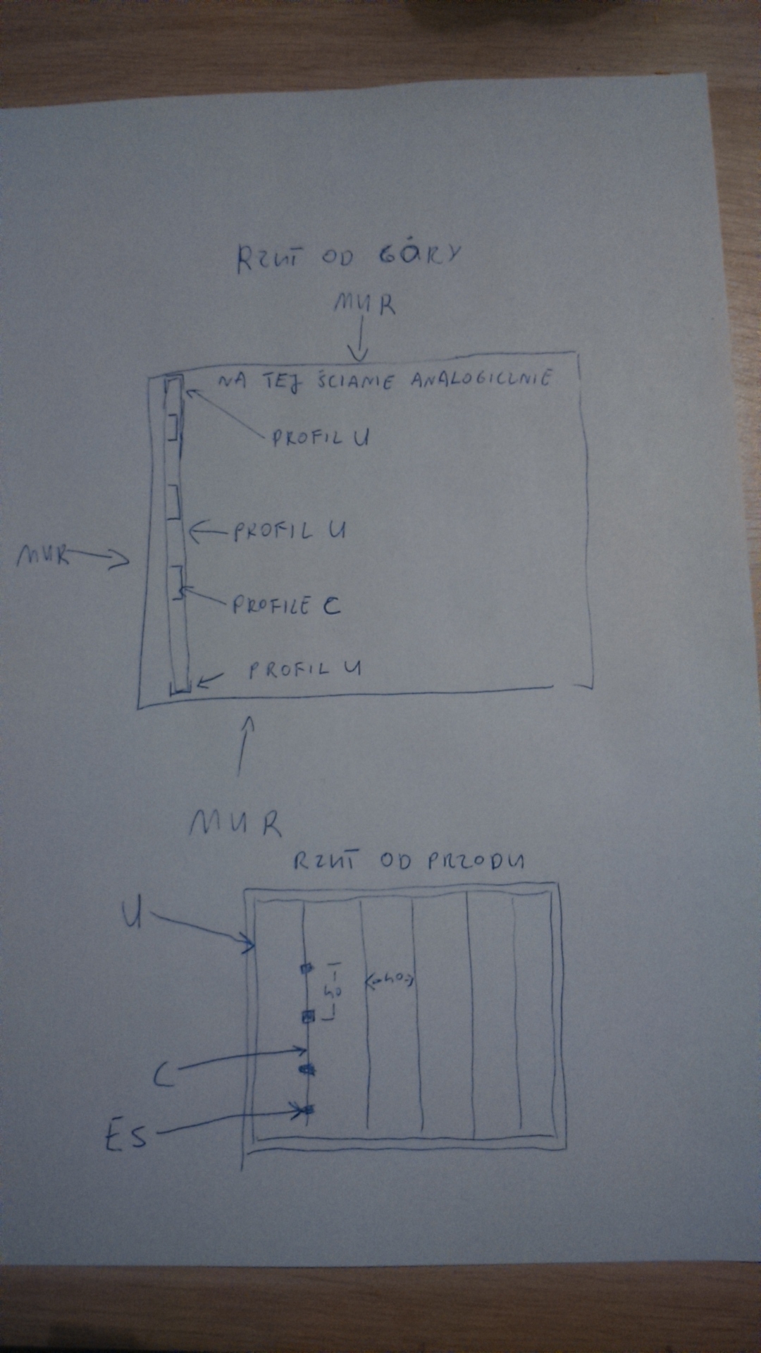

    ... My doubts are raised by U left and right profiles. They will only be attached at the top of the ceiling and floor. And in the middle? ..
    Why is this so?
    There is just no wall to pin it?
    Edit:
    In the last photo from your first post, on the right, the wall is, what's the problem?

    First, close one wall with the plate, then turn the next profiles to the plate. This is it?

    And why can't there be profiles against the wall?

    So screw the first cd profile 4 cm from the wall, close it with a plate. Start next wall from u30 to previous wall to first profile cd, etc.
    Ok. I can handle it. Come on, that's not what I mean ...
    But I will do as you advise. First, one wall, then bolted to the board. Come to reduce the room by the width of U + regips.
    Precisely because it is not possible to screw C to the handle (esa) in such a tight place - in the sense in the corner, it was invented that there is a U profile pinned to the wall, and the plate is turned to it.
    And don't worry about the surface, it won't get smaller. It will be the same with both solutions.
    Edit:
    On the other hand, if you want there to be no U but C attached to the esa next to the walls, you can do it.
    After assembly, plastering, etc., the strength of the wall in this place, with this method of assembly, will not be much lower.
    Problems will arise when screwing the board, the C profile supported by esami only on one side may bend when screwing the screw, you need to strain a little to catch it to the board, and when you succeed, give the screws densely (every 10-15 cm) to the previous one held the profile until the next one was screwed.
