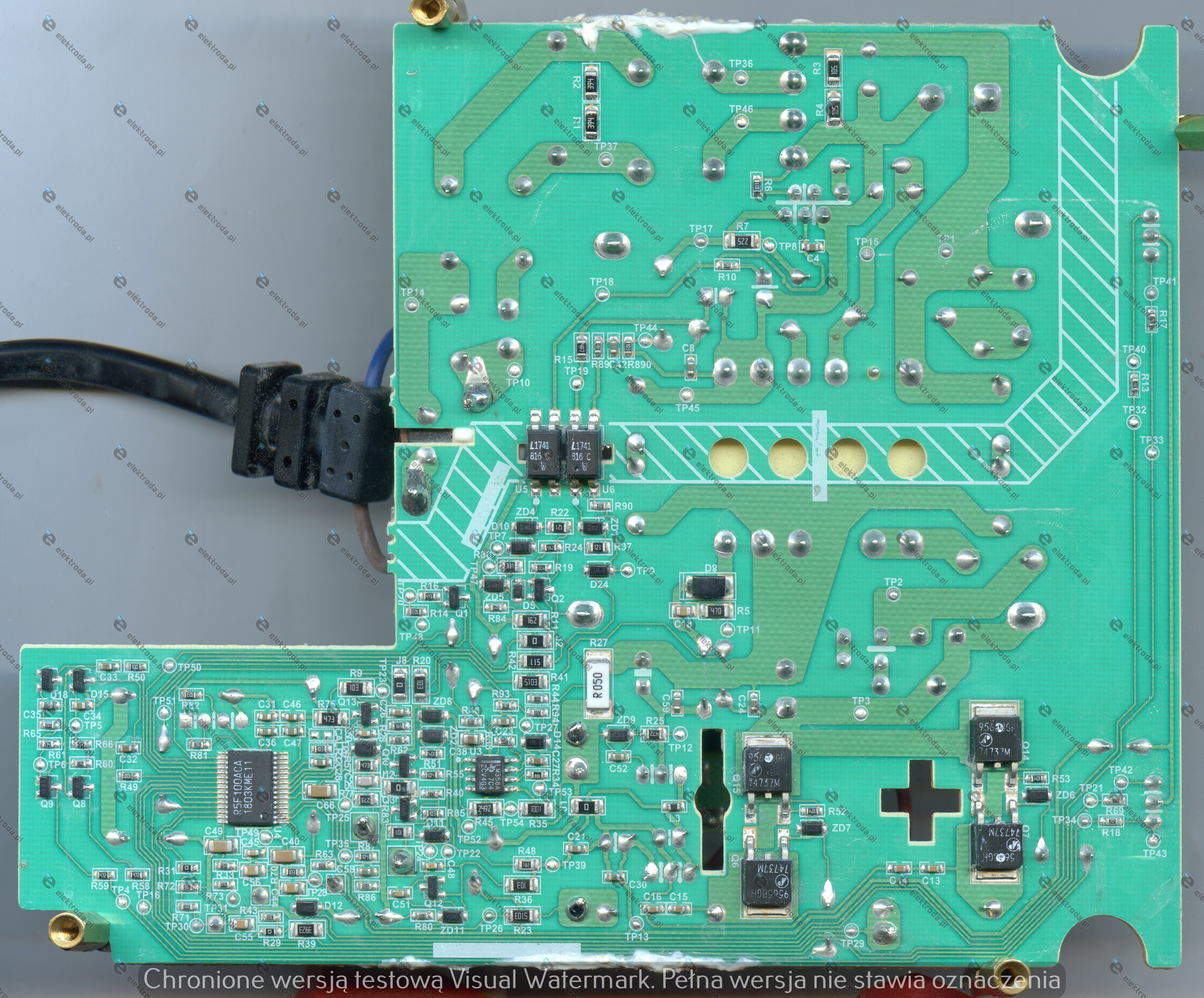

    Does anyone have a diagram of this charger? After introducing the steel chips into the housing, I changed the appearance and I can not figure out what is what in the field of standard elements such as resistors, diodes, capacitors, etc.

    Hello. Insert a picture of what it looks like after these steel shavings?

    I did an inventory of resistors and zener diodes. It should come in handy (Marking on the resistor in parentheses)
    R21 47 Ohm 5%
    R12 68 k 5%
    R8 51 Ohm 1%
    SMD resistors
    R18, R13, R17 620Ohm (621)
    R69 520 Ohm (521)
    R52, R53, R46, R51, R55 100K (104)
    R58, R59, R25, R14, R87 4.7K (472)
    R75, R76 MEASUREMENT - 57K (01D) 100K
    R91, R89, R36 1K (102)
    R40 1K (01B)
    R56, R84 27K (273)
    R66, R65 2.2K (222)
    R60, R61 510K (514)
    R57 5.1K (512)
    R71, R72, R70 200K (30D)
    R31, R47, R33, R29 200K (204)
    R49, R50 10Om (100)
    R16, R95, R23, R86, R81, R15, R85, R24 10K (103)
    R22, R94 10K (01C)
    R93 measurement -25K (48C) 30.9k?
    R88 0 (000)
    R82 2K (202)
    R30 20K (203)
    R73 measurement - 740K (01E) 1M?
    R74 measurement - 380K (58D) 392k?
    R45 measurement - 40K (59C) 40.2k?
    R83 100Ohm (101)
    R1, R2, R3, R4 470K (474)
    R7 4.3M (4304)
    R6 measurement - 6.4K (79B) 6.49k?
    R10 8.2om (8R2)
    R101 47Ohm (470)
    R90 2K (202)
    R28 330Ohm (331)
    R92 82Ohm (820)
    R20 ???????????????????????????
    R27 510Ohm (511)
    R43 measurement -25K (39C) 24.9k?
    R44 measurement -33K "check" (58D) 392k?
    Zener diodes
    ZD1 18V
    ZD2 ???????????????????????????
    ZD4 39V
    ZD5 4.7V
    ZD6, ZD7 16.7V
    ZD8 5.1V
    Q1, Q2, Q4, Q10, Q11
    1 AM 4 (NPN)
    Q8, Q9
    HK (NPN)
    Q5 Mosfet
    D18, D20
    A7 Z
    Can anyone identify the ZD2 diode ????? and the resistor R20 ?????.
    In the thread "Milwaukee M12-18C, component identification"
    https://www.elektroda.pl/rtvforum/topic3385980.html#16768999
    There is a photo but the resistor marking is not visible and it is best to measure the diode.
    I suppose that ZD2 will be 20V because it is to stabilize the voltage of 22V and in addition there are 0.65V drops, diode and 1.4V optocoupler, hence 22V- 2.05V 19.95V?
    And the R20 resistor looks like 820Om designation (8200) connected in series with 330Om ??????????
    Below is a photo
    Milwaukee M12-18C charger power supply - I am looking for a diagram
    One AOD413A mosfet was also replaced with TO252 AP9567GH,
    both PC817 optocouplers,
    TOP258YN chip blew up
    resistors R8, R20 ????, R92, in R27 the inscriptions burned.
    the zener diode ZDE2 evaporated
    For R20 I gave 820 Ohm and the zener diode 20V. I haven't turned it on yet, I'm waiting for help.

    Dear gentlemen, I would like to add that the charger was previously tortured by a fachman, which is why it was in this condition.
    With R20 820? elements, the Zener ZDE2 20V diode, the charger started charging one battery, but on the other one the TOP driver burned down again. The second time I also replaced the R12 68k? / 5% resistor and in its place I put two 150k? MŁT in parallel. Now she has two batteries charged and looks like GIT.
    The voltage at the output of the converter is 21.75 V, and the 18V batteries charge up to 20.7V.
    As soon as the charger plugs into the socket and then removes the plug, I will insert the batteries immediately after removing the plug. Then the charger freezes and you have to wait about 10 minutes before it detects the battery again. [and] Do they have that?

    Resistor R20 is 82?.

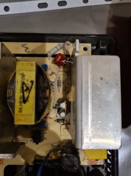

    Hello, I have a problem with the above charger, the batteries are charged for a very long time. I do not know if the problem is the missing capacitor that broke off the board and I have a request if someone could tell me what the value of the c42 capacitor should be.
    • Milwaukee M12-18C charger power supply - I am looking for a diagram 20210213_110733.jpg (1016.23 KB) You must be logged in to download this attachment.

    THANK YOU. capacity is 100nf
    A colleague probably made a mistake Q8 and Q9 is not the HK symbol, but the RK or N mosfet.
    What is the value of this capacitor
    Only the touched fell out of print. One leg is burnt.

    >>20606687
    This MKSE capacitor has a value of 472/630V, i.e. 4.7nF/630V.

    I am attaching a photo in higher resolution.
    Milwaukee M12-18C charger power supply - I am looking for a diagramM12-18..jpg (11.01 MB)You must be logged in to download this attachment.
