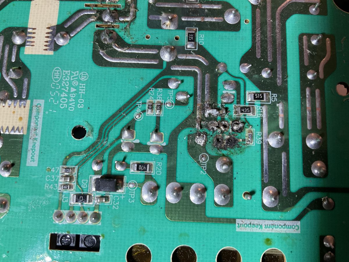

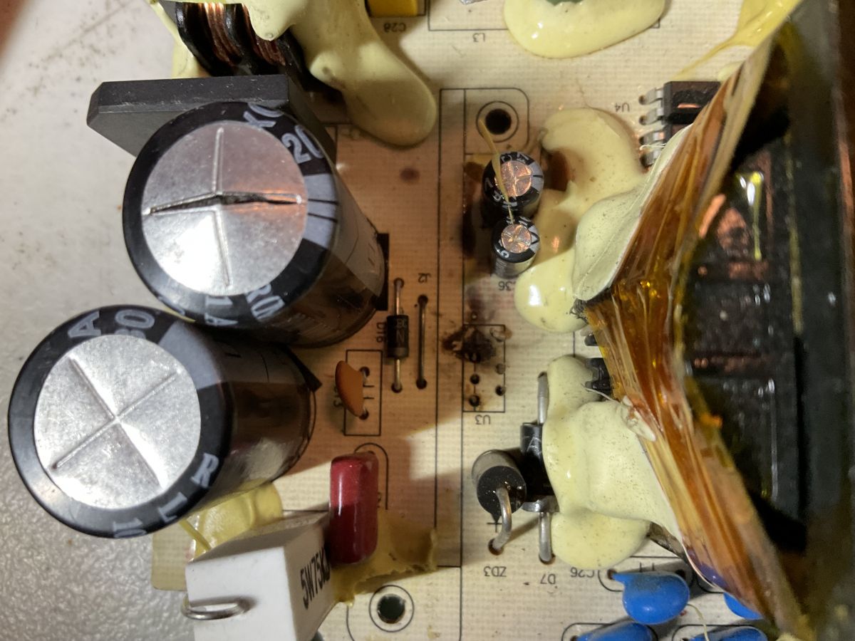

    Hi all,
    I have this plate with the U3 burned out, appreciate any feedback about Part number or substitute.. Damaged circuit board with a burned-out component labeled U3. Close-up of a green circuit board with a burnt component labeled U3.

    Probably TOP256. The 100uF electrolytic capacitor is also damaged.
    There are quite a few topics on the Forum dedicated to this charger. Just type the model in the search engine.Regards.
