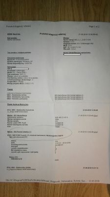

    Hi,
    PASSAT B6 VAR (3C) TRENDLINE 1.6 cat. 75kw 5-G + LPG
    Moving from the lights came on 4 lights as in the subject + right wheel brake error (I have no error code).
    Diagnosis of the VW service in Opole:
    - Replacement of the ABS pump as indicated by error 810 (008) - costs 8,000
    VW diagnosis attached.
    The car drives without any problems, ABS also reacts.
    The friend cleared the errors and found the ankle unhooked at the right caliper from the handbrake (electric). After plugging in, the errors disappeared and after exceeding 20 km / h they returned again.
    I will only add that currently:
    - the brakes work properly (a friend checked the pressure and it's ok) also while driving
    - no disturbing symptoms can be seen.
    - clearing errors by disconnecting the battery did nothing
    Please help ;)

    ABS pump for replacement.
    Brake pressure sensor defective.

    Can't regenerate? Replace the sensor with a new one?
    Is it possible to mount an ABS pump from another vehicle, in the sense does the pump number have to match the current one?

    After replacing the ABS pump, the fault resolved.
    PLN 600 with replacement.
