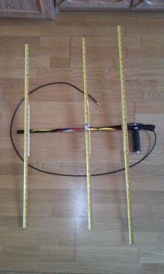

    Baofeng UV-5R Setup & Operation: Step-by-Step Guide for Emergency Services Frequencies in Zamość
    I made a yagi for myself and with baofeng I eavesdrop on the conversation of hams on satellite repeaters and I listen to the ISS's communication with the ground and receive SSTV from them. This proves its range.

    Radiokiller, can I see correctly that the antenna is made of a tape measure? You can provide a link to the project because this design has interesting performance. Can you insert a clearer photo?
  • #25 17249077
    Radiokiller
    Level 30  
    Posts: 1299
    Help: 156
    Rate: 236
    It's made of a tape measure.
    Patience, I will soon throw in a link to the description. The antenna received the SSTV broadcast from the ISS even when the space station was 4 degrees above the horizon.
    I don't know if the author's preference is info on this antenna, it's better not to connect. If not, I will send you to PW.
  • #26 17249095
    adversus
    Level 32  
    Posts: 1607
    Help: 188
    Rate: 597
    buddy, I would be very grateful for any information.
