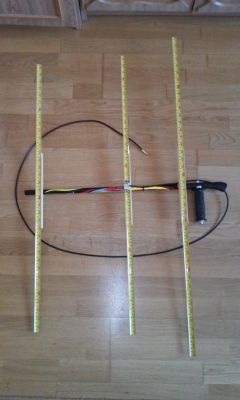

    Make it so for reception (even from the cosmos).
    Baofeng UV-5R Antennas: Best Options Under 200 PLN for Increased Range & Stationary Use
    The cost is low and a lot of fun.
    If you are interested, I will give you more information.

    Radiokiller showed a great project, but the author of the topic should answer the questions, because maybe he only wants to buy due to the lack of opportunities for handicrafts.
    In addition, the antenna must be converted to a given frequency, because it is rather not broadband.
    Convert - as much as possible. If you have already assembled yours, try to pick up something 70 cm long. You will be surprised positively. :D
