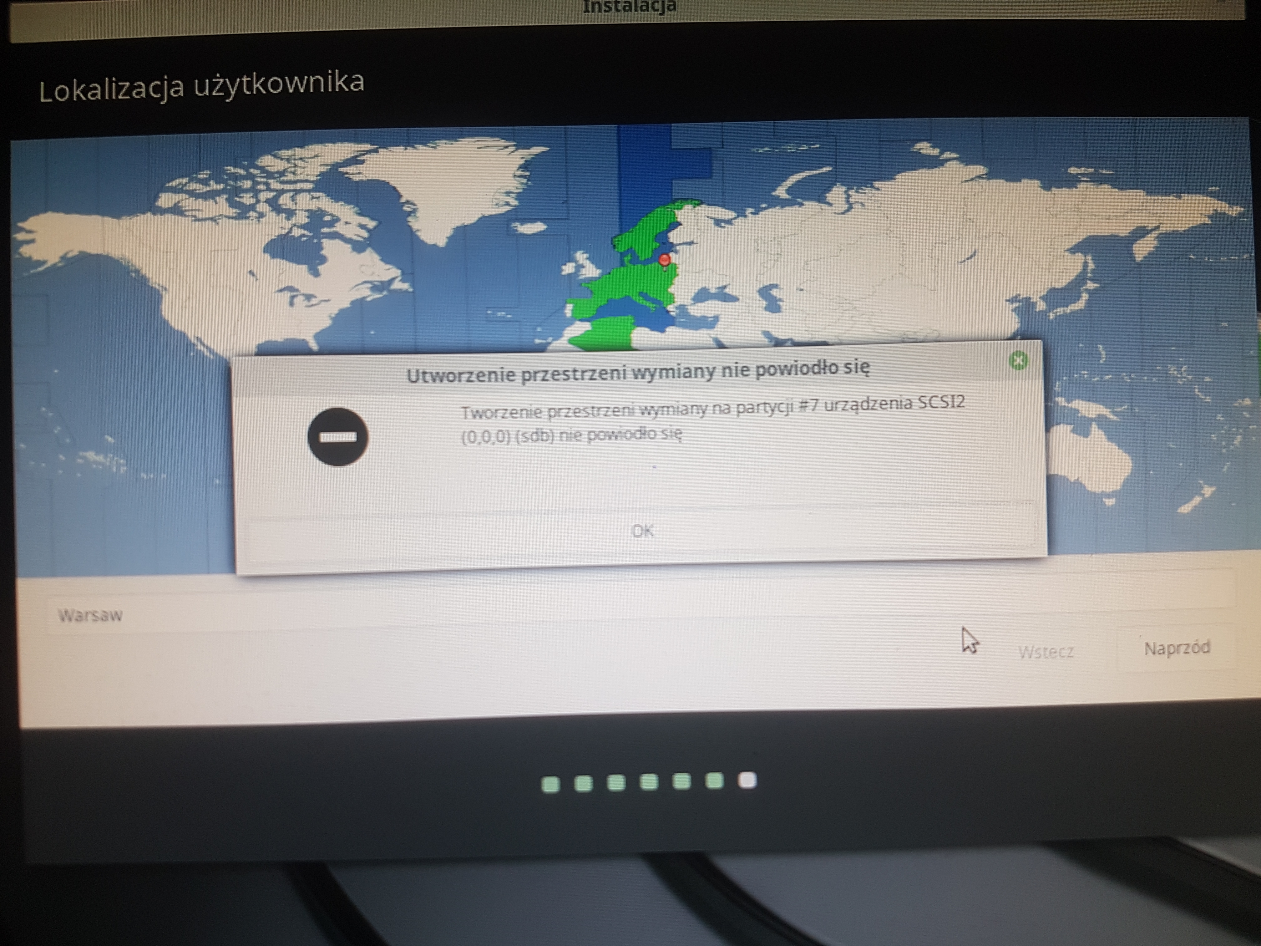

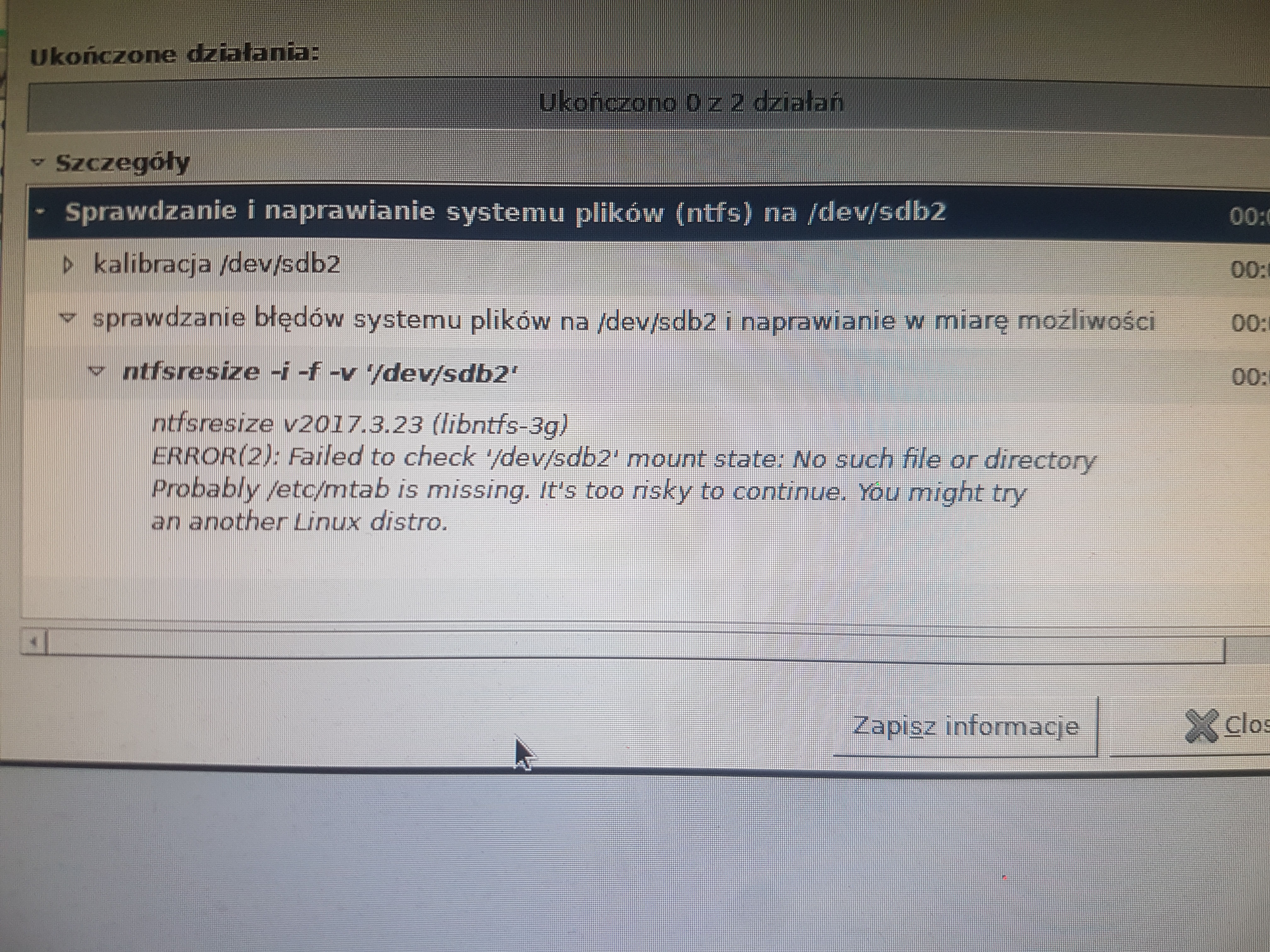

    I have a 1 TB WD Caviar Blue drive as storage and a 128 GB SSD on Win10. I have allocated 100GB of free WD space to install linux. In the installer, I come to the point where I have to partition the disk, share 100GB on / boot, /, swap and / home and set the boot installation point to WD. When I click Install it goes on and crashes the error: "Creating swap space on partition # 7 of SCSI2 device (0,0,0) (sdb) failed." When, after several unsuccessful partitioning attempts, I gave up and tried to use 100GB of pod / I got an error: "Creating sdb5 partitions of SCSI2 (0,0,0) (sdb) device failed." After such unsuccessful attempts, it returns me to partitioning again, only that on all partitions on the computer a mount point / home or / or something else pops up (different things in different approaches), the most interesting is that 100GB is partitioned, but then the installer resets because I don't want to mount the whole computer under / home :) . In GParted you can also see that this 100GB is divided. I would like to add that after such a procedure, Windows does not show the disk because something is wrong, I have to remove the DMDE partitions and again the disk works in Windows. It also takes me back 2 hours in Win. The problem occurs when installing Linux Mint 18.04 LTS and Ubuntu 18.04.1 LTS. About 2 days ago, when I wanted to install Lubuntu 18.04 LTS, the partitioning went without a problem, but it crashed another error during the installation, so I crashed it. I will add that logical partitions, and when I tried to create 1 primary, the same popped up.

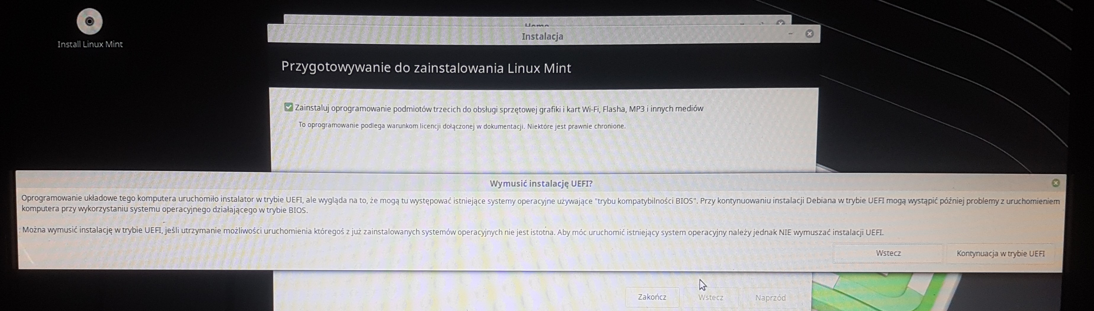

    Additional info
    HDD: MBR
    Boot: UIEFI and CSM enabled

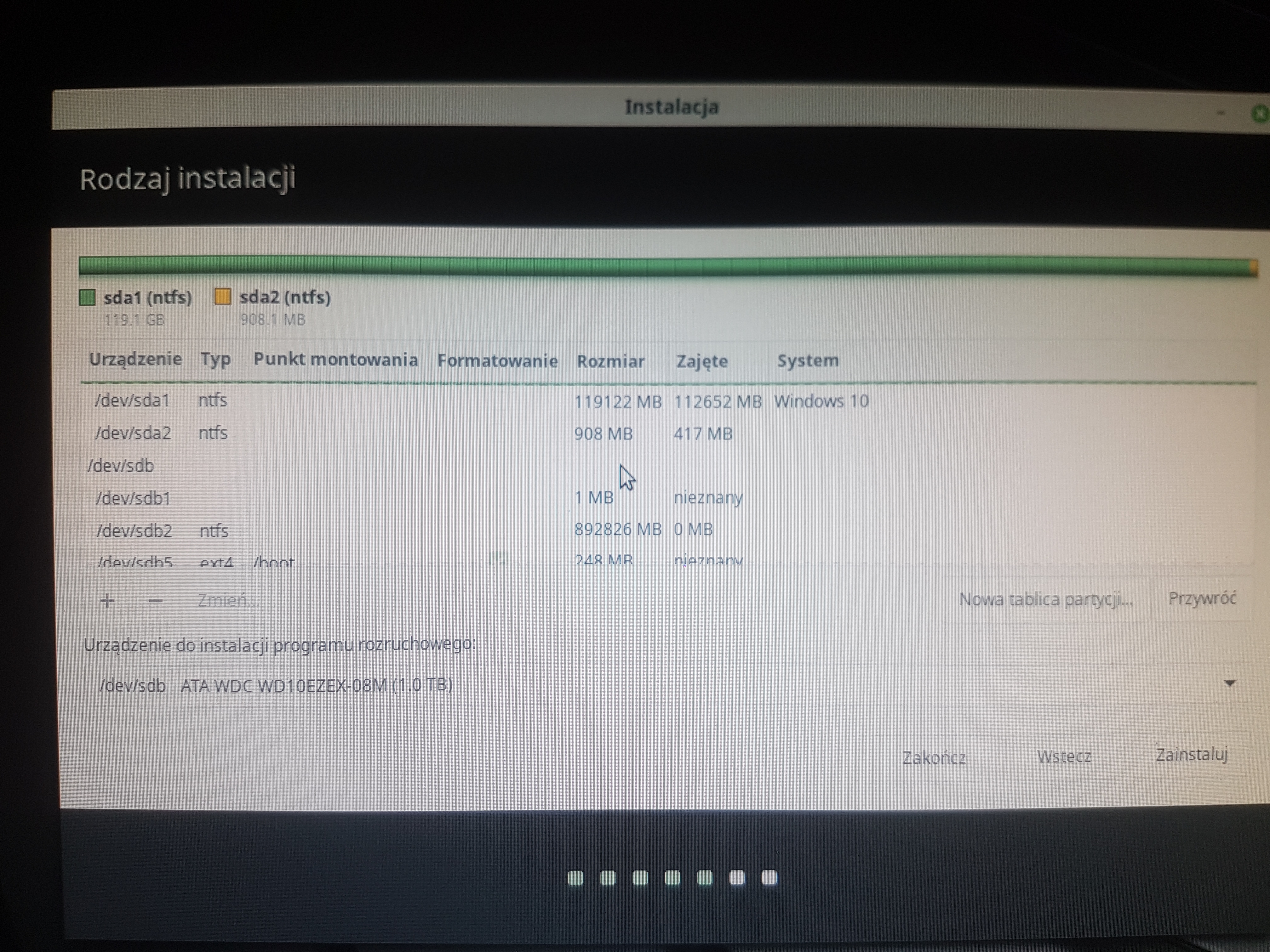

    How it installs:
    1. I choose the language and other crap
    2. Something like this pops up
    - Linux Installation: Error in Partitioning 1TB WD Caviar Blue & 128GB SSD on Win10 (sdb, SCSI2)
    3. I click back
    4. I click "Use a different solution"
    5. Allocates unallocated space into partitions
    - Linux Installation: Error in Partitioning 1TB WD Caviar Blue & 128GB SSD on Win10 (sdb, SCSI2) - Linux Installation: Error in Partitioning 1TB WD Caviar Blue & 128GB SSD on Win10 (sdb, SCSI2)
    6. I click Install and ... error.

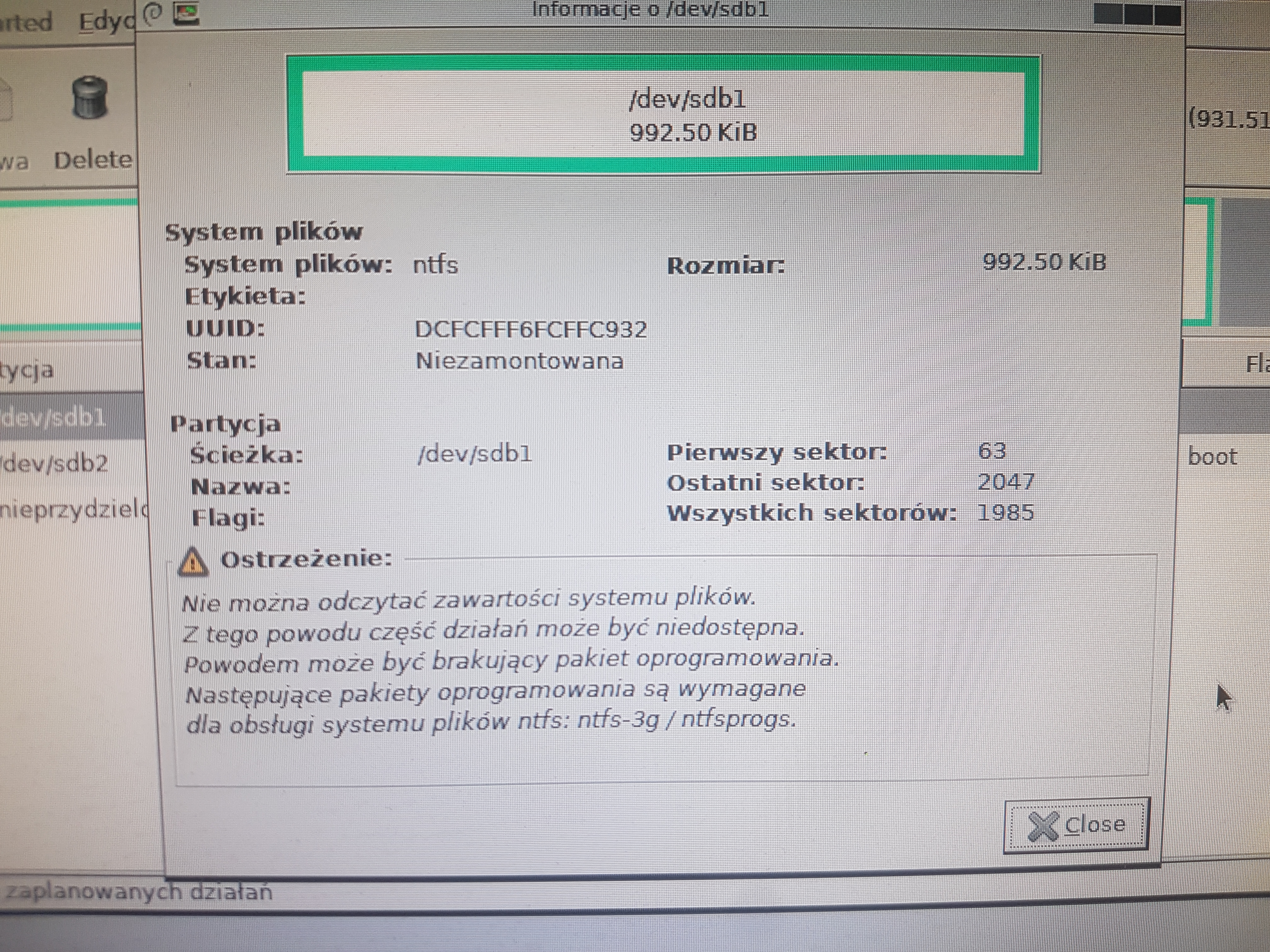

  • #6 17419124
    WojtasJD
    Posts: 13788
    Help: 2919
    Rate: 1586

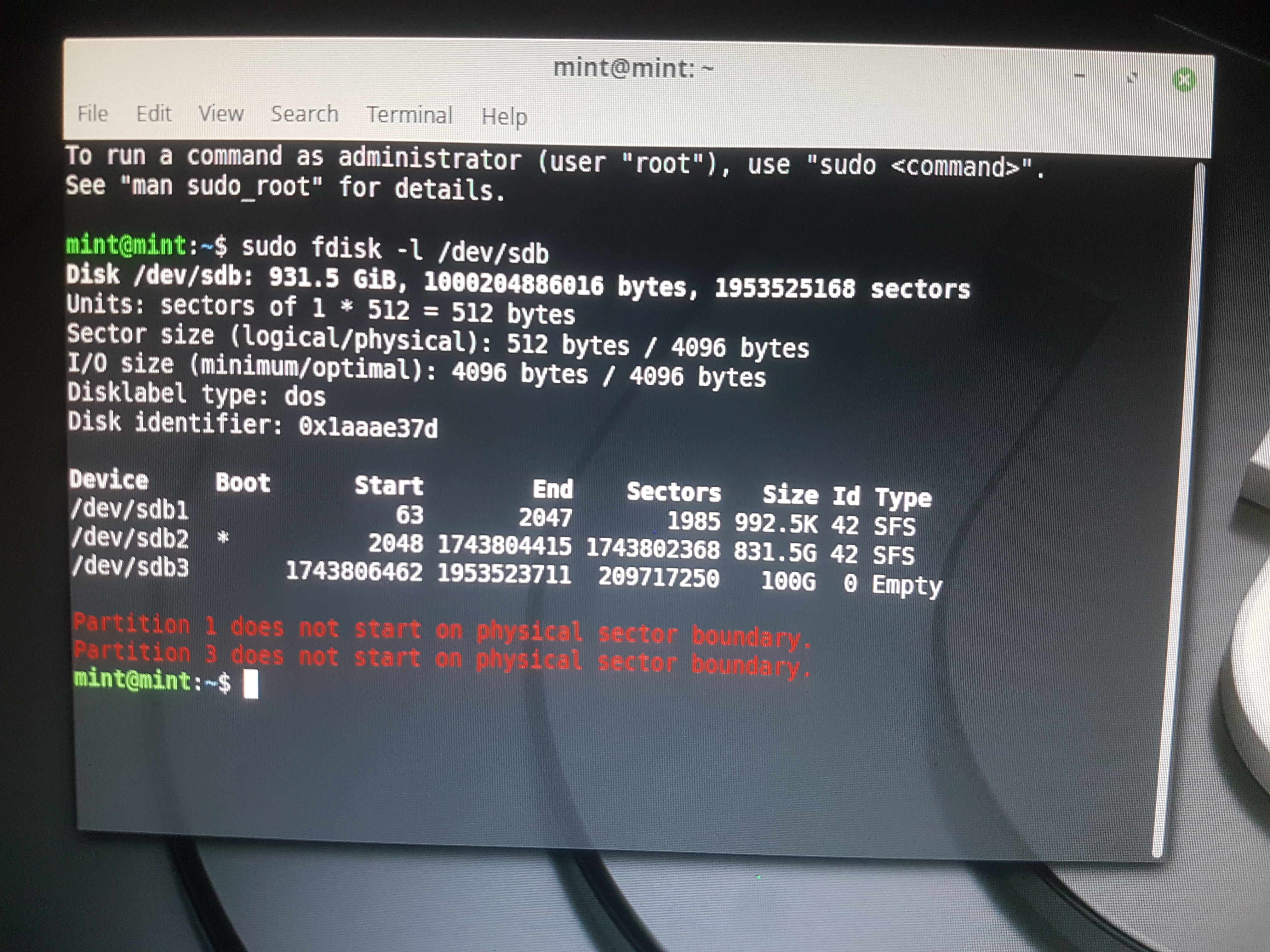

    IMO installer has some problem recognizing partitioning on HDD:
    / dev / sdb1

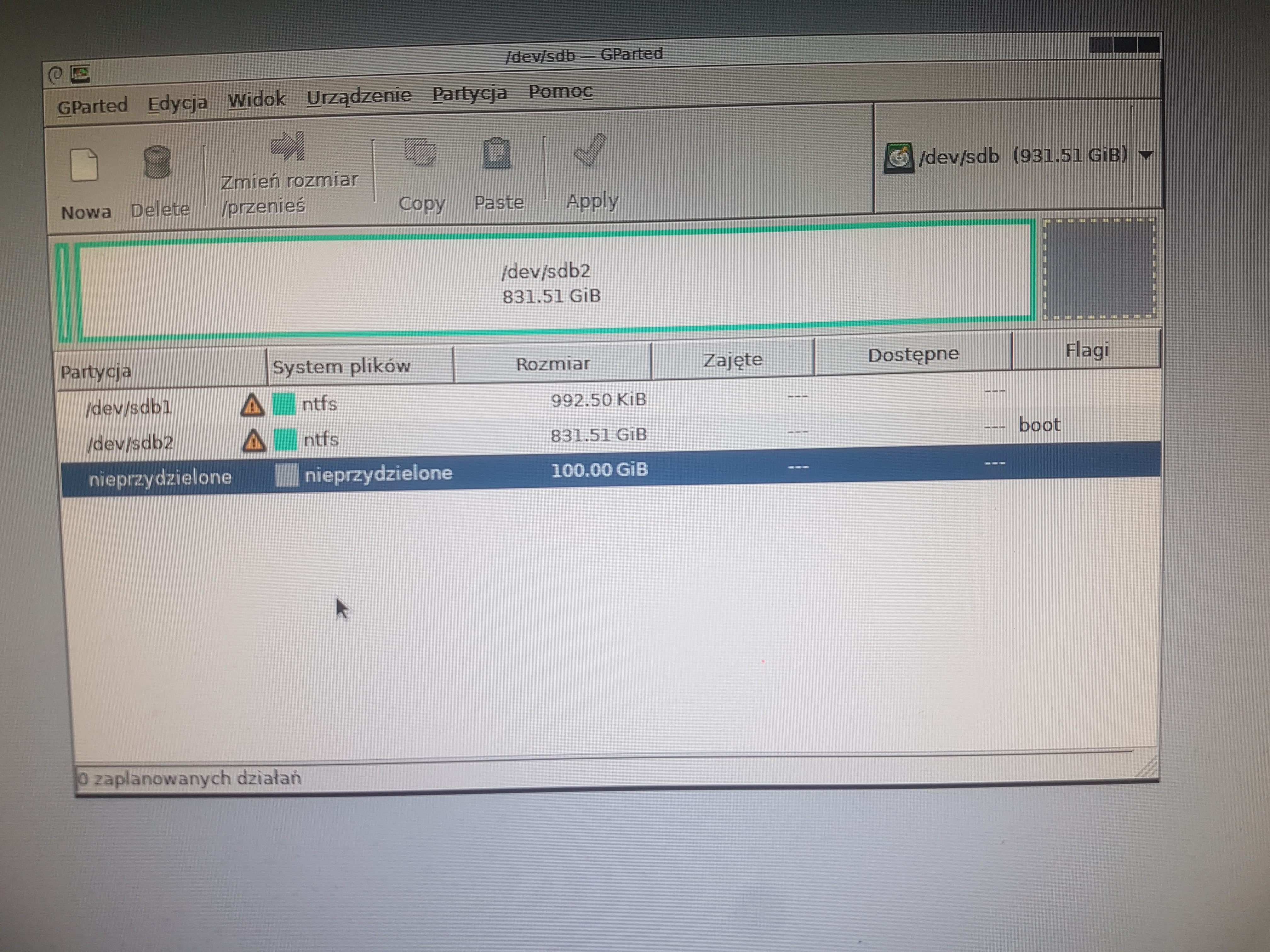

  • UEFI partitioning screenshots from fdisk and gparted

    I know about HDD, I did it on purpose.

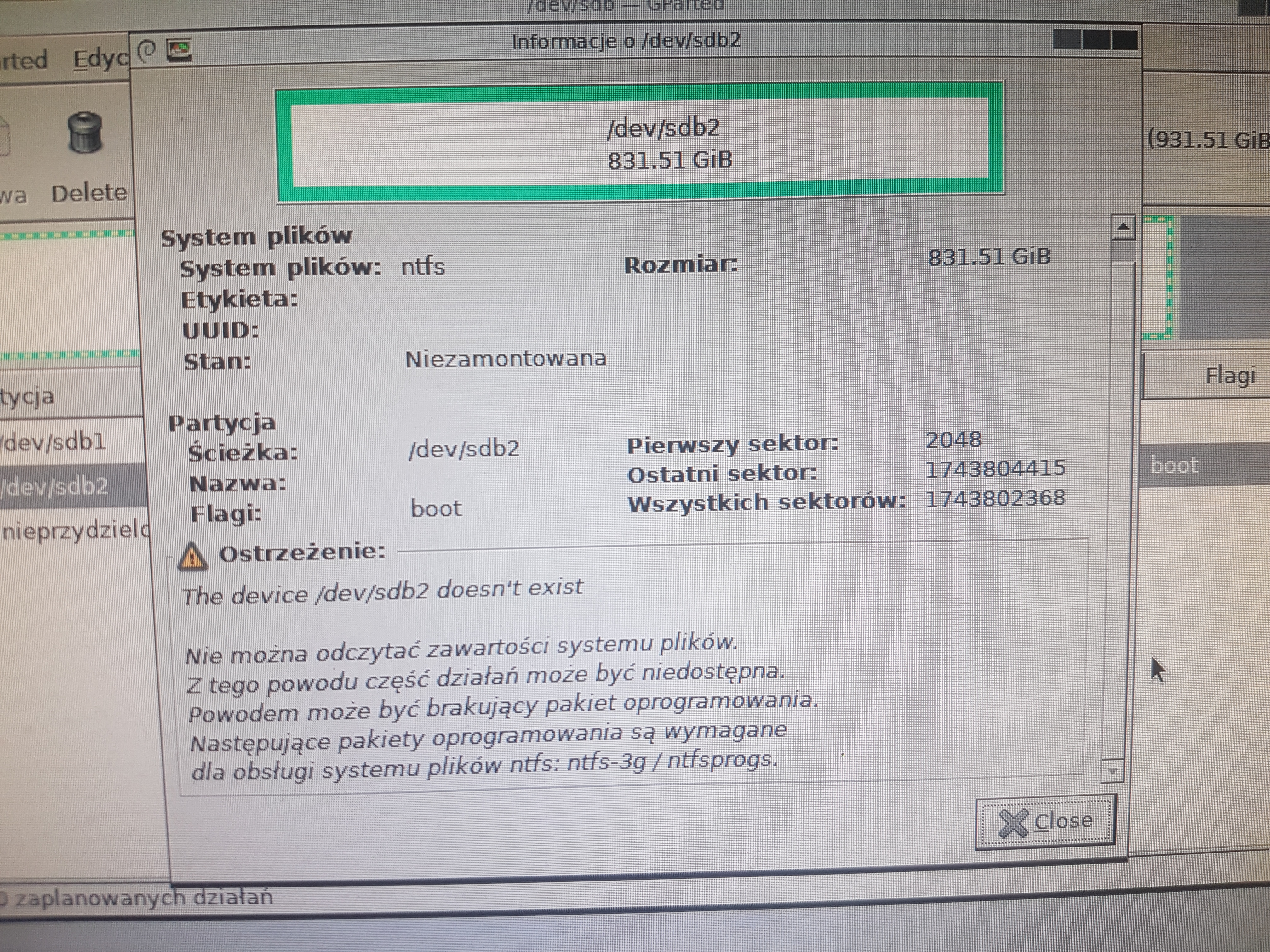

    I fired in UEFI to see if it could go in this mode.
    fdisk and gparted:
    - Linux Installation: Error in Partitioning 1TB WD Caviar Blue & 128GB SSD on Win10 (sdb, SCSI2) - Linux Installation: Error in Partitioning 1TB WD Caviar Blue & 128GB SSD on Win10 (sdb, SCSI2) - Linux Installation: Error in Partitioning 1TB WD Caviar Blue & 128GB SSD on Win10 (sdb, SCSI2) - Linux Installation: Error in Partitioning 1TB WD Caviar Blue & 128GB SSD on Win10 (sdb, SCSI2) - Linux Installation: Error in Partitioning 1TB WD Caviar Blue & 128GB SSD on Win10 (sdb, SCSI2)
    #8 17425002
    WojtasJD
    Posts: 13788
    Help: 2919
    Rate: 1586

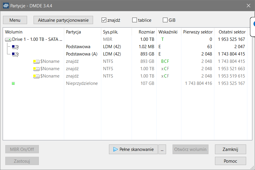

    Oh, you have a dynamic disk

    DMDE from Windows
    Restore MBR partition layout with basic and extended volumes

    WojtasJD
    Posts: 13788
    Help: 2919
    Rate: 1586
    If you previously converted the disk to dynamic because at some point the HDD had 4 parts. basic or 3 + ext. and you wanted to add another one in DMDE:
    - [MBR On / Off]
    - insert as part. basic MBR vol. NTFS with the range LBA 2048 - 1743804415 and if there is any Windows that is to start on its own, activate it
    - from LBA 1743804416 to the end of HDD, create part. extended and create log disks in it. to "/", "SWAP" and "/ home" and "/ boot" if they are to be separate.
