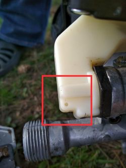

    Hello, I have a Parkside pressure washer, from which water began to drain. attached photos from which exactly places, namely the two holes that are marked on the photo. Anyone advise something? Parkside PHD 110 A1 Pressure Washer: Water Leakage Issues & Advice - Photos Attached Parkside PHD 110 A1 Pressure Washer: Water Leakage Issues & Advice - Photos Attached

    Replace this part with a new one, there will be no leaks.

    Take a look at this theme . A common cause of defect in these washers is usually caused by poor storage of equipment, low temperature and water do their plus fatigue, which is apparently of poor quality.
    Search by name PARKSIDE PRESSURE SWITCH
