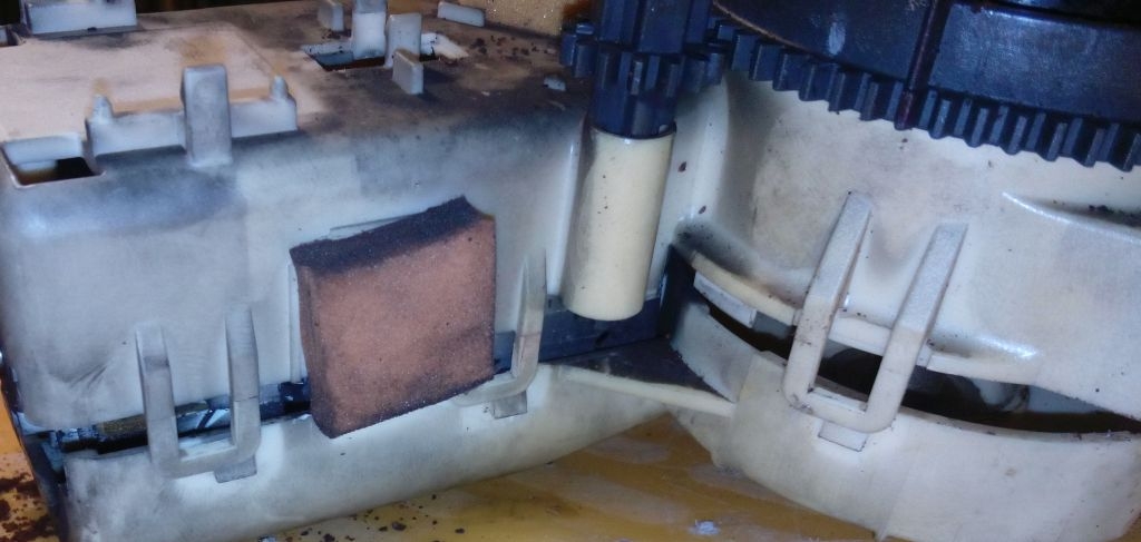

    Hello !
    Thank you for your reply, regarding the grinder.
    Unfortunately I only found a moment today to take the coffee machine apart.
    Unfortunately my mill has different markings than the one pictured in the document.
    Siemens EQ7 TK76209RW05 coffee machine - the grinder is smoking coffee
    I have aligned the white indicator marked on the pinwheel with the indicator on the housing, but I don't know if this is the correct setting.
    Do you have any other idea or maybe this setting is correct?
    Thank you in advance for your suggestion.
    Regards
    Piotr

    In mills, the calibration consists in setting the so-called zero point.
    The burr is twisted until both parts touch. Then, while turning the burrs, return the ring until the burrs no longer rub against each other.
    This is the zero point at which the burrs almost touch, and at this setting the grind is finest.
    This is how gastronomic class grinders are calibrated, you can also try them in an automatic coffee machine.

    pasted a picture of the grinder (setting the gears).
    Note the markers on the grinder wheel and knobs (the markers on the small sprocket and grinder wheel are expected to align).
    In my case, the red marker of the wheel will reach the marker on the housing (the arrow is drawn) and I cannot turn the grinder wheel any more - it is twisted to the max.
    For use, I turned the wheel markers (green and red) to be at the height of the knob (small rack) and the grinder had coffee satisfactorily (although these settings differ a bit from the instructions), the most important thing is that the "quality control" - the wife is satisfied (she was satisfied :) , but you can set the coffee tighter (the red mark closer to the arrow), then the grinder will grind the coffee finer.
    As for the coffee grounds, my wife says they were always dry.

    In your case, the sprocket is beautifully marked. I have no red and green indicator. The indicators on the housing are. On the gear wheel, the only indicator is one of the teeth painted gray graphite (like a pencil). If I put this tooth and the indicator on the casing, I think they were too thick. I'll have to do trial and error checking a few settings.
    When it comes to coffee waste, I don't have lozenges, but "coffee mud". There is a lot of water in the coffee grounds container, although I have replaced and lubricated all the seals. In addition, I noticed that after making coffee, the coffee grounds do not fall into the container, but stick to the plastic tray and during the next brewing they are pressed between the tray and the casing of the machine (the front inner wall of the machine), where it all drips down. In general, everything is splashed with coffee inside, after a few days it starts to moldy, practically every third day I have to wash the entire interior of the coffee machine. This is starting to irritate me and I am thinking about buying a new coffee machine and it will probably not be Siemens, I got a bit offended. If I remember correctly, I didn't have any dry lozenges (coffee grounds) from the beginning, it was rather a wet paste. I think I have a first generation brewer, later changes were made and maybe here is the problem. It is a pity that Siemens did not replace the users of this brewer, a similar situation is with the milk frother, which has been improved, I have the first clamped version (the new one is twisted).
    Thank you for your help and comments.
