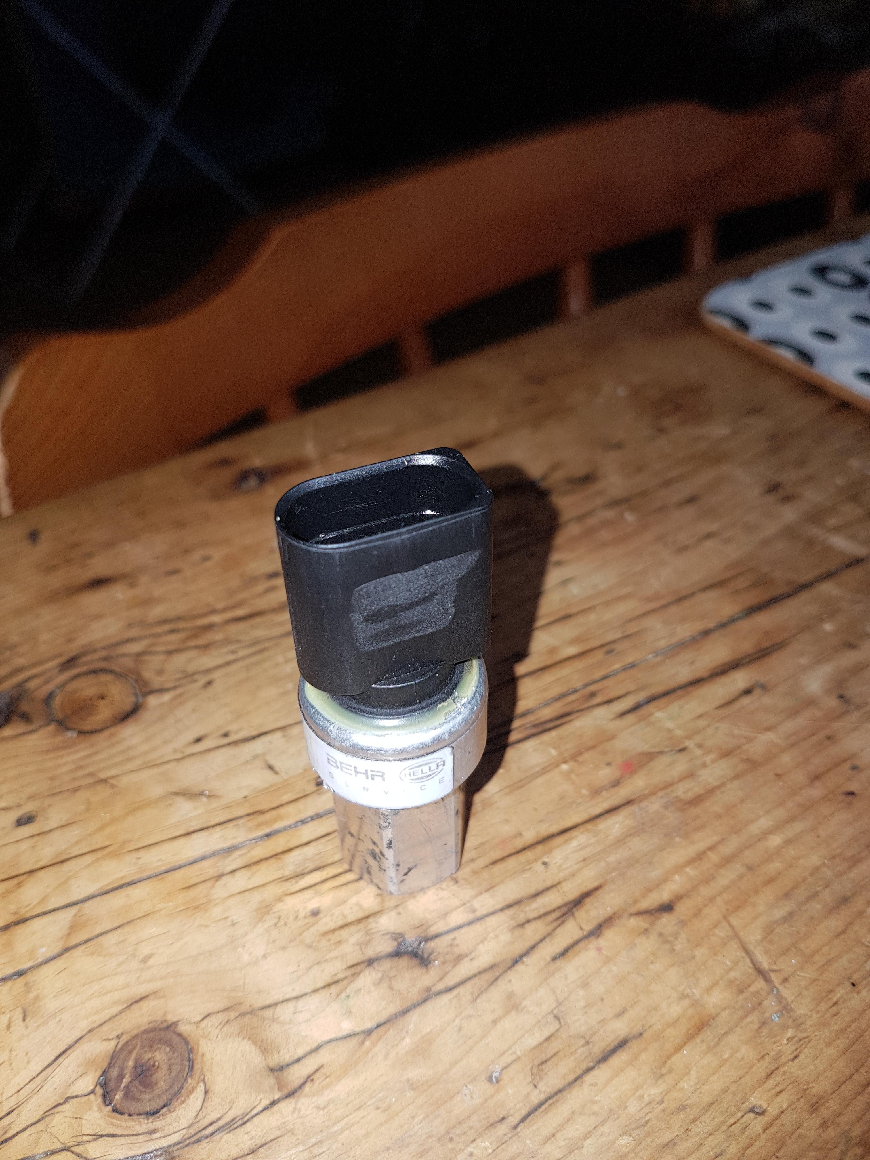

    I have wv touran 2004 2.0tdi
    I was just refilling the gas in the air conditioning. However, the climate is still not working. About four years ago I replaced the pressure sensor (hella) if it is broken again.
    How to check it without buying a new one.
    Thank you for your help

    you need to connect a computer and see what pressure the sensor sees

    And does the compressor work. Variable capacity, i.e. it may be dead.

    Thank you but I was able to find the problem and to say the plug on the pressure sensor is not in contact.
