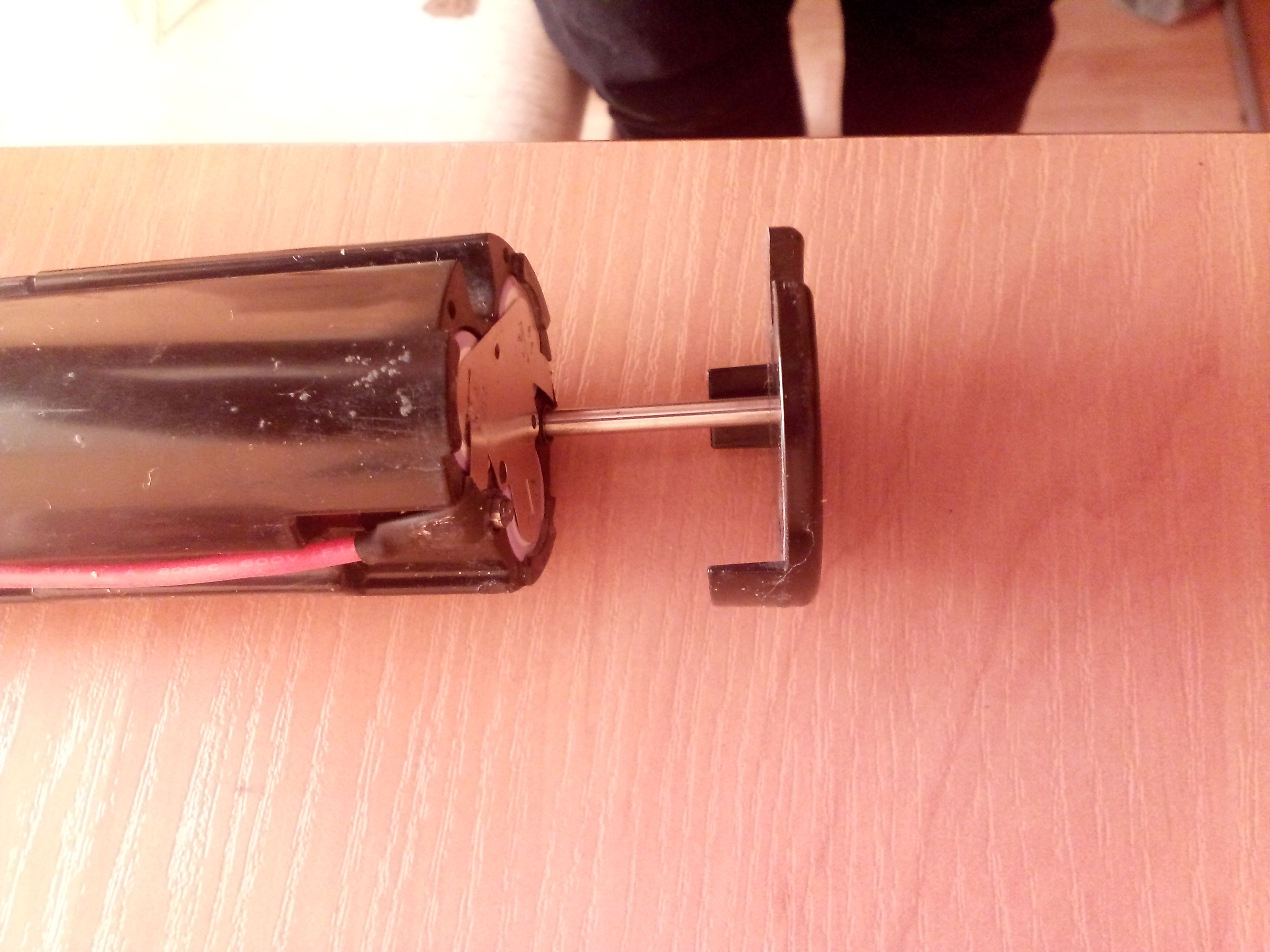

    I have a similar problem with the scooter turning off while driving.
    After changing the battery and releasing without load, the scooter works. When driving on it, it stops working after driving a few hundred meters.
    Any idea?
  • #34 17874420
    jupi1985
    Rate: 10

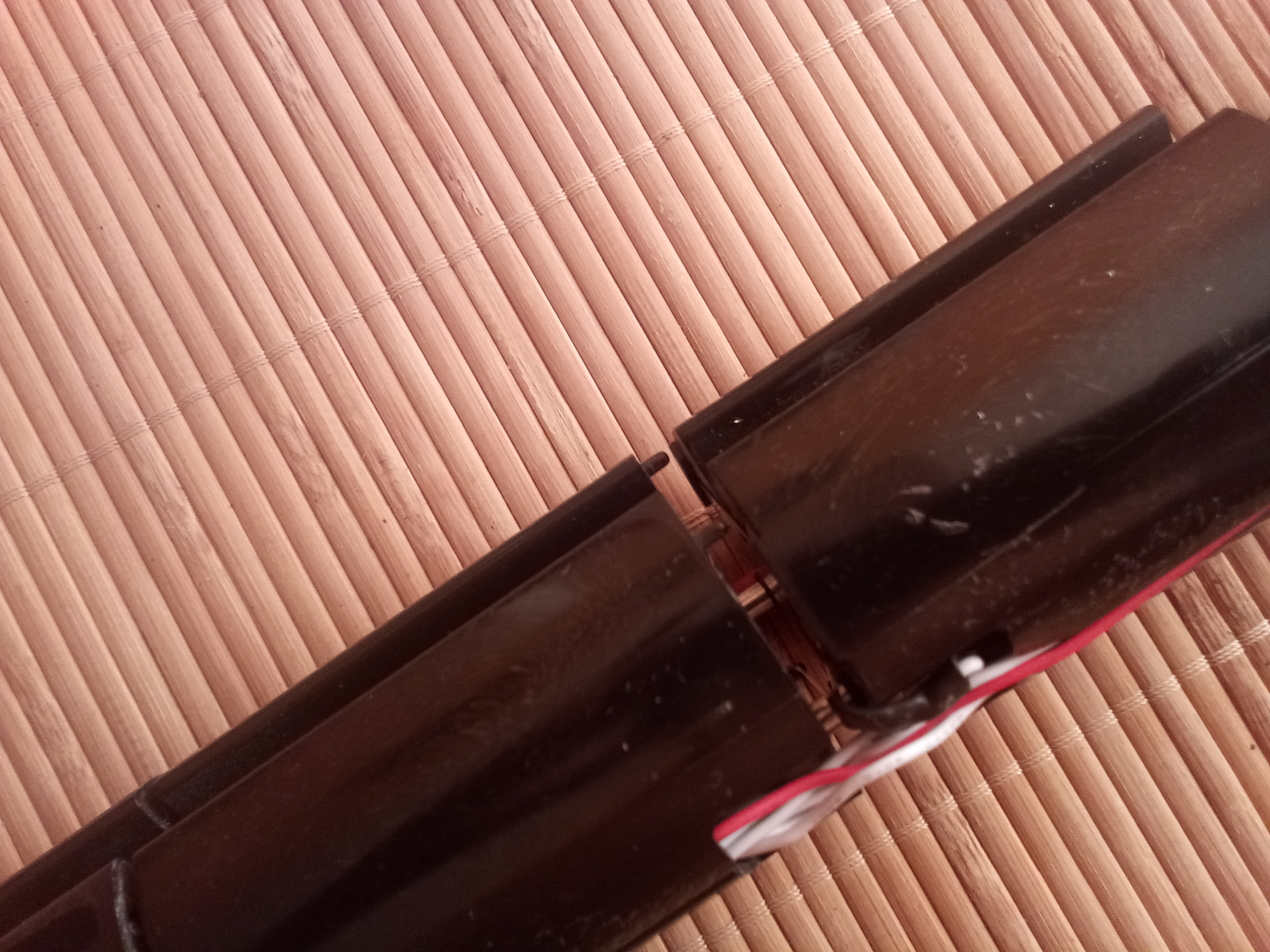

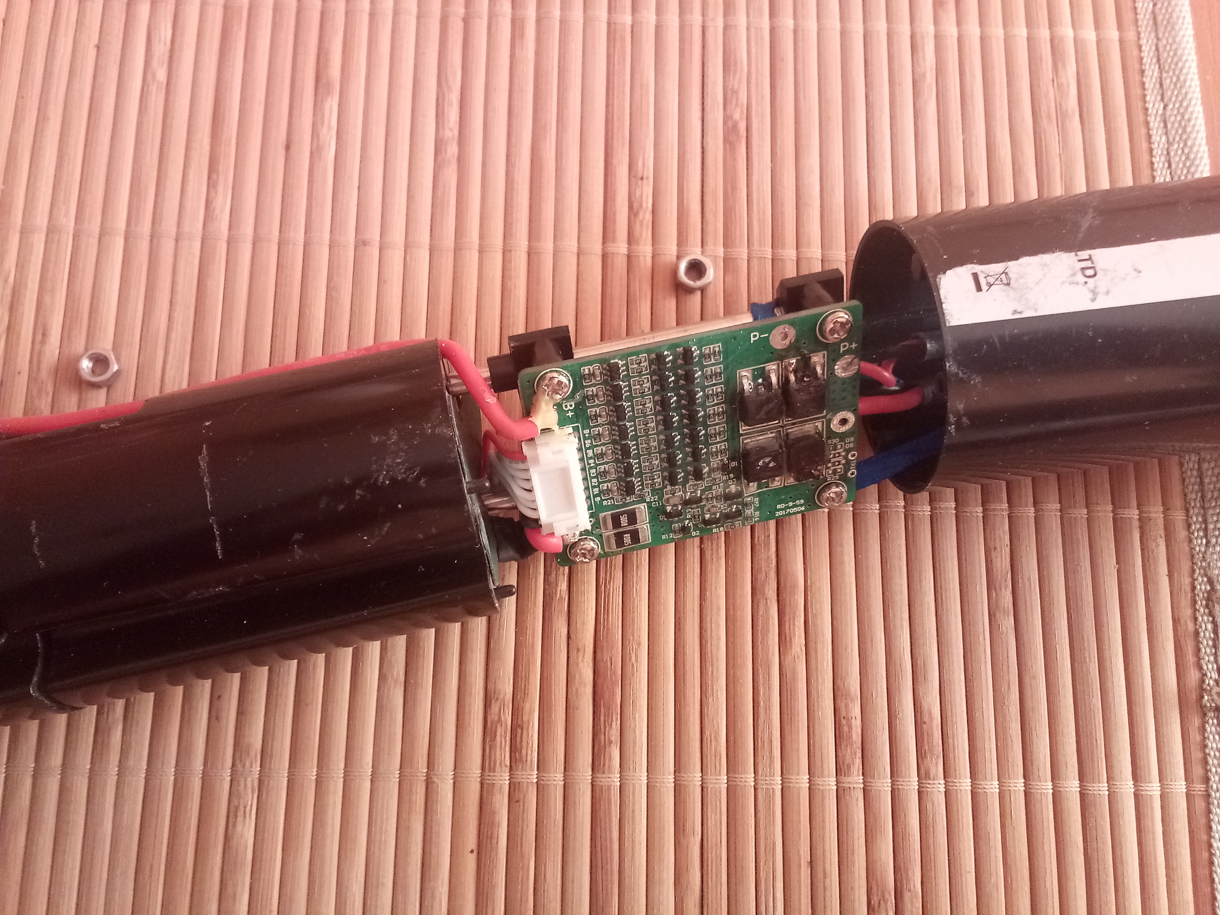

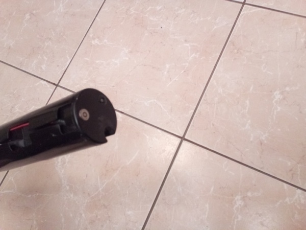

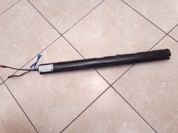

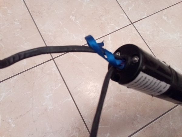

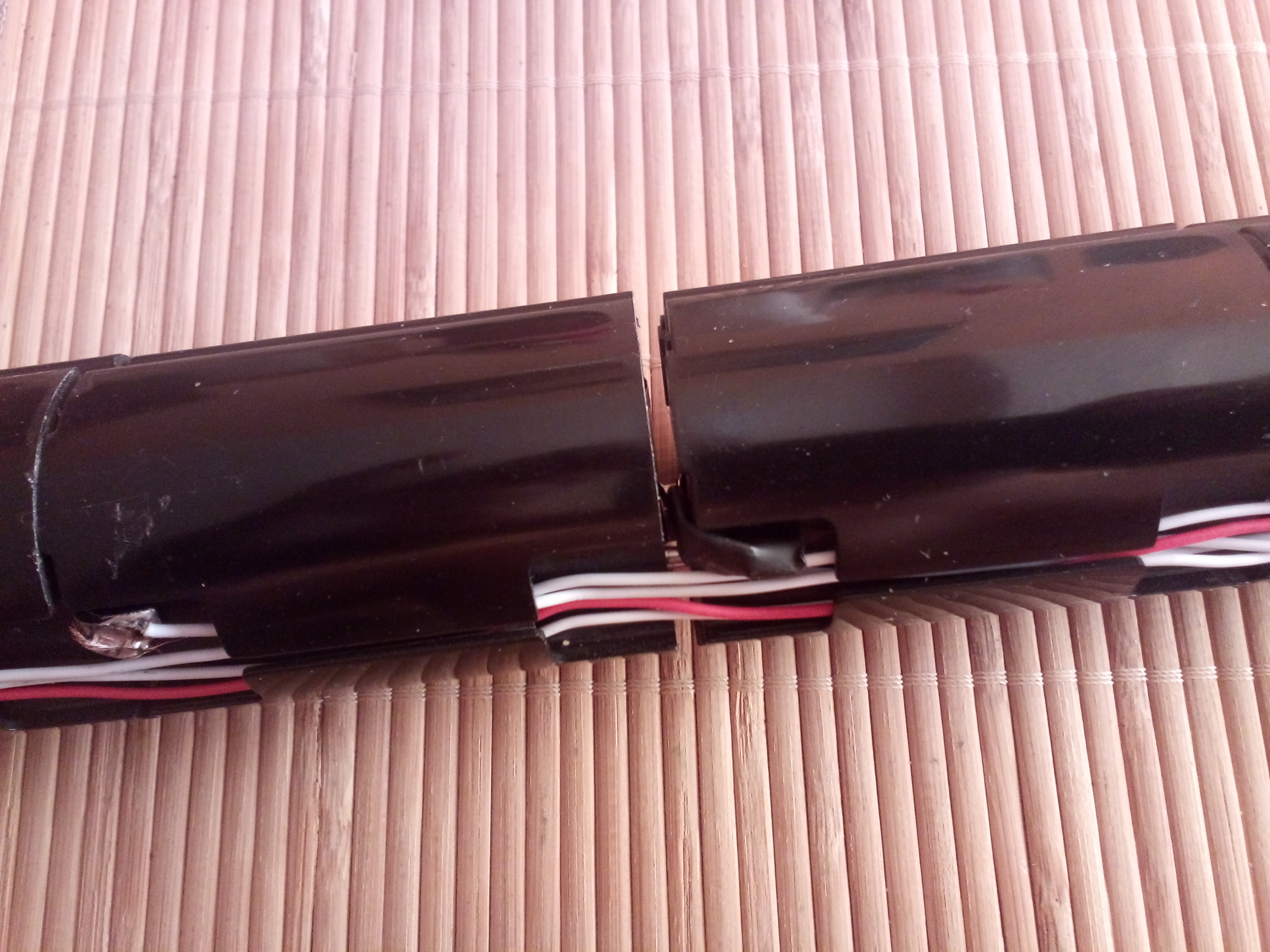

    Goclever Electric Scooter Shuts Down During Ride, Requires Charger Reconnection
    Adam-T wrote:
    jupi1985 wrote:
    Any idea?
    Have you read this https://www.elektroda.pl/rtvforum/topic3472991.html#17575281
    Yes, I saw this post, but it's probably not that, because I have all 8 black bridge links connected to each other and the minus goes across the bridge:
    Goclever Electric Scooter Shuts Down During Ride, Requires Charger Reconnection Goclever Electric Scooter Shuts Down During Ride, Requires Charger Reconnection Goclever Electric Scooter Shuts Down During Ride, Requires Charger Reconnection Goclever Electric Scooter Shuts Down During Ride, Requires Charger Reconnection
    In my case it doesn't work because the scooter suddenly started intermittently shutting down.
    At first everything was fine with it and I drove it almost 200 km.
    I changed the battery for a new one and it's the same. Then it turns off after a few or several meters. I also tried different temperatures, like 20 degrees, 15, 12 and 5 degrees. I also don't know where to look for the cause. Goclever Electric Scooter Shuts Down During Ride, Requires Charger Reconnection Goclever Electric Scooter Shuts Down During Ride, Requires Charger Reconnection Goclever Electric Scooter Shuts Down During Ride, Requires Charger Reconnection Goclever Electric Scooter Shuts Down During Ride, Requires Charger Reconnection
    Fixed:
    I replaced all the bridge connections between the individual 8 batteries with ordinary flexible wires and soldered. I pressed everything and tied it with insulation on both sides. Drives. But this is a manufacturing defect of all these models. The reason is the incorrect fitting of the entire battery section and in the event of a short circuit, the controller turns off the entire traction system. Thanks to this, the scooter suddenly stops driving. Thanks all for your interest.
