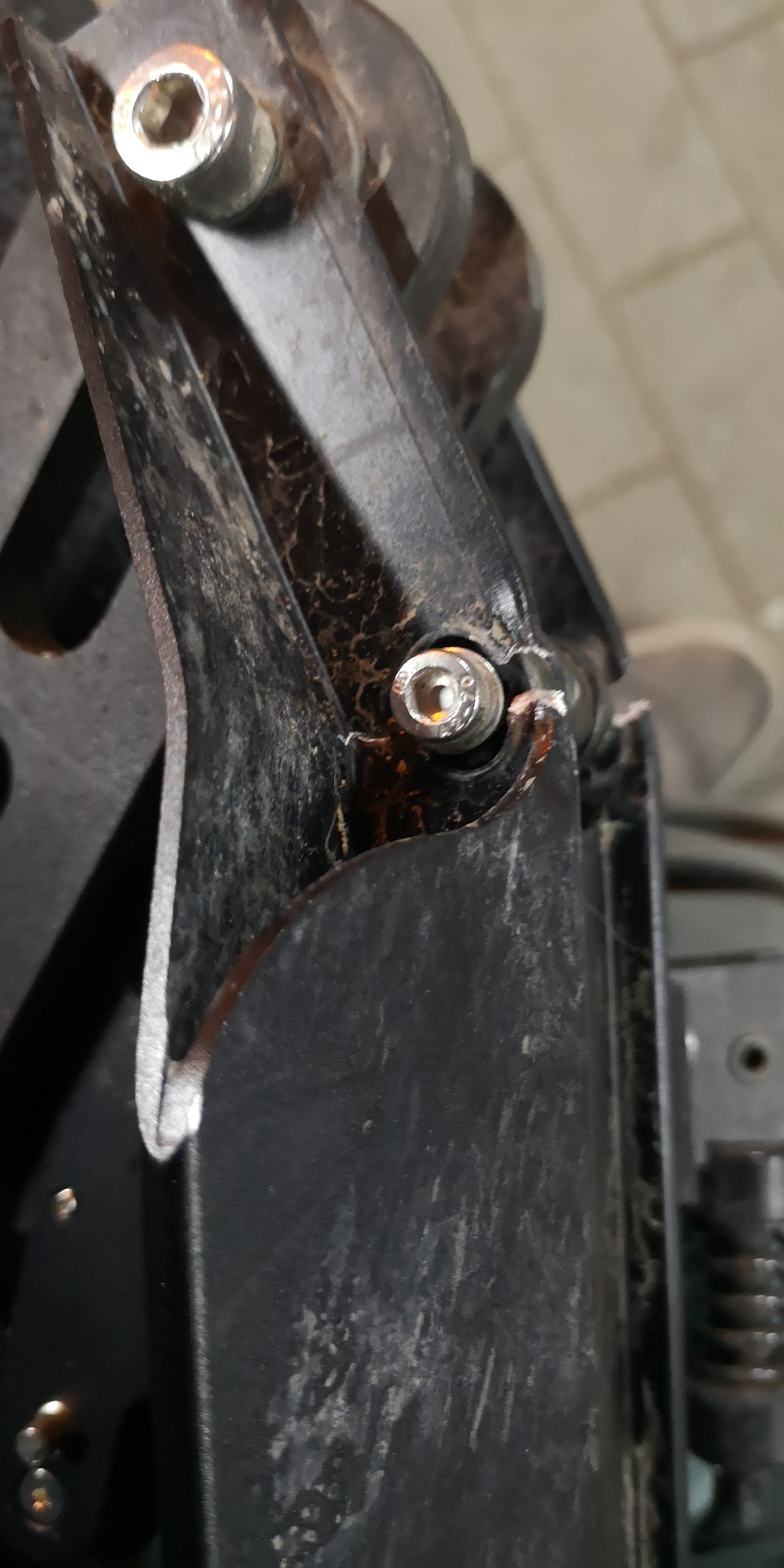

    I will also add another thread about this pseudo-company:
    On the 3rd day of use, the deck of the scooter broke !!!!
    By the way, the question is, is there any electrician's service in Warsaw or around where I can replace the deck with a new, more durable one?
    If not the center, then anywhere in the country? I travel a lot around the country, I can drive with it, and I am determined to have solid equipment.
    I warn you right away with advice and suggestions regarding guarantees and their service.
    As for the warranty, I prefer to avoid it - it was very slow, I will probably hear that it was my fault and they will replace it with a similar deck, which (it seems to me even to a layman) is poor in material. With the rest, she was with them once after the purchase because they sent a damaged display (the monitor was spilled)
    As for the electronics, fortunately it works - still - but the mileage is only 20 km.
    Money thrown down the drain - it's good that I'm fine and it didn't happen at max speed but when I was moving.

  • #26 17620159
    cober101
    Well, still on topic. I solved the problem of the broken deck on my own, but now it doesn't load it. I plug in the power and no response.
  • #27 17620238
    Adam-T
    Posts: 5113
    Help: 834
    Rate: 1096
    cober101 wrote:
    I solved the broken deck problem myself
    did you weld?
  • #28 17626655
    cober101
    Adam-T wrote:
    did you weld?
    No, I replaced it with a new one much more reliable.
