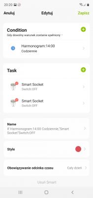

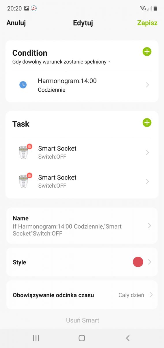

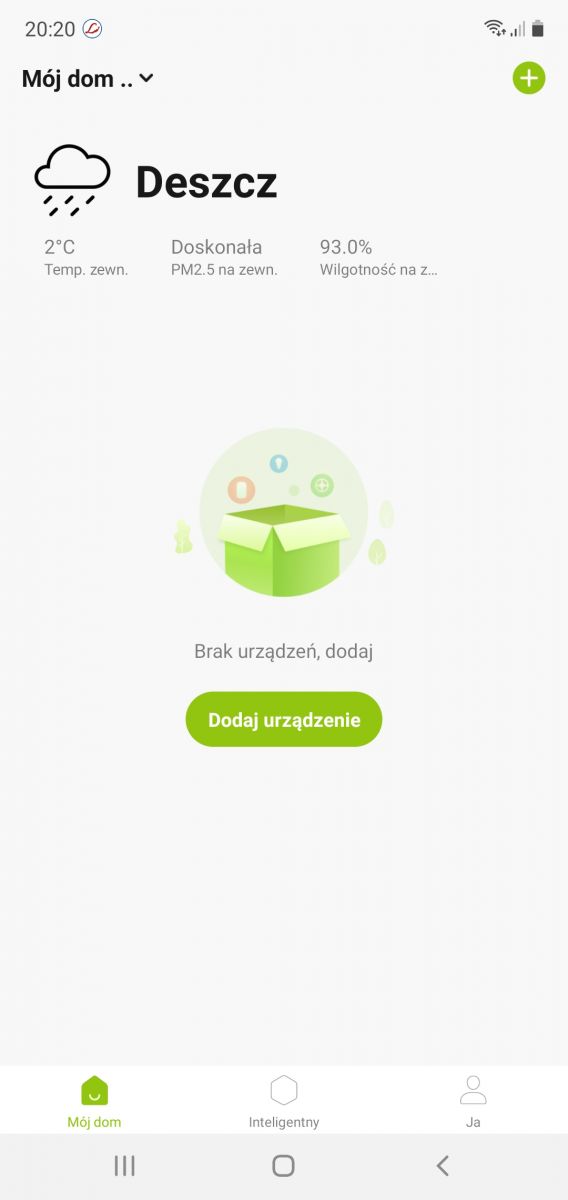

    Gosund SP111 socket bought about 2 weeks ago. During this time it has already managed to disassemble itself twice.
    I don't know what could be the reason, I have a fairly modern electrical system and it was plugged into my laptop at the time.
    I have dug through the net and this forum and have not found anyone else having this problem ;-(
    Gosund SP111 socket disconnects spontaneously - user experiences Gosund SP111 socket disconnects spontaneously - user experiences .
