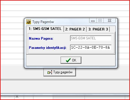

    Hello, I wanted something new and now I have it. I can't force the Integral 32 to send SMS via GSM-x. Is the configuration in dloadx correct?

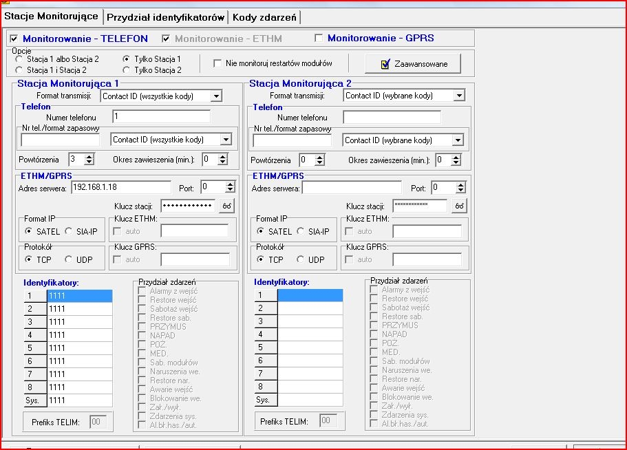

    If it is GSM-X (not GPRS-A), reporting only is not configured for reporting. So this is wrong.
    The control panel and module should be configured in the same way as the LT-1, LT-2, GSM-4, GSM-5 modules used to be.
    Although such a configuration is also acceptable, the only functionality is lost (no audio when converting monitoring codes). Therefore, it is better to make classic messaging by "Pager station number".
    Added after 8 [minutes]:

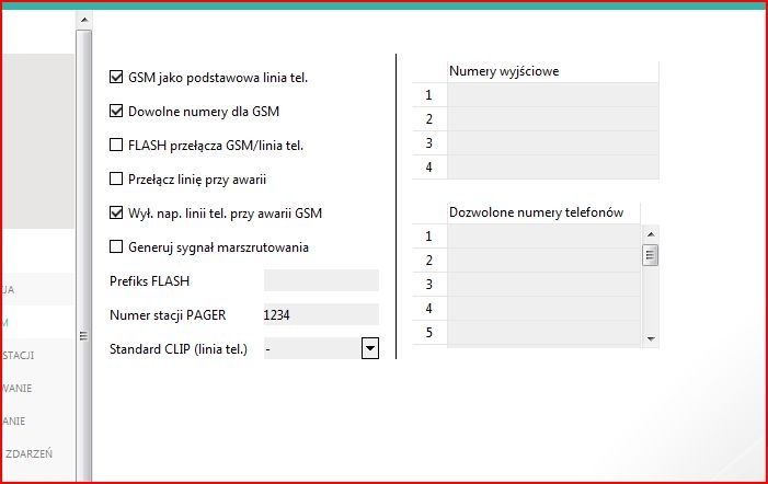

    Second thing, if you stick to this form of notification, what is the configuration on the GX Soft side? Because you should act consistently, i.e .:
    - or monitoring is performed on the control panel side and the conversion of monitoring events is performed on the module side (similar to GPRS-T1 configuration in the past)
    - or notification is performed on the control panel side and only the pager station number is performed on the module side (similarly to the GSM series, not GPRS-Tx)

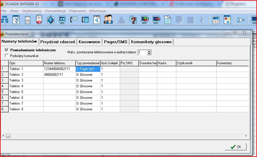

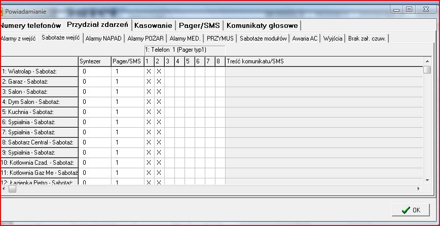

    Went to the notification page but still no effect

    The exchange dials the number? Can you see it on a diode or on line listening? (PIN5 connector from the synthesizer).
    Card (not) play?
    It is worth removing "48" from the phone number, that is the SMS pager + phone number. In the latest manufactured modules of the GSM (LT ...) series, inserting 48 often made the module refuse to digest it.
  • #5 17299478
    simrider
    nothing is visible on the LED, it flashes once every few seconds
    virgin card
    removing the nue number helped

    When messaging is performed by the control panel, the LED on the control panel should go on for a few seconds. If it does not, it may be a sign that the PBX is not even trying to transmit. And the module here may have nothing to do with it.
