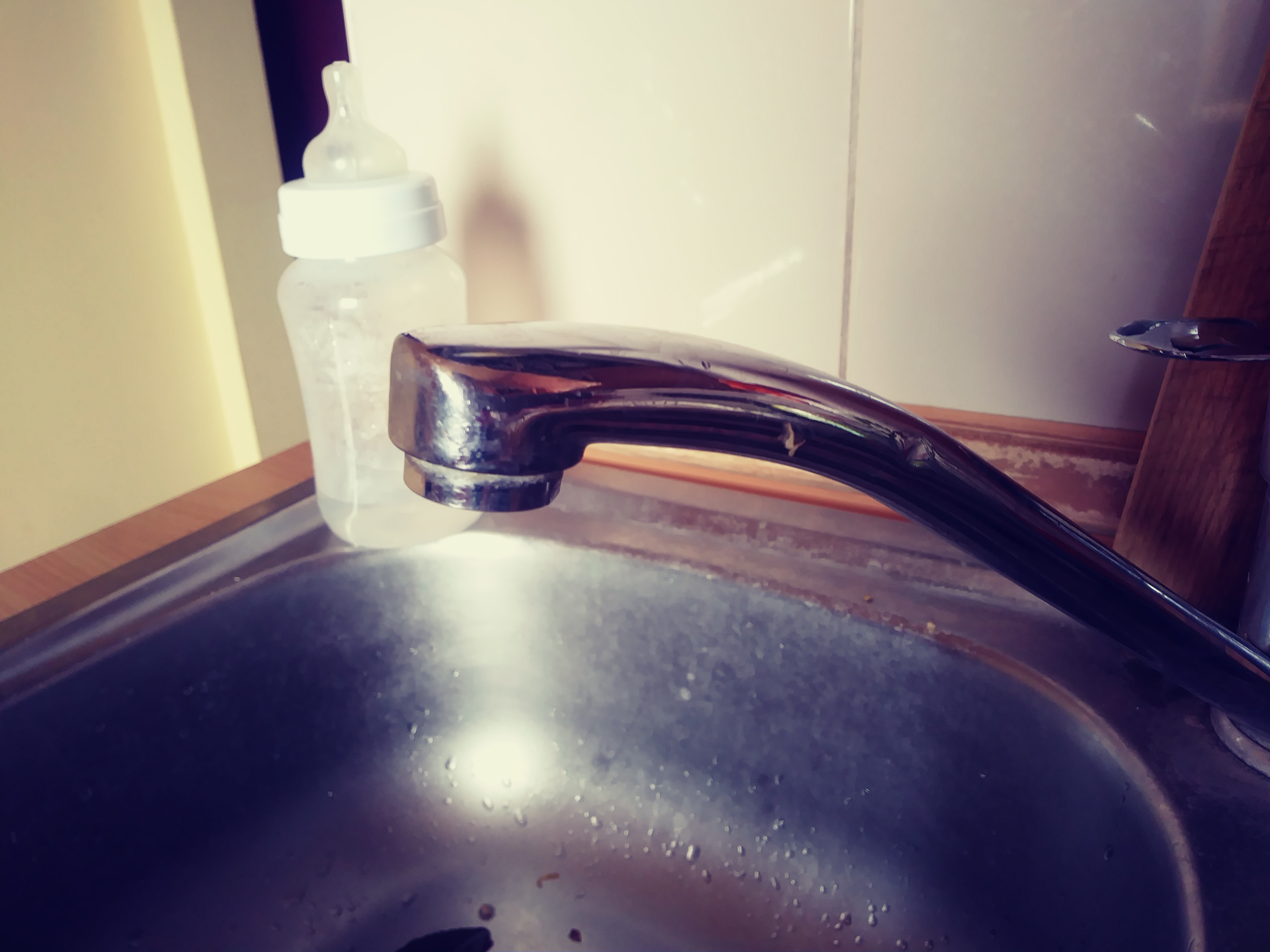

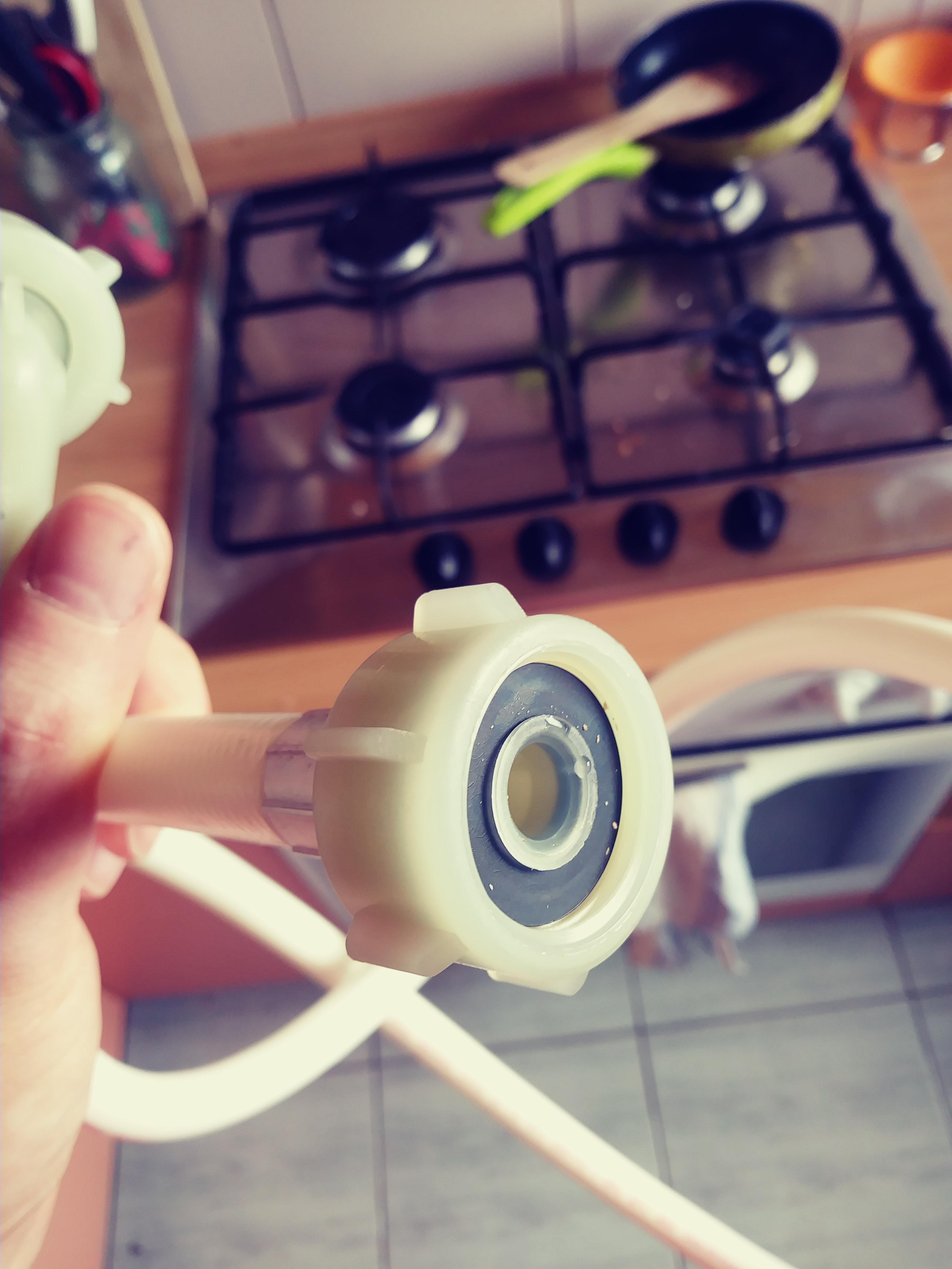

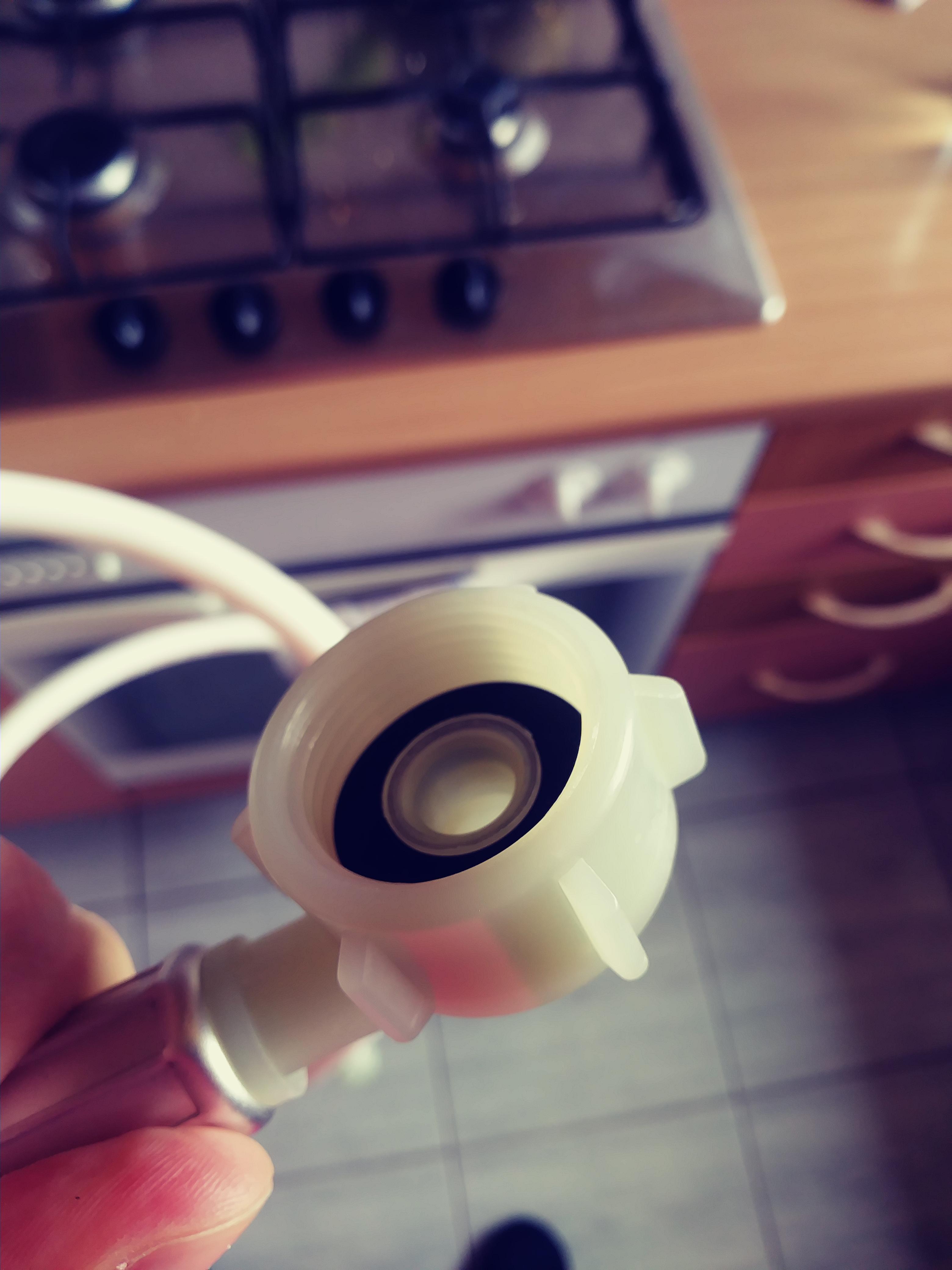

    Good morning,
    I would like to connect the dishwasher hose under the tap. I saw such a possibility in foreign video, unfortunately in Polish sources there is no such instruction or diagram. Or maybe some of you have installed a tap adapter through some adapter? I will be grateful for your help. Attached is a type of tap, hose and adapter found abroad.

    Thank you for the quick answers, in castorama I heard that I have no chance to connect to the tap. The idea of connecting underneath is very good, but I still wonder if you can still connect directly under the tap.

    In the battery you would have to unscrew the nut that holds the strainer, but there is a fine thread and you would have to look for an adapter having such an external thread terminated with a 3/4 thread whole and unfortunately I don't know if it will be available somewhere.

    You cannot post links from a well-known auction site in the forum, so have a friend look for a reduction from the spout of the faucet on a 1/2 internal thread.
    After purchasing this, you still need to buy a nipple with external thread from 1/2 whole to 3/4 whole and you can connect the dishwasher hose under the battery.
    Unfortunately, this solution will prevent normal use of the battery, and maybe a better solution would be to use a tee under the sink, but it's your friend's choice.
