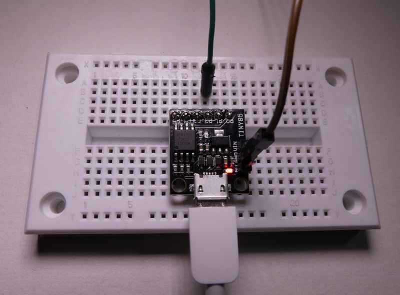

    DigiSpark is a miniature Arduino compatible module, based on the ATtiny85 microcontroller. The board is not equipped with a USB UART converter typical for Arduino. The USB lines have been connected with the pins of the microcontroller, while the USB support has been embedded in the firmware. The module is equipped with a 5V stabilizer and the PCB terminals work with this voltage. 8kB flash memory available (2kB occupied by bootloader). We have the following outputs:
    P0 (SDA, PWM, AREF)
    P1 (PWM, LED)
    P2 (D / A, SCK)
    P3 (D / A, USB +)
    P4 (D / A, PWM, USB-)
    P5 (D / A)

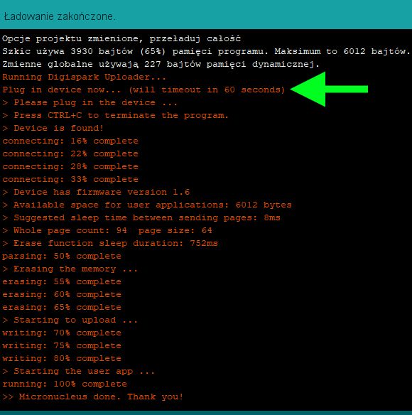

    Loading the program is different than with standard Arduino boards:
    -compile the program and start uploading
    -when appropriate information appears in the console, connect the Digispark board

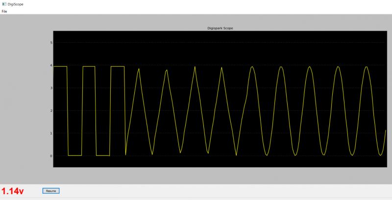

    Let's open the example of DigiSparkUSB-> DigiScope
    We compile the example and upload it to the board.
    The analog signal is given on P2 (input voltage range 0-4.75v).

    Using the tools https://github.com/digistump/DigisparkExamplePrograms (DigiUSB -> windows -> digiscope.exe) we can observe the analog signal given on pin P2. The 1Hz waveform is recorded below.

    I don't know about you, but I had problems with the digispark at the start. In most cases, the computer did not recognize the device. After replacing the diodes
    zener at 3.3v the problem is gone.

    For me, it often does not recognize this plate. Sometimes it takes a lot of patience to upload the program.

    @RigelInOrion @ noel200 i.e. simplification of the structure has a negative effect on its stability,
    my module worked stably, only the programming procedure is non-intuitive (first load the program, then connect the module).

    The bootloader, which is responsible for loading the program, starts only for a moment emulating the "Digispark something" device and if nothing is sent to it, it starts the program. Hence, it is constantly plugging the board into the port. I only used the bootloader for testing. I programmed the end device with the USBASP programmer so that it was just a running program. You don't need to install drivers for it and it can run without them on any computer (it emulates the keyboard in my project)

How do I read an analog signal on P2?
Load the Arduino example File → Examples → DigisparkUSB → DigiScope. Feed 0–4.75 V into P2; view live data with digiscope.exe from the DigisparkExamplePrograms repo [Elektroda, TechEkspert, post #17330915]

How can I flash firmware without the bootloader?
Use a standard 6-pin ISP header: connect MOSI, MISO, SCK, RESET, VCC, GND to a USBasp or AVR-ISP MKII. This frees the 2 kB bootloader space, giving the full 8 kB and removes the 5-second start delay [Elektroda, RigelInOrion, post #17332863]
