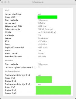

    Hello everyone
    Last month I changed the package in UPC from 150 mb / s to 500 mb / s which was associated with the replacement of the old modem / HORIZON router (it worked without any problems but it was necessary due to the lack of support for such speeds) to the Connect Box modem / router and from that time problems started. Everything connected by cable to this modem works great, no problems, never lost internet. On the other hand, devices that are connected via Wi-Fi is a completely different matter, several times a day (from what I can catch) there is a loss / loss of access to the Internet, sometimes it concerns one device and sometimes all at the same time (while the equipment that is connected with a cable at these moments there are no problems), information about the loss of wi-fi does not pop up, all range lines are maximum but no page is loading / the movie stops playing etc., it usually takes a few seconds but sometimes it happens up that a dozen. I already had 2 visits from UPC technicians, the first one was checking something on the antenna cable that goes to the modem, he put a device on and told me that everything was fine with the incoming signal, he decided that the problem could be the connection between the two cables (one was too short), so he replaced them and said it would be okay. It didn't help, so I had another visit, where I had my modem replaced with another Connect Box, it also didn't help. I do not have any deeper knowledge about electronics, only what I can read on the internet, I have run out of ideas for a possible cause, so I am asking for help because I do not know what to do too much. Thanks in advance for any answers, best regards.

    What is the distance between connectbox and devices?
    How many networks do you have in the air (wifi analyzer on the phone)
    The distance does not matter, it even happens on the phone at a distance of 1 meter from the modem, as far as the number of networks is concerned, it is ~ 5.
    Added after 48 [seconds]:
    _cheetah_ wrote:
    This looks like an obvious wifi problem in your apartment.
    First, do a full wifi diagnosis in the apartment, there you have more -> https://www.elektroda.pl/rtvforum/topic3158772.html
    Preferably InSSIDer (Windows) or WifiAnalyser (Android).
    First measurement at the router itself.
    Subsequent measurements in typical places where mobiles are used. For paws and PCs, it's best to take measurements from them.
    And post screenshots of the spectrum view of the bands (2.4GHz and 5GHz / 6GHz) such as these:
    https://obrazki.elektroda.pl/1297969600_1611503895.png
    https://obrazki.elektroda.pl/9695492800_1454695020.png
    Additional questions:
    1. Do you have the same or different network names for 2.4 and 5GHz?
    2. Disconnection applies to both bands (2.4GHz and 5GHz) or only one?
    3. Have you tried the test with an open (no encryption) wifi network?
    Thanks for the answer, I will be able to do such tests only late in the evening, then I will try to answer

    @MateuszMikoaj
    Connect Box, may have so-called Smart WiFi active, turn it off.
    Additionally, make sure what name and encryption key the 2.4 GHz and 5 GHz network have - the names and encryption key for each of these networks should be different.

    KOCUREK1970 wrote:
    @MateuszMikoaj
    I turned off Smart Wi-Fi, changed the name for the 5GHz network and set channel 36, if the encryption key is the wifi password, they are the same (WPA2-PSK security), I do not use the 2.4 GHz network, I did it a few days ago and it it did not work (currently I have 2.4ghz turned on, but even when it was turned off, it did not affect the problem)
    Thank you for your response

    1. They have different names
    2. I do not know that, I used the 2.4 GHz band only for a few minutes because the maximum speed I can achieve on it is ~ 100mb / s. On the previous HORIZON modem, I also used only 5GHz.
    3. Open network test is without wifi password? If so then no. Is it safe?
    I paste photos
    "Disconnecting Wi-Fi" on the Connect Box (UPC) modem
    It is right next to the modem (performed on a Windows laptop)
    It's in the same room at ~ 4 meters (Made on a Windows Laptop)
    It's in the room where the iMac is, the room behind the wall (made on a Windows laptop)
    "Disconnecting Wi-Fi" on the Connect Box (UPC) modem "Disconnecting Wi-Fi" on the Connect Box (UPC) modem "Disconnecting Wi-Fi" on the Connect Box (UPC) modem
    It is performed from the phone in the same locations as on the windows laptop
    These are tests made on the iMac (room by wall)
    Laptop windows directly and in a room behind the wall
    White is the iMac (behind the wall), dark is the MacBook (here was the measurement directly at the modem)
    It was performed on a windows laptop
    I am waiting for a response :)

    _cheetah_ wrote:
    Your network has a channel width of 80MHz, which means de facto you occupy channels 34 ... 50, so the rest of the networks overlap with your channels. But, in most cases they are much lower with the levels and as you can see they do not interfere with speeds very much, but they can affect the stability of the network. Nevertheless, it seems to me not to be the problem.
    I would be more of a problem with one of the clients, "teaching" the network for some reasons known only to me. Maybe it's a question of encryption, maybe speed, or maybe it has some problem with communicating with CB at such high speeds (high client load due to encryption of wifi transmission).
    I would start by reducing the speed - it switched to either w 'n' or w stuck to 'ac', but I would reduce the channel width to 40MHz to limit the speeds. And he observed whether the problem was still in an unchanging form.
    Then I would change the encryption or make the network open at all, although the latter on the block is a bit risky.
    Alternatively, you can only leave one client on the current CB settings and see what happens.
    Thank you for your response. What do you mean "I would change the encryption"? Is it the password for Wi-Fi or WPA2-PSK? I have one more question, do you think buying a router (of course some good one) and connecting it to the modem could solve the problem?

    @MateuszMikoaj
    The only way to check what the internet is crashing at this stage is to turn off all WiFi devices and connect them one by one. The one you plug in recently and blow up the entire Internet is the culprit.
    There you mentioned something that you also have an imac, several times I came across the opinion that phones iPhones with UPC modem routers were also biting. In connect boxing, the WiFi system is quite picky Mediatek Celeno.

    KOCUREK1970 wrote:
    @MateuszMikoaj
    There you mentioned something that you also have an iMac, several times I came across the opinion that iPhones with UPC modem routers were also biting. In connect boxing, the WiFi system is quite picky Mediatek Celeno.
    Thanks for the answer, it will not be easy to check it, but I thank you and others for your help, you brought me closer to the topic and showed more interest than UPC :)

    Changing the channel width and Wi-Fi mode did not bring positive results.
