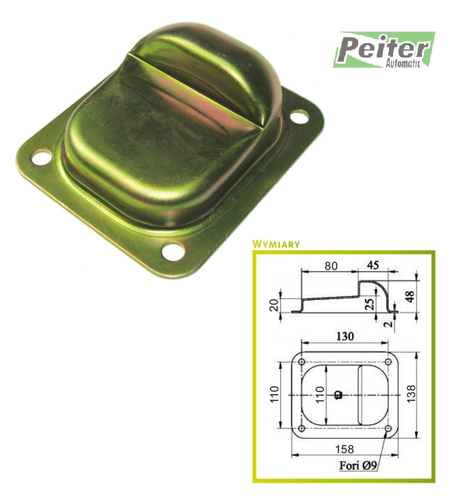

    Yes, I considered a longer gate, unfortunately it is not feasible due to the narrow backyard. Gate + counterweight would not fit on the property. As for stabilization, when closing, I intend to use a bumper of this type:
    Sliding gate + Wicket without a separating post. Selection of elements.
    I intend to additionally attach a piece of a flat bar near the gate, which will be slightly bent to stabilize the gate. I do not know exactly how to bite the synchronization, I think it will be irrelevant when opening, and when closing the wicket first, then the gate slides between the stop and the flat bar next to the gate.

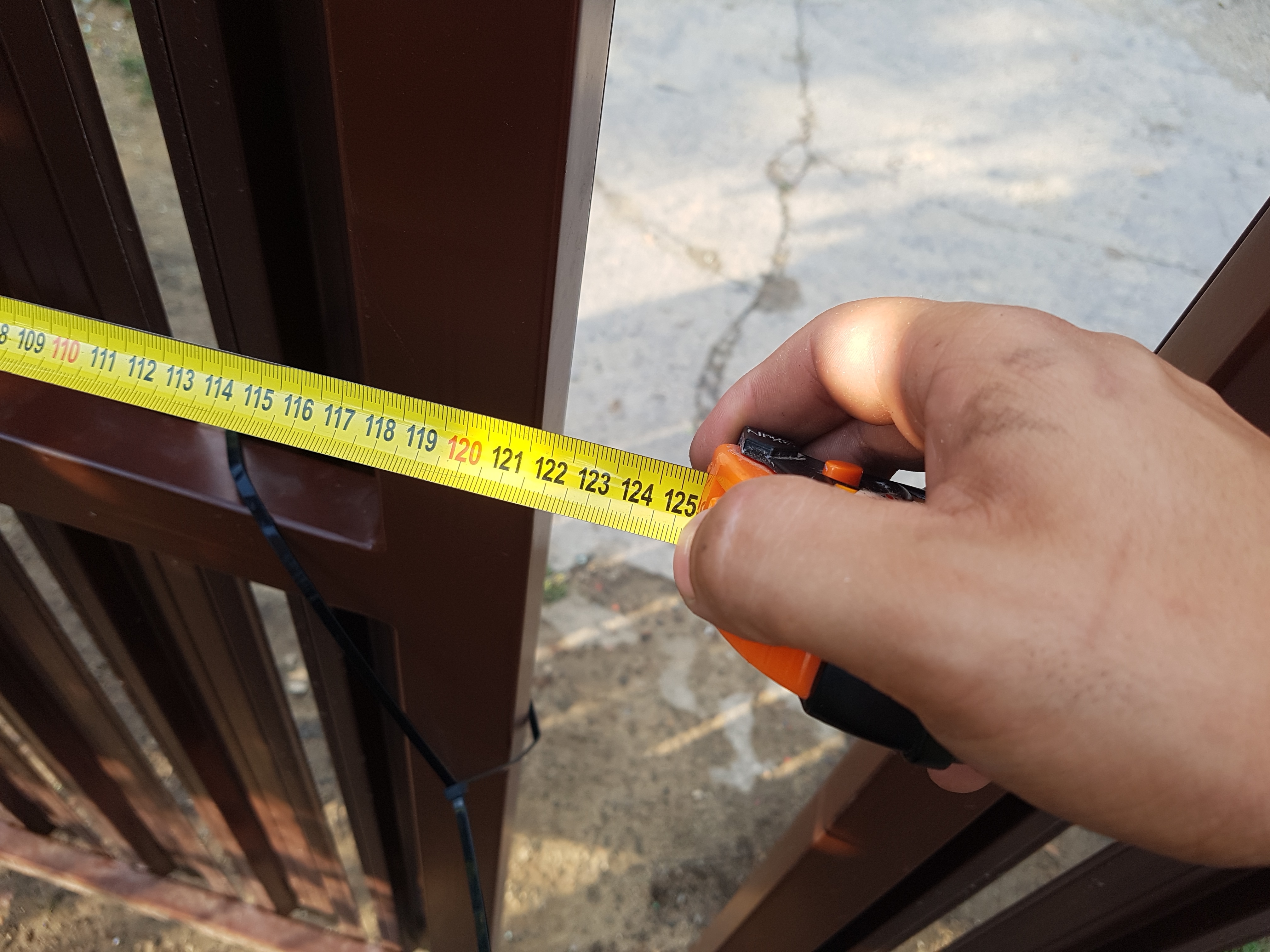

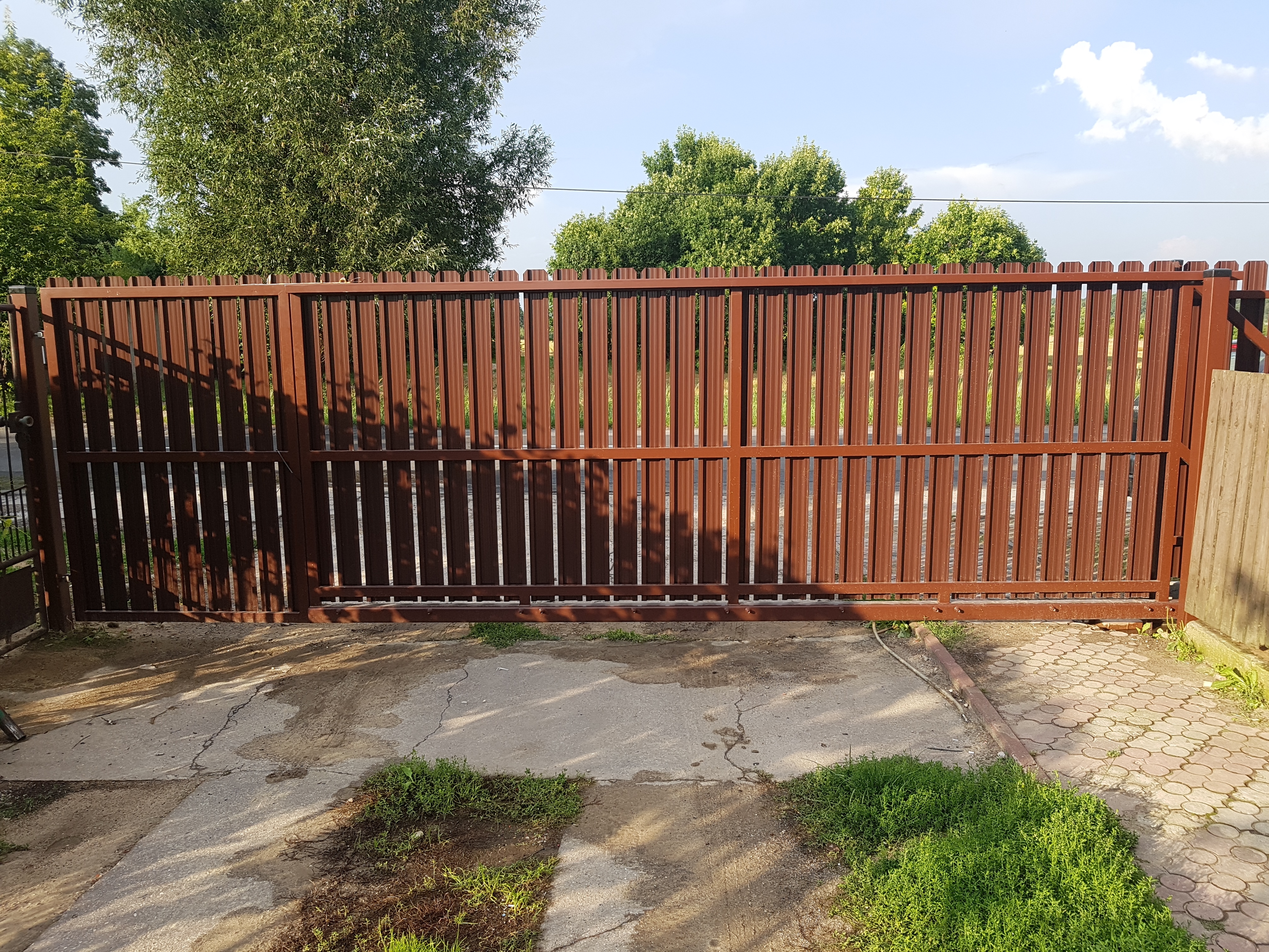

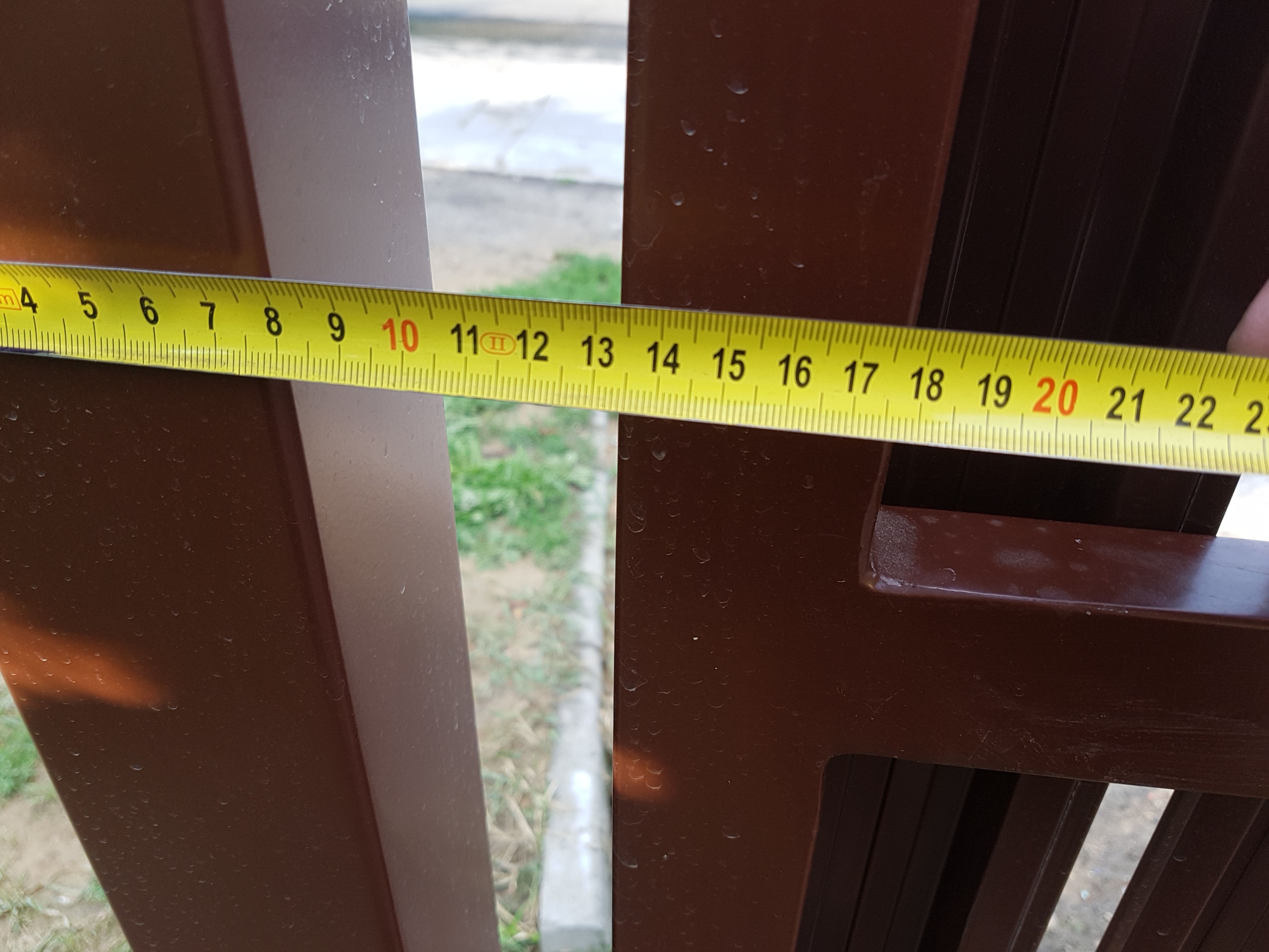

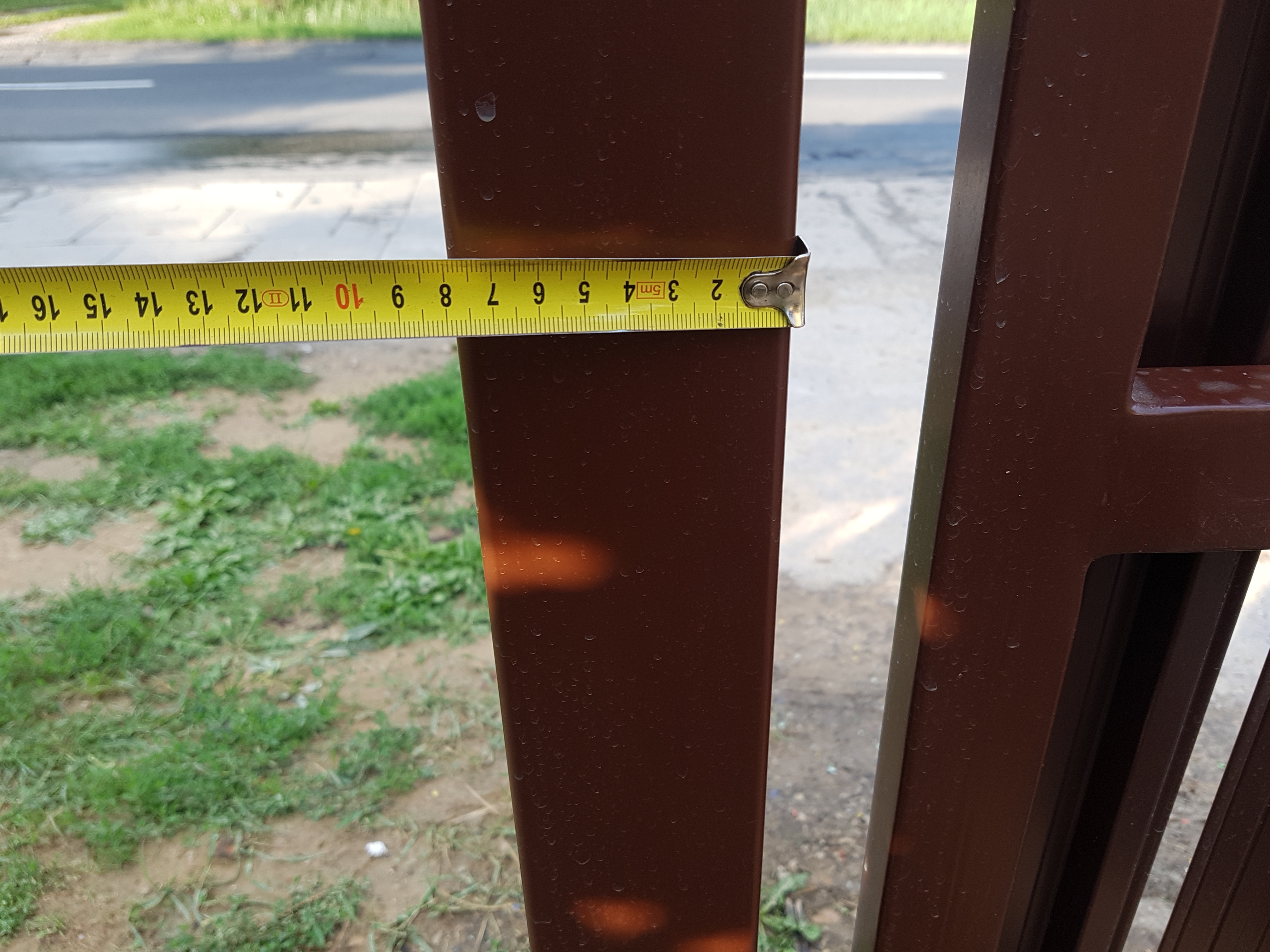

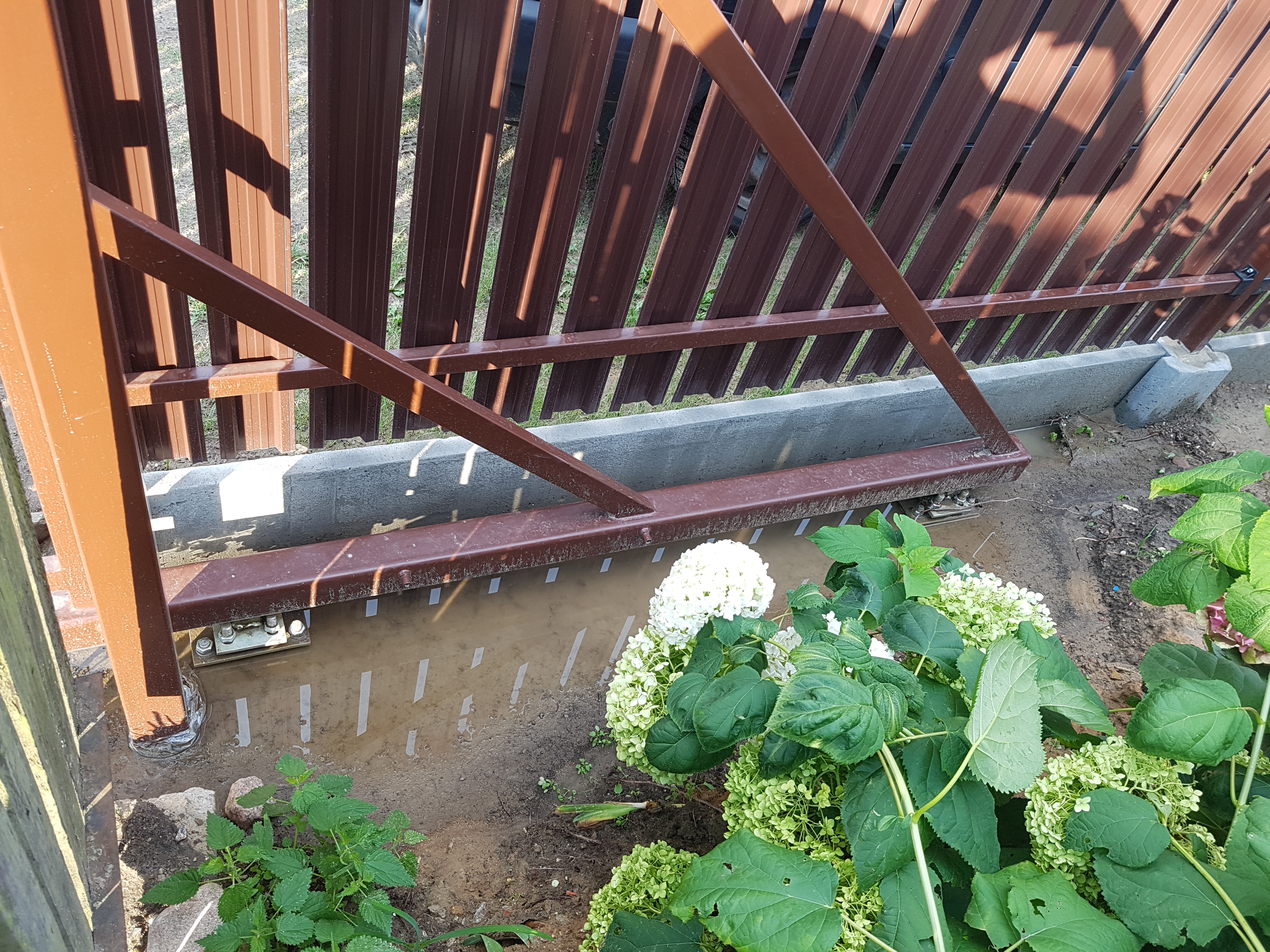

    In fact, it will be easier to advise you if you see what we're talking about.
    Sliding gate + Wicket without a separating post. Selection of elements. Sliding gate + Wicket without a separating post. Selection of elements. Sliding gate + Wicket without a separating post. Selection of elements. Sliding gate + Wicket without a separating post. Selection of elements. Sliding gate + Wicket without a separating post. Selection of elements.
    There will be paving stones in the yard, which is why the gate and the gate are raised by the same level.
    I think that the sliding gate will be on faac 740/741 (is it reasonable to throw in the actuator with such a reserve?), And on the gate I was thinking about faac 414, but then there will be a problem with emergency power supply, so I think about FAAC S418 and a battery for emergency opening in the event of a power failure to be able to get to the property in the event of a power failure. I am still looking for confirmation of the information whether I can use one pair of photocells up to 2 drivers, but so far I see no contraindications.

    In strong winds you can see how the gate moves slightly, but there were no problems such as cracks, bends, etc. The limit switches are set so that after closing the gap is the same as on the rails, so even at first glance you cannot see that there is a separate gate. Finally, I used the Nice set, additionally a wireless keyboard on the post and emergency power supply connected to the sliding gate drive.
