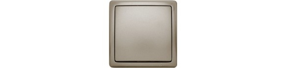

  • #14 17393909
    zibi900
    Choosing Shuko Sockets & Switches with Accessories for Single-Family Home in PL
    photo from the website
    https://garówka.elmar.pl/340-simon-basic-modul
    awow wrote:
    xury wrote:
    I hate Simon because of the very poor clamps and the inconvenience of assembly.
    I assemble quite a lot of Simon Basic and Simon 54, I think the quality of the screw terminals is at least good.
    I myself have this socket Simon Basic Module as shown in the picture and I think that it is very good quality and there was no problem with assembly.
