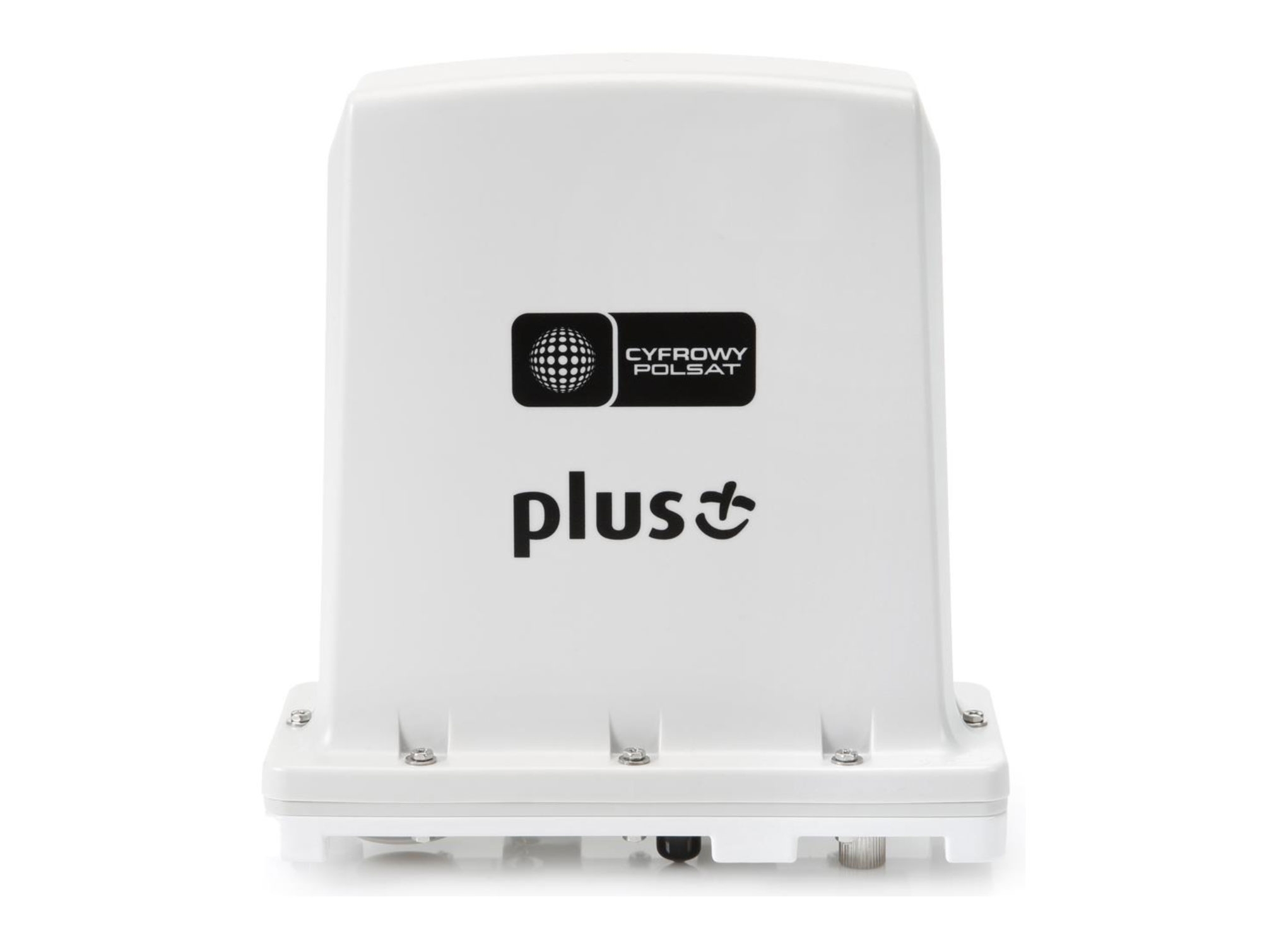

    PitbullPel wrote:
    What does the external antenna for Cyfrowy Polsat internet look like, I know Plus, and the one referred to as neither plus nor CP has
    I have completely different feelings, on the photo that the author gave almost nothing to see, but isn't it similar to this?
    Impact of Nearby GSM Repeater on LTE Coverage: Exploring RSSI, RSRQ, and SINR Parameters
  • #7 17353853
    PitbullPel
    Posts: 98
    Rate: 17
    Shape like the most ... So look for reasons elsewhere. I understand and thank you for the suggestion. I will also ask my operator to clarify the issue of poor signal quality and such a level of interference, the more that I have a business contract with him for several numbers. We'll see what comes up.
