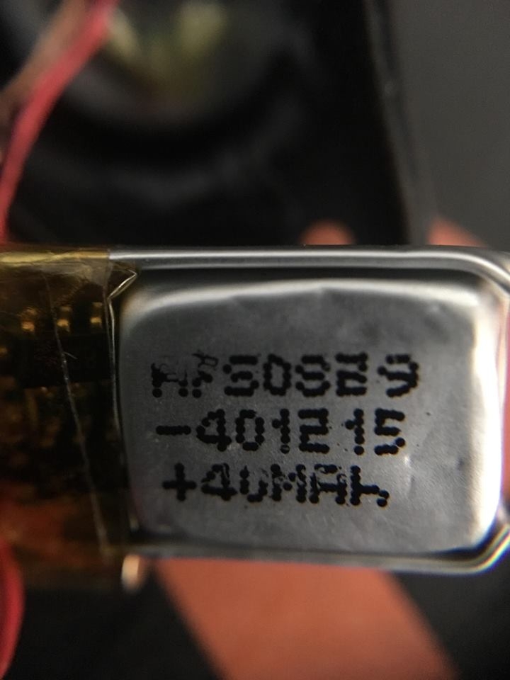

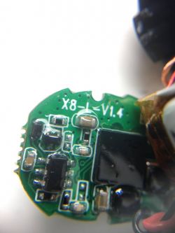

  • #6 17364766
    Murdoc123
    Posts: 40
    managed to open the receiver. Charging Rock Space Model EB30 Bluetooth Headphones without Original Box Charging Rock Space Model EB30 Bluetooth Headphones without Original Box
  • #7 17367050
    wieswas
    Posts: 2563
    Help: 240
    Rate: 400
    As you can see in the photo, there is a 40mAh battery
    On the Batimex.pl website I found batteries for wireless headphones with similar dimensions. They have a voltage of 2.4V or 3.7V.
