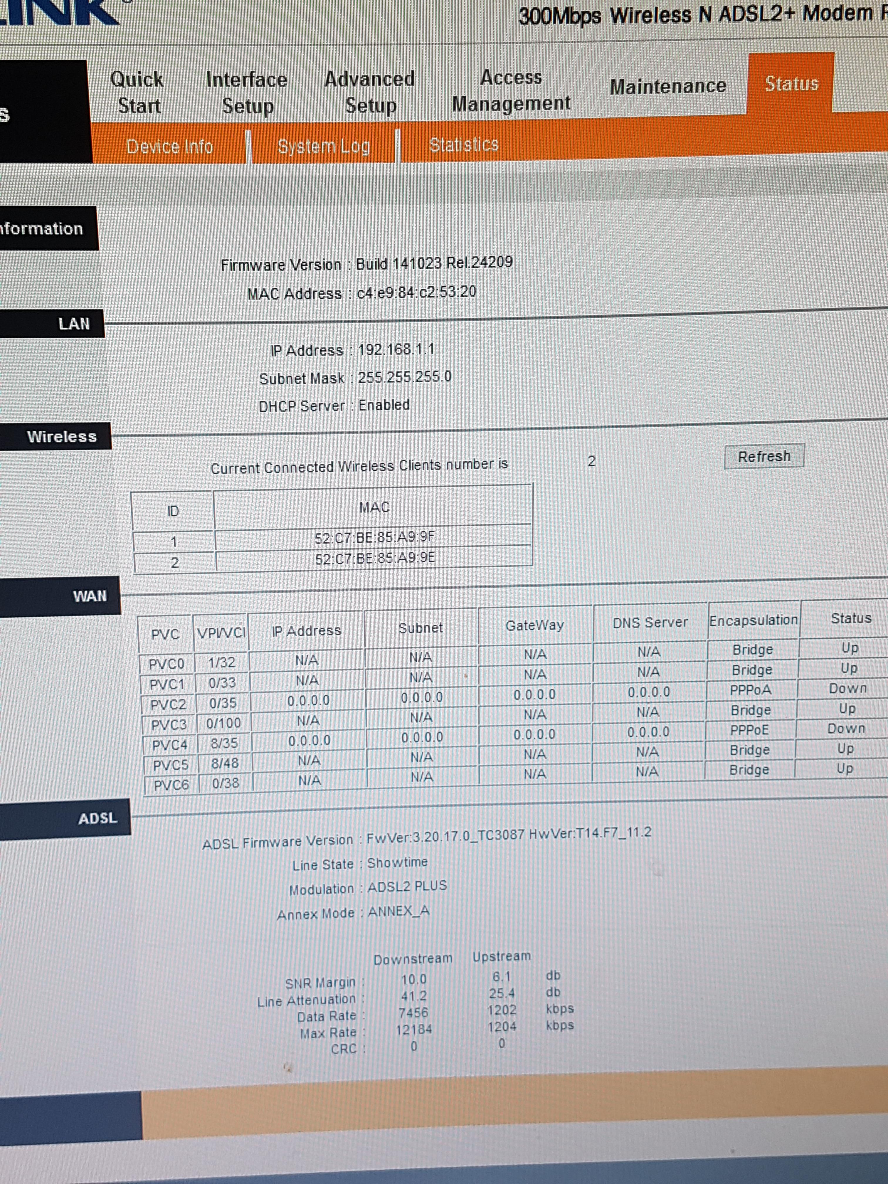

    Suddenly the Internet stopped working and the message pops up saying no connection to the dns server.
    : edit: Wifi also doesn't work.
    The problem started in the morning but I did not have it. Then time to analyze it until now nothing has changed the hotline of the supplier is of course silent so I do not know whether they are doing something or not.
    In the router settings it looks like the photo attached, unfortunately the fact that I had instructions for checking it does not change the fact that I have no idea how to read this is it a problem that the equipment or rather the fault of the Internet provider?
    Thank you in advance and best regards.

    Your router is not connected to the "Internet". Restart the router, check the telephone cables and filters. There was no storm by accident?

    #6 17361602
    myszkoscielna
    Posts: 473
    Help: 62
    Rate: 31
    The router obtains ADSL synchronization but does not connect to the IP network (no IP address from PPP communication),
    please report the problem to the operator's technical support.

    Actually. I didn't notice the bottom of the picture. Only the operator remains.
