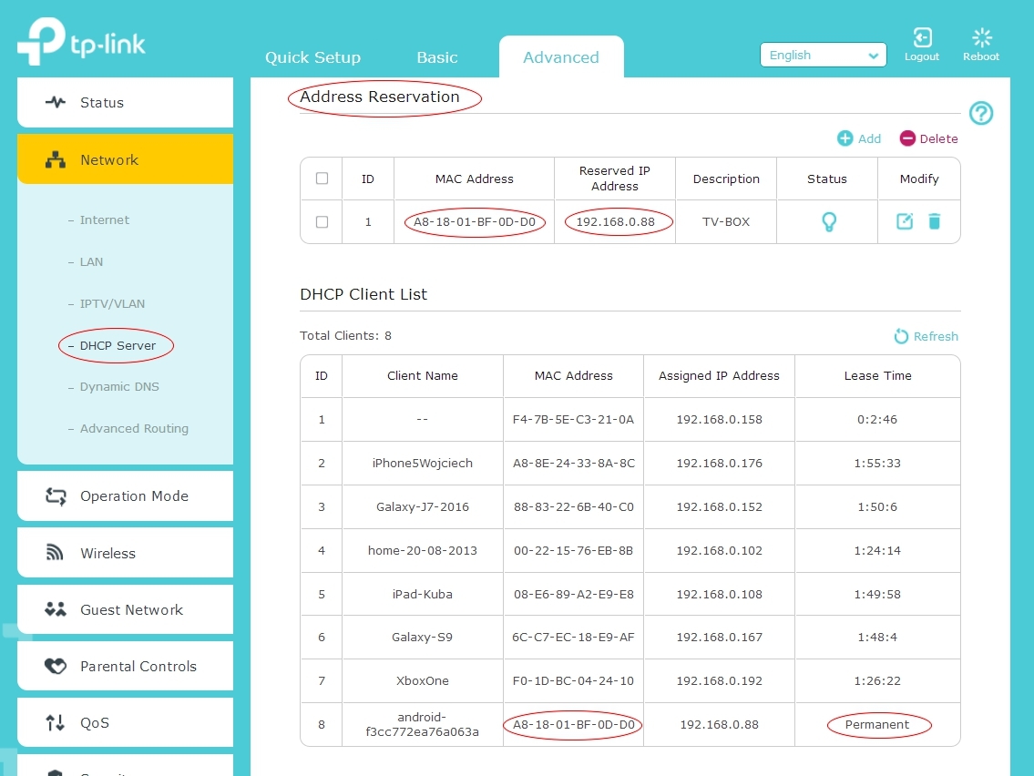

    I have such a problem with my MXQ PRO 4K as we know. The WiFi in it works hopelessly, so I connected everything after the cable, it connects at full speed, but when the exclusive box does not detect the internet after switching it on again, I have to pull the plug from the internet cable and reconnect.
    I will add that I have a net from Vectra and a variable IP and I noticed on the device if I'm not mistaken in the settings is fixed IP but I can not do anything with this setting. I would be grateful for help because I am annoyed by pulling and using the cable from the Internet every day

    I had it too. I found somewhere on the net that you should permanently reserve the address in the router and preferably still outside the router's DHCP pool.
    I set it as in the screenshot and for now there is no problem with no LAN connection.
    You can see in the attached picture that the router has assigned the TV-BOX address permanently.
    DHCP mode set on the TV-BOX.
